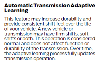

From page 154 of the owners manual:

it's not learning you. it's not learning me. Its not learning a driving style. Thats the point that so many people are getting wrong.
The people irked by this are the ones who think this is some smart phone based transmission or something. Its nothing special or crazy unique, you can't ask alexa to change your shift patterns. It does it's thing quietly with the electrons and neutrons pulsing thru the computer.
Yes its adaptive, that is not up for debate, but it's not changing because I drive it, or my kids drive it. its changing parameters for it's needs based on the quote I posted.

My understanding of the "adaptive" part that it had nothing to do with driving style. It was adapting to the specific transmission. It is monitoring shifting pressures and making adjustments based on the machining of that specific transmission - each transmission is manufactured slightly differently (manufacturing tolerances) and this adaptive piece was to dial in each transmission to its specific tolerances, etc.
