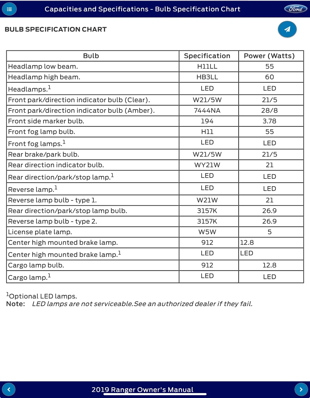

Here’s the chart from the Owner’s Manual (pages 324-5 in the PDF version) - it does not designate bulbs by trim level.
Standard Equipment:
Lariat - LED headlights (Hi & Lo), LED fog lights, and LED taillights*
XLT - halogen headlights (Hi & Lo), halogen fog lights, and LED taillights
XL - halogen headlights (Hi & Lo) and halogen taillights**
*Supply chain problems caused some MY Lariats to have XLT headlights
**Halogen fog lights were available as part of appearance packages for the XL (STX, Chrome, Special Edition)
Standard Equipment:
Lariat - LED headlights (Hi & Lo), halogen fog lights, and halogen taillights*
Correction:
Lariat = LED - Headlights, Fogs & Taillights.

Thanks A/T - cut and paste victim. 🤦‍♂️
Edited in original.

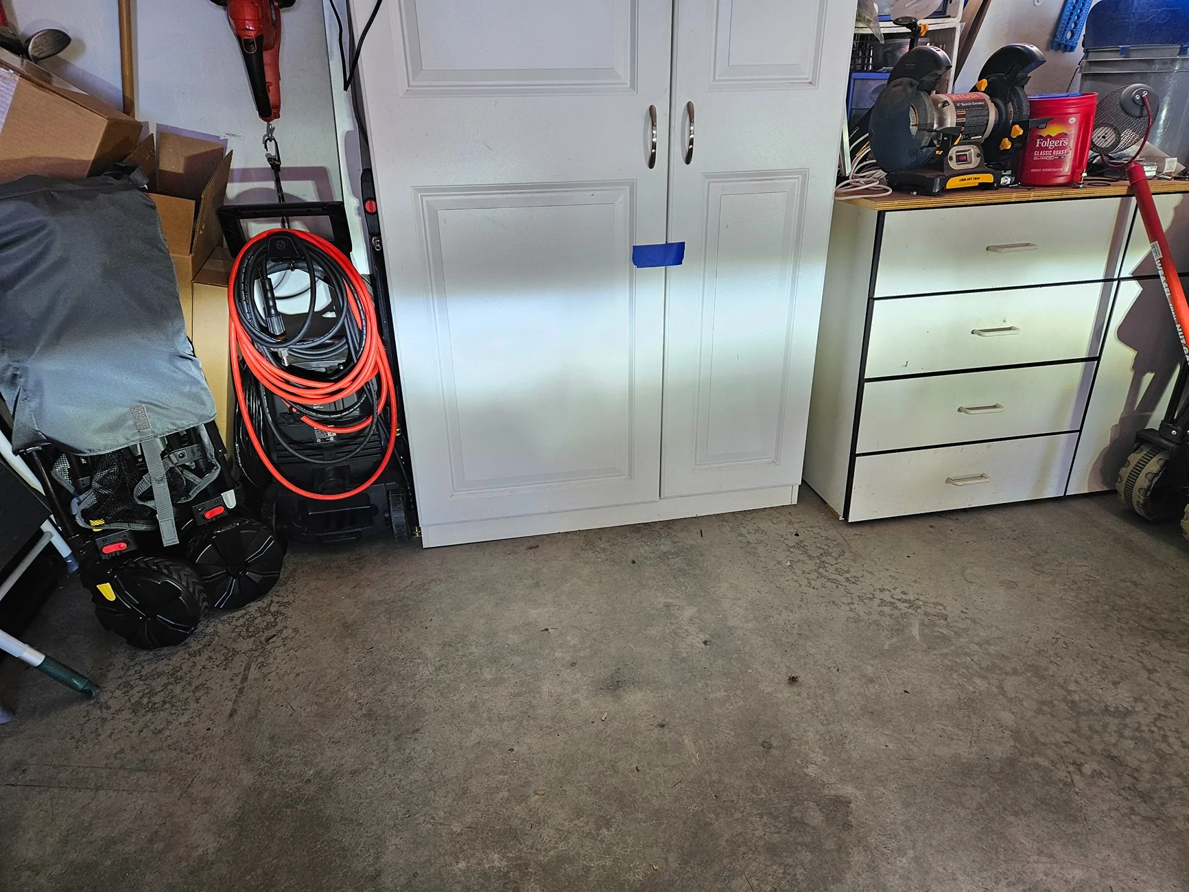

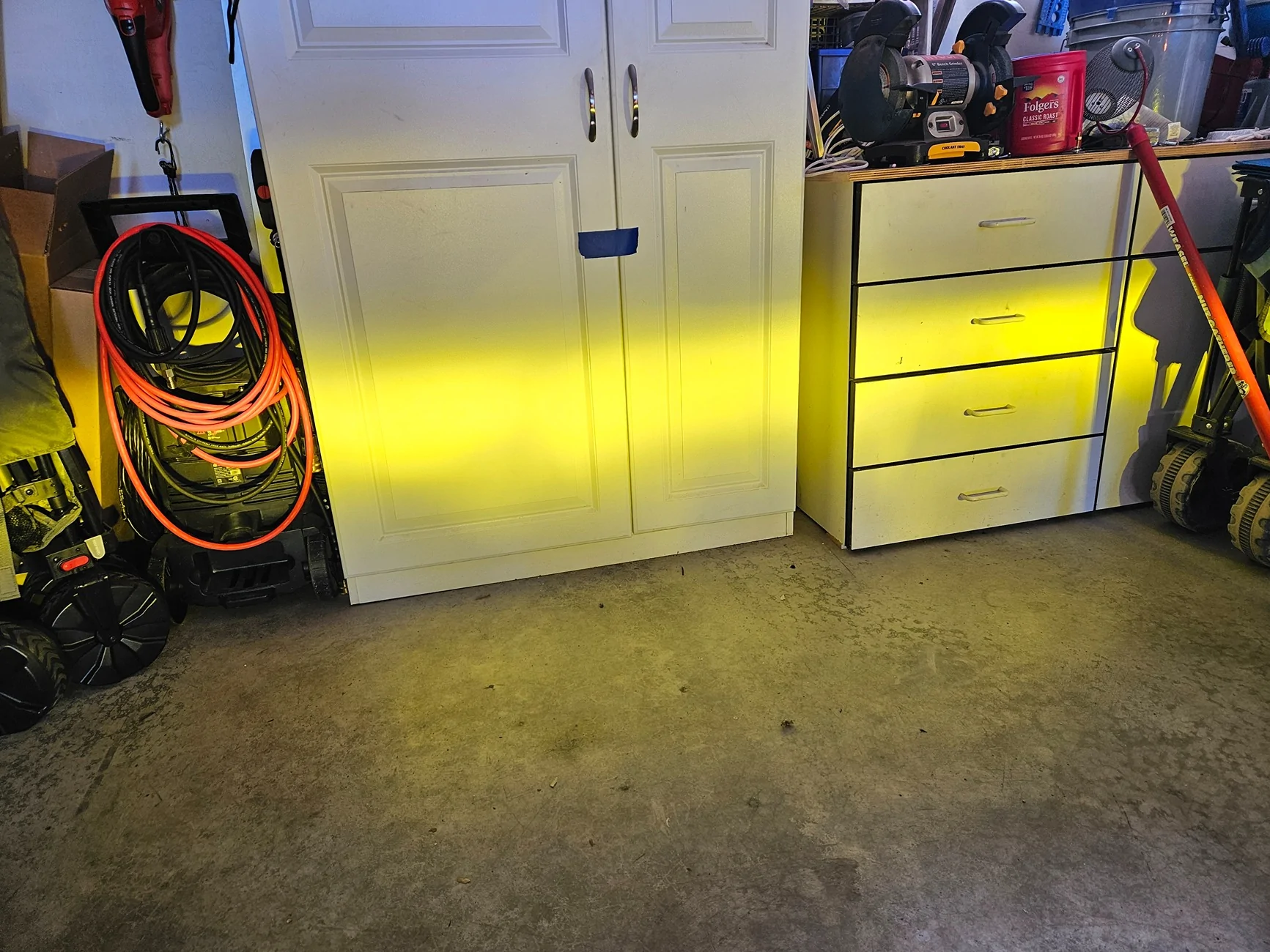

Good thing I got my LED's before I joined this forum. :) My Auxito's have been great. Nice clean cut off, just adjust them properly. I did switch to Lasfit for my fog lights. They default to white but turning them off and on switches them to amber. Again, nice clean cut off. https://www.lasfit.com/products/ld-series-h8-h11-h16-led-fog-light-bulb
