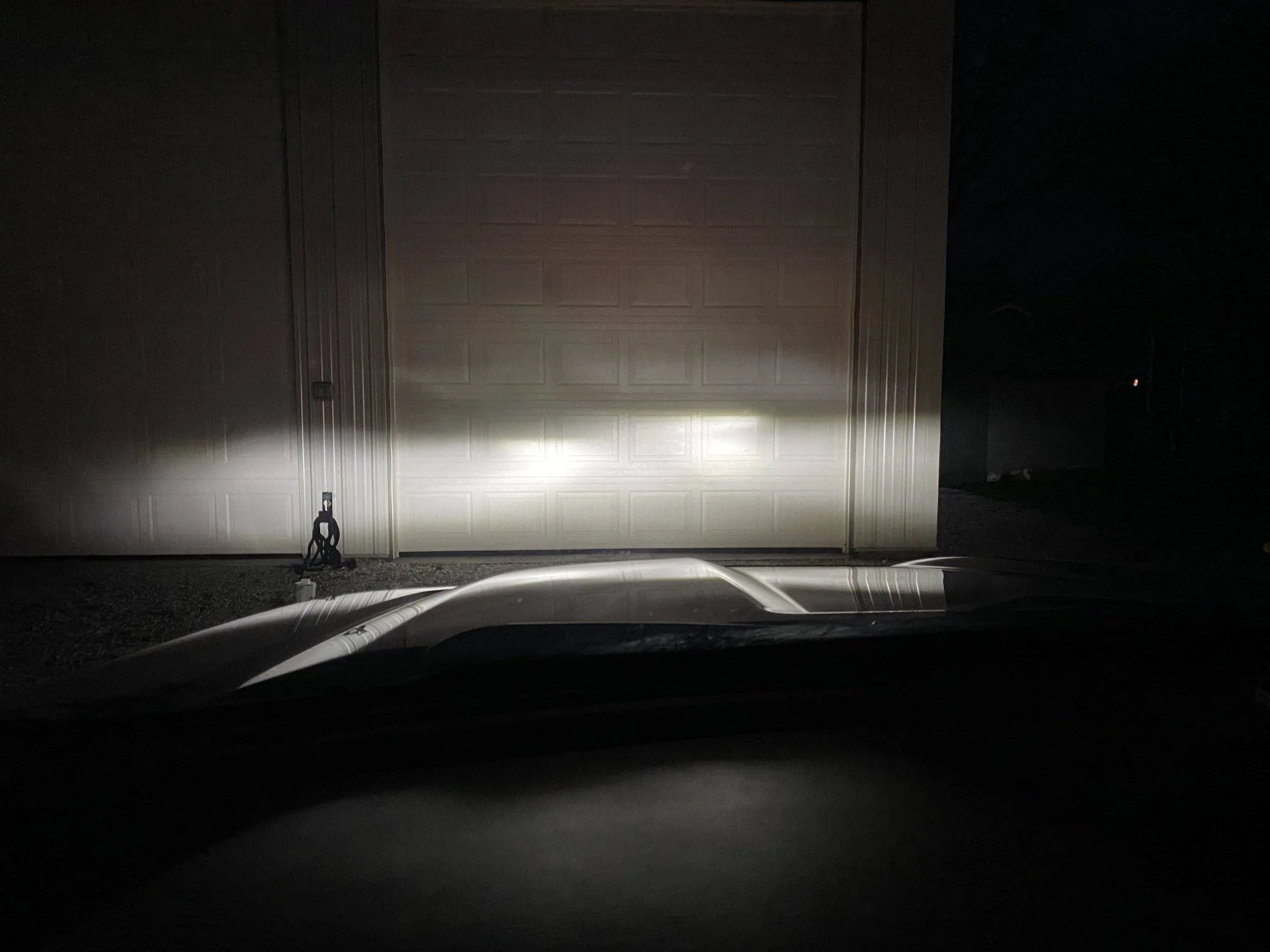

There's a huge thread on this on here. Many said they aren't designed to work in the halogen housings (which is true) an they won't work right. I put off doing it because of this.
I finally bought a set an popped them in. I raised the front of my truck with a level kit an lowed the aim an still got flashed occasionally with the halogens. I lowered them a little more, like 8 turns for the leds.
It's been a month or more with the LEDs an I haven't been flashed once. I got flashed with halogens so who knows. I did go with a set of 30 watt each bulbs not the 40 I see most bulbs are. I think this might help not overwhelm the the light pattern. I don't know but I know what's working for me. The beam is nice an focused on my garage door. My thought was they were cheap enough if I got flashed I'd toss them.

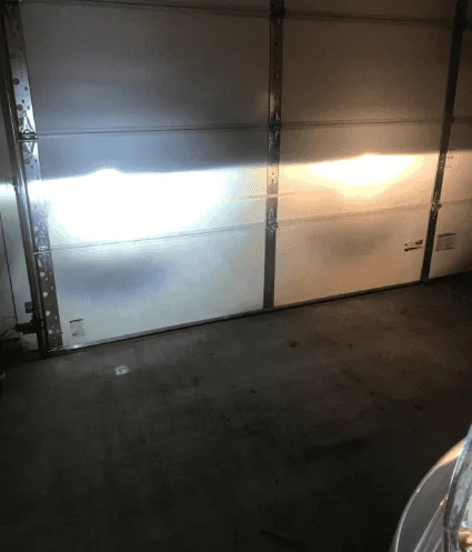

I went with GTR Ultra 2's @ 6500K as seen here:
This is the same “hybrid” setup that I have. Halogens in the lows and LEDs in my highs. Now to be fair I did swap out the oem halogens for the PIAA xTreme white halogens. They are marginally brighter than stock and won’t melt the faces of other drivers at night. I have the 16,000 lumen Auxitos in my highs…let me tell you, they are BRIGHT! They are wonderful to use on the dark country roads that I live on.
I did have LEDs in the low beams at one point, but I removed them for the sake of the other drivers on the road.

Took this tonight. Currently running these
