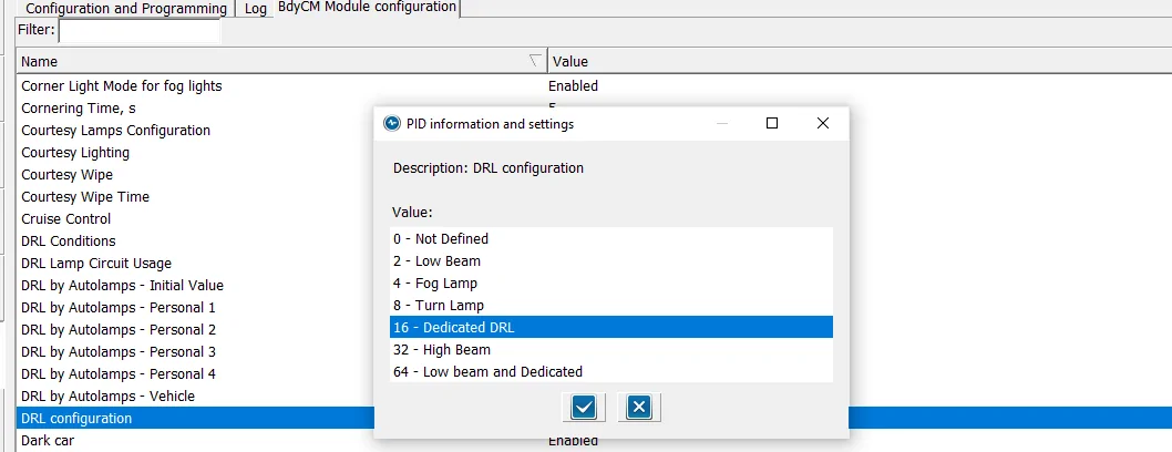

So, I used the 2 recommended GUI Settings at First and this is what I got
In BCM
Allowed DRL Options to (+ Dedicated DRL)
DRL Configuration to (Dedicated DRL)
DRL - Configuration - Changed To (Dedicated DRL) this automatically changes 2 of the Line Codes in the As-Built File Folder (BCM)
726-26-02 - 0000-0001-0056 (Matches my Lariat compare search-As-Built)
726-50-01 - 108E (Matches my Lariat compare search - As-Built)

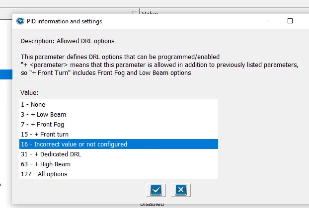

Now for Allowed DRL Options in GUI, this GUI only adjusts one As-Built File and that is 726-45-01
I had set it to (+Dedicated DRL) but I double checked the (As Built) file and its Hex-Code Read
726-45-01 - 0A01-1F00-009D
So, the Allowed DRL Options (+Dedicated DRL) setting within the GUI, does not change the As-Built File to the correct Hex-Code according to my 3 Lariat comparison trucks.
So, I played with all of the options in GUI, and this is the outcome of each, I will note the changes
on the second set of numbers:
None: 0100
All Options: 7F00
Low Beam: 0300
Hi-Beam: 3F00
Ft Fog: 0700
Ft Turn: 0F00
Dedicated DRL: 1F00
**Incorect Value or Not Configured - 1000 (see below)
Noted: None of These Options gave me my Original as Built (0200), might be due to that I had the other DRL Configuration set to (Dedicated DRL) IDK
If you change the As Built file manually to the (Lariat Compare -Code)
726-45-01 -to - 0A01-1000-008E then look in the GUI (Easy Way) it's listed in a current status of:
Incorrect Value or Not Configured
I may go back in ForScan and Play with the GUI (Options) for DRL Configuration, and see if I can get the GUI format to read correctly (1000) instead of the Incorrect Value or Not Configured
(It's a Curiosity Thing) and I tend to be thorough and meticulous. I'm new to ForScan and Learning
So, I checked Headlight / DRL Operation with both 726-45-01 (1FOO) & ((1000) Hex-Codes
The Headlight's / DRL's work as they should: using both of these Hex-Codes
I decided to manually change and leave this Line Code at (1000) to match my compare trucks
I do not know what the difference between the (2) are (1F00) & (1000) but they both appear to work.

UPDATE
I figured it out and this ONLY applies to Factory LED or Aftermarkets that have a dedicated DRL and that is all you will be using.
Set this option to (16) Dedicated DRL - this will automatically set 2-Lines of Hex Code for you.
NOTE: the (16) is a Binary code that is converted to HEX (Inside of the As-Built) Files
Here are the 2-Lines of Codes it sets
BCM
Now set Allowed DRL Options:
NOTE: The Paragraph at the top
If you have only (1) option for DRL, such as Factory LED Headlights, this will show due to the fact that it matches the (16) Binary code you set in DRL Configuration PLUS
This option ONLY modifies (In addition) (Plus) the standard factory DRL.
So, this normal - As I have not added any special (extra) DRL options to the configuration
So, with this selected, here is the last Hex Line of code that is changed (Automatically)
726-45-01 - 0A01-1000-008E
If you do not see this option (highlighted) then go into the As-Built File and manually change it, then when you go back to the (Module) Easy way, this will be shown
