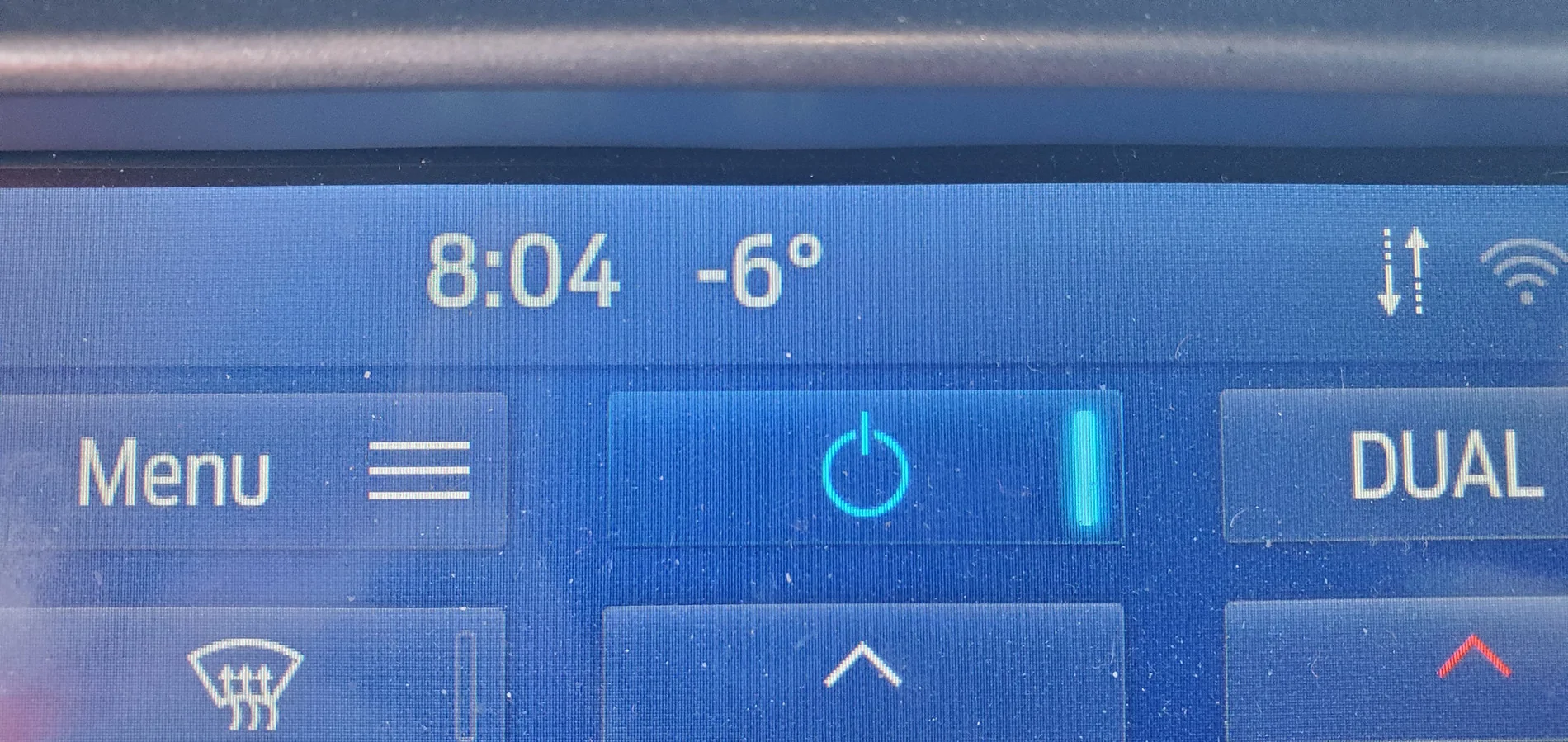

How can I blame it, I stop working at 10F LOL this weekend will be brutal, WTF they dont call this Brutal yet?
