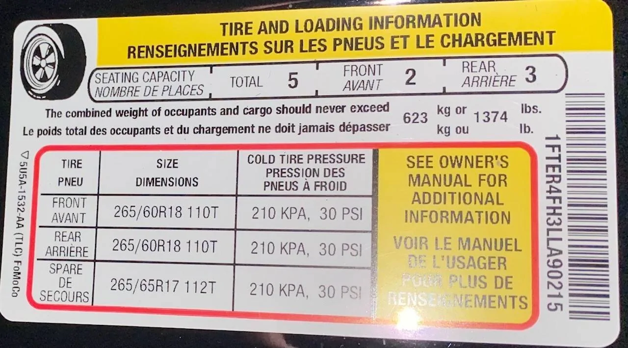

That's 1/2 a ton last I mathed. Should Ranger be more than half a ton? Nah.
It's a little over 2/3 ton, but who's counting. I wasn't complaining that it wasn't enough, only noting the difference between various models and packages.

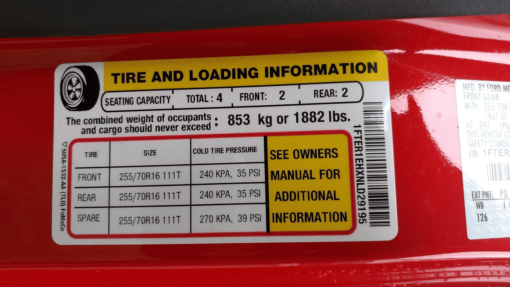

In theory, this is Soupie, a 2WD XL Scab - 1,882 pounds:
But after a year and a half on this forum, Soupie can barely do 10 pounds! =D
I should weigh all the crap vital gear, that this forum forced me to buy. It has to be around 200 pounds! =p

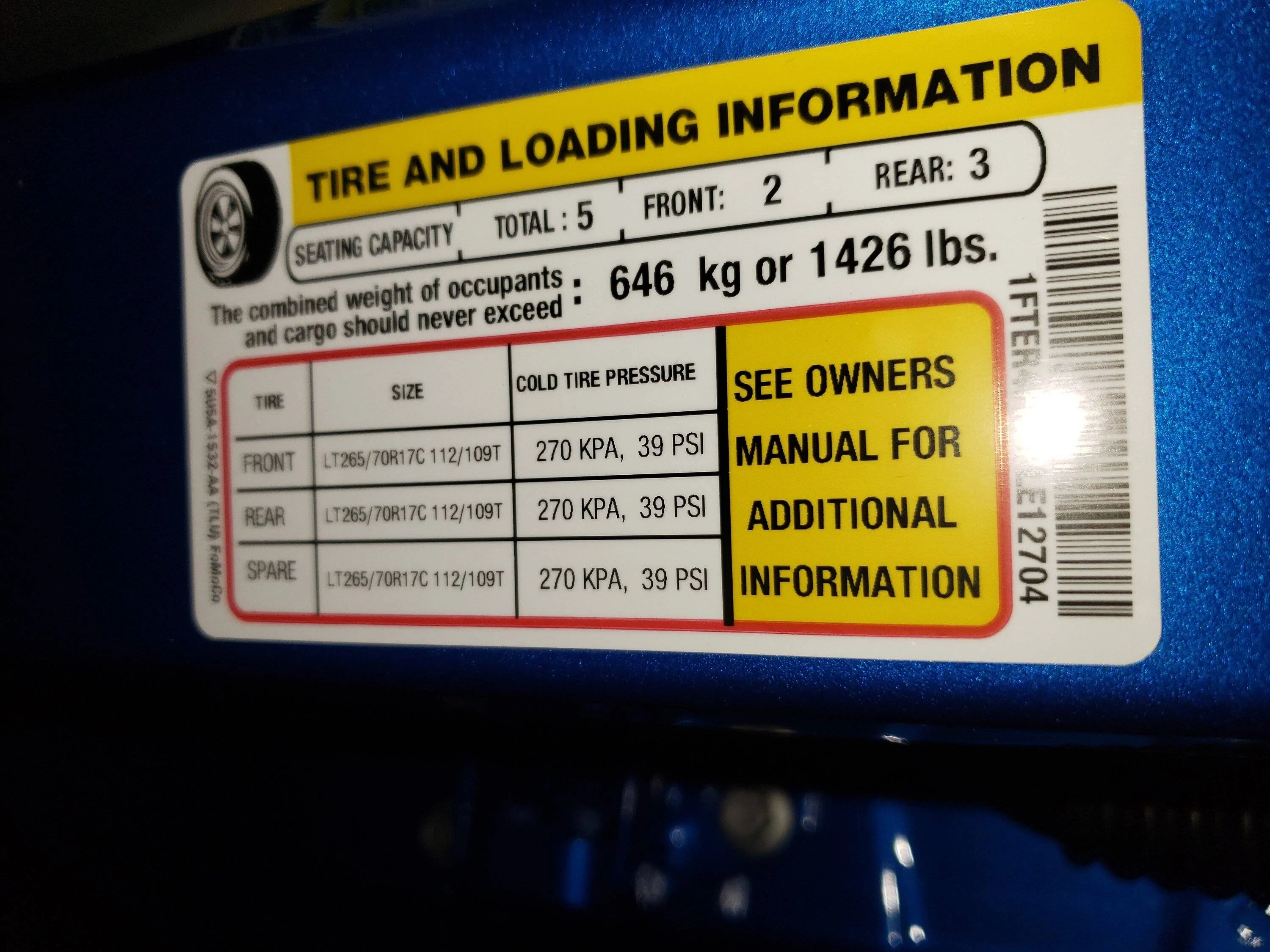

Dang!!!!! I need your truck!! Mine is only 1700! With all the trailering i do, and load the bedbi could use that!! 2022 xlt fx2
4,566
23,252
LOL, I bet my personal payload is bigger than yours!
My petite and svelte 230 pounds take a chunk out! And Cheech is a big Chihuahua mix at 22 pounds! =D
I think so much has been de-contented from the '22, the only good thing is a greater payload! =D
