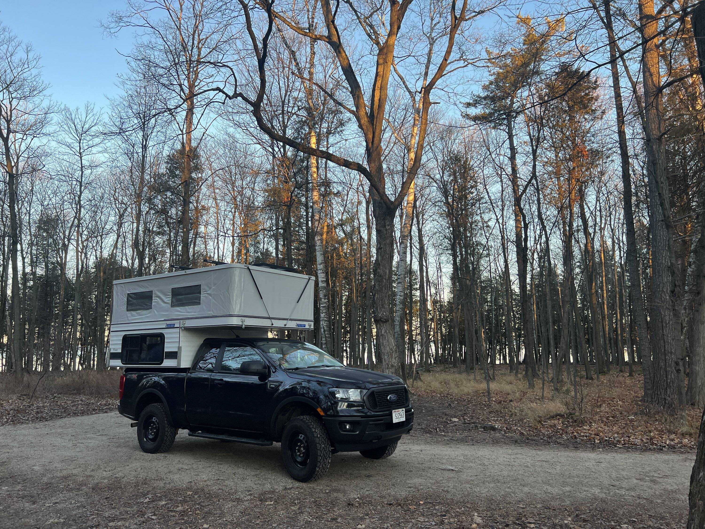

The photo is with the camper open, this is not a high profile camper nor is it heavy. Anyone not familiar with FWC campers and their associated weight should look further into them. ALL OVER THER WORLD people are using "mini trucks" with overland setups or for true work trucks. True many people overload trucks with campers but honestly I've seen this more with 3/4 ton trucks overloaded than mini trucks, usually people with small trucks are more familiar with their limits. In the states we are in the minority believing that everything must be so large and overpowered to haul anything. I recognize the global platform for the ranger is a little bit different but I am not overweight or pushing the limits of this truck IMO. I just got back from Colorado with no issues on the mountain passes, and other than more sway than I want the truck handles this thing without issue. The dry weight of the camper is around 660 lbs - there is literally nothing inside of it except for a bed and a battery (no furnace, water system, table etc). Just to make you cringe here is my truck loaded up with 1200 lbs of solar panels and still under weight with myself included :)
With that said with the Old Man EMU lift the medium duty springs for the rear are a perfect match for you. They will hold the weight of the camper at lift height and can take an additional 780 until leveling the truck out with the lift. It will allow you to do the work you need to like loading the solar pannels and other things while having the needed clearance going on the trail.
As for the sway I say see how the truck is with the lift kit with and without the rear swaybar. I dont feel its needed as of yet for me but then again I'm not quite as loaded like you are

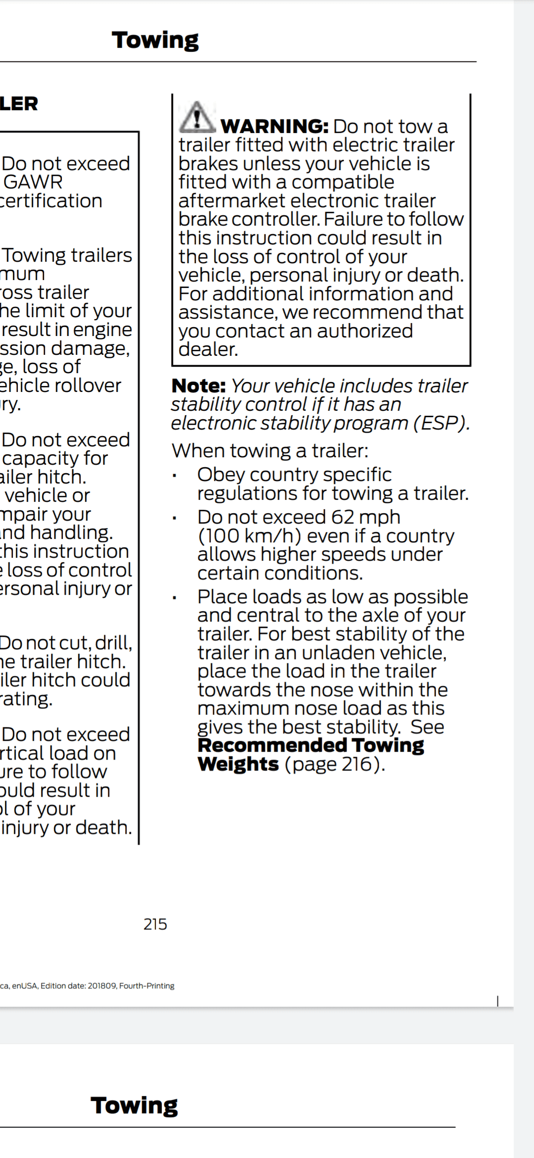

As much as you are not wrong Ford also states in the owners manual to not go over a certain speed when towing(55 I think). Does that mean people are going to do such? Not necessarily since common sense isnt so common anymore. Also with Ford already doing their testing and certifying the Ranger for the payload and towing capacity I think I can trust it just fine. Yes its still crazy for a little 4 cylinder truck but with the gearing, suspension brakes I feel the Ranger is more than up to the task. It just comes out to being smart and not doing crazy maneuvers and such when able.
2020 owners manual, page 224:
When Towing a Trailer
• Do not drive faster than 70 mph (113 km/h) during the first 500 mi (800 km).

Being a.little curious I did find the same thing in the 2019 manual on page 220. Also on page 215 I found the following wich conflicts with the break in period a little.

Nice. Another example that reinforces my belief that Ford copied and pasted content from other manuals and did a poor job editing, if they made any attempt at all, for the Ranger.

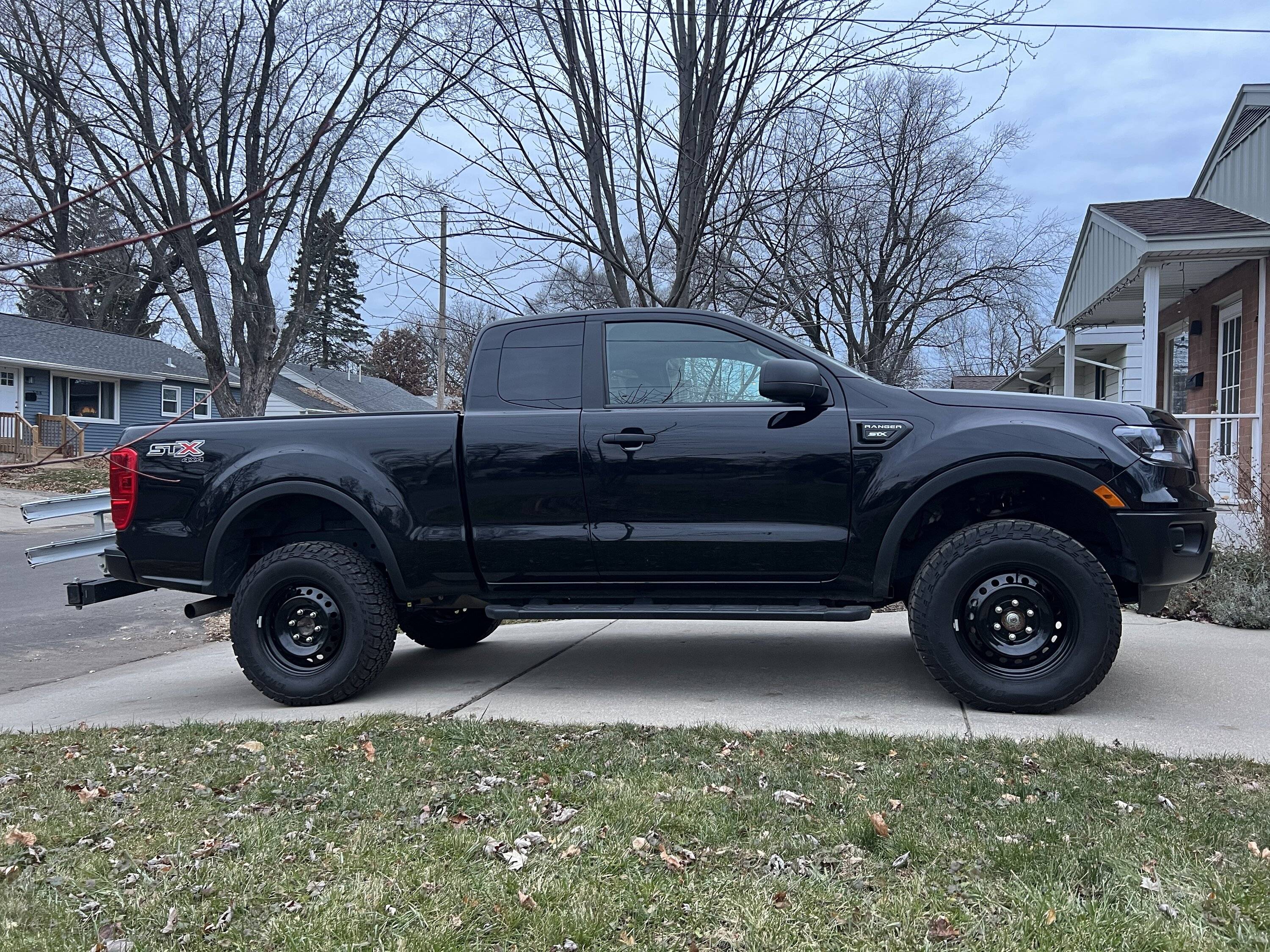

Got off this forum for a good amount of time but I am back!
I did a full OME suspension kit from @Stage3Motorsports with medium duty springs, bronco steelies, and C load range general grabber atx tires. I won't go in depth into tire choice, it was partially determined by what was already on the bronco take offs but IMO there are way too many people out there running load range E tires on rangers and tacos for absolutely no reason. One caveat being true pizza cutters.
Much improved handling, much less wallow (still there a bit), much improved bump compliance. Overall happy with the setup. Truck sits level with the camper on and still has rake with it off as I wanted.
I have no regrets with the setup currently.

Looks like you've made some smart decisions here. That suspension system is designed specifically to handle heavy loads and to prevent shock overheating on dirt with that load onboard. Sticking with a sensible tire size has maintained as much of your original final drive ratio as possible, while improving angles, and increasing traction.
The only thing you may want to consider is a rear sway bar (Hellwig makes one). It'll add a lot of confidence at highway speeds, but at the expense of outright articulation off-road.
That camper still likely puts you at or slightly over payload (FWC is notorious for lying about weight). But keep other weight off of/out of your vehicle, check turnbuckle tightness regulary, drive carefully, and you'll be fine.
