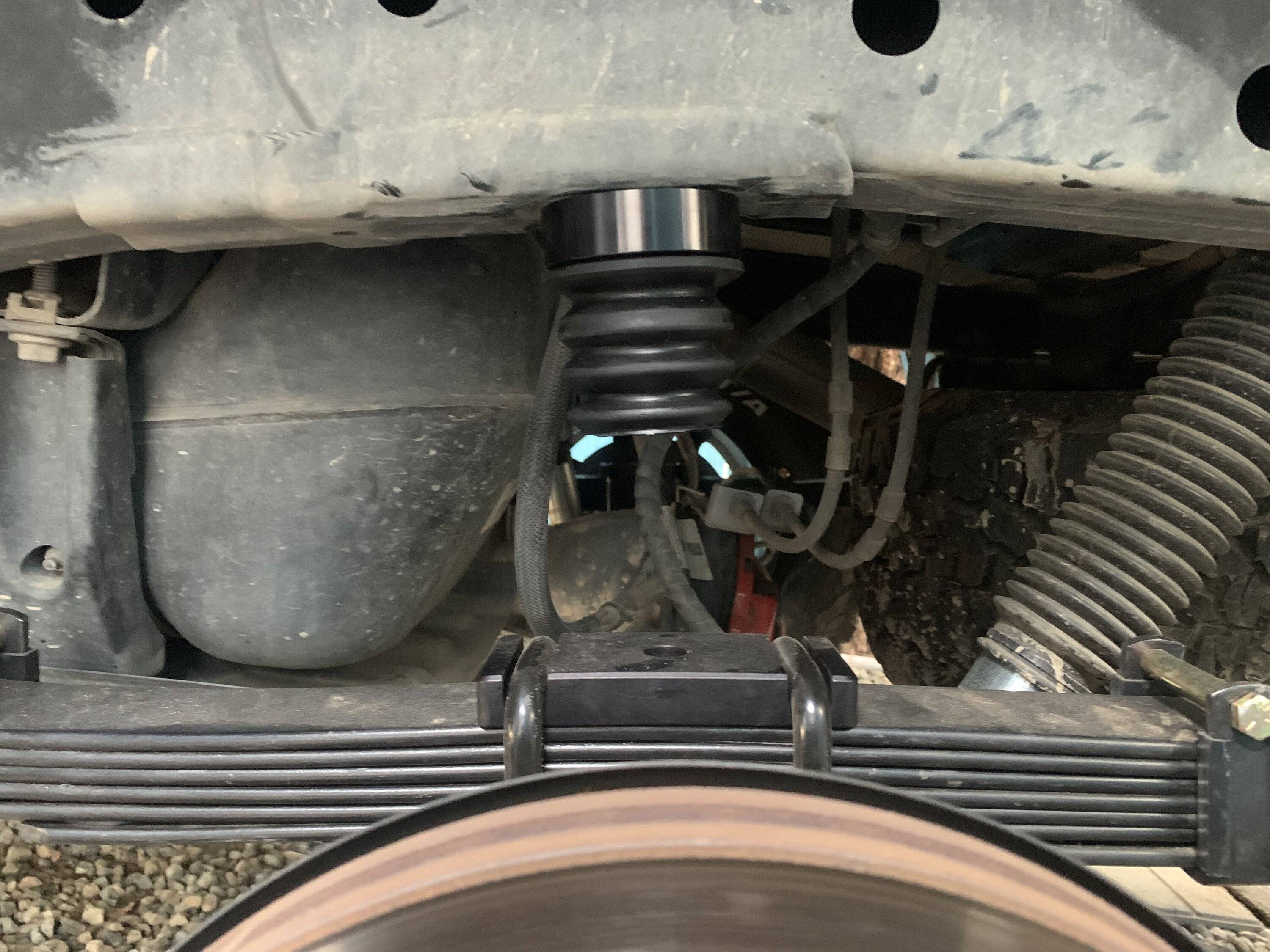

I have Icon UCAs, OME HD fronts, OME SD rears, and Icon leaf springs in Option 3.

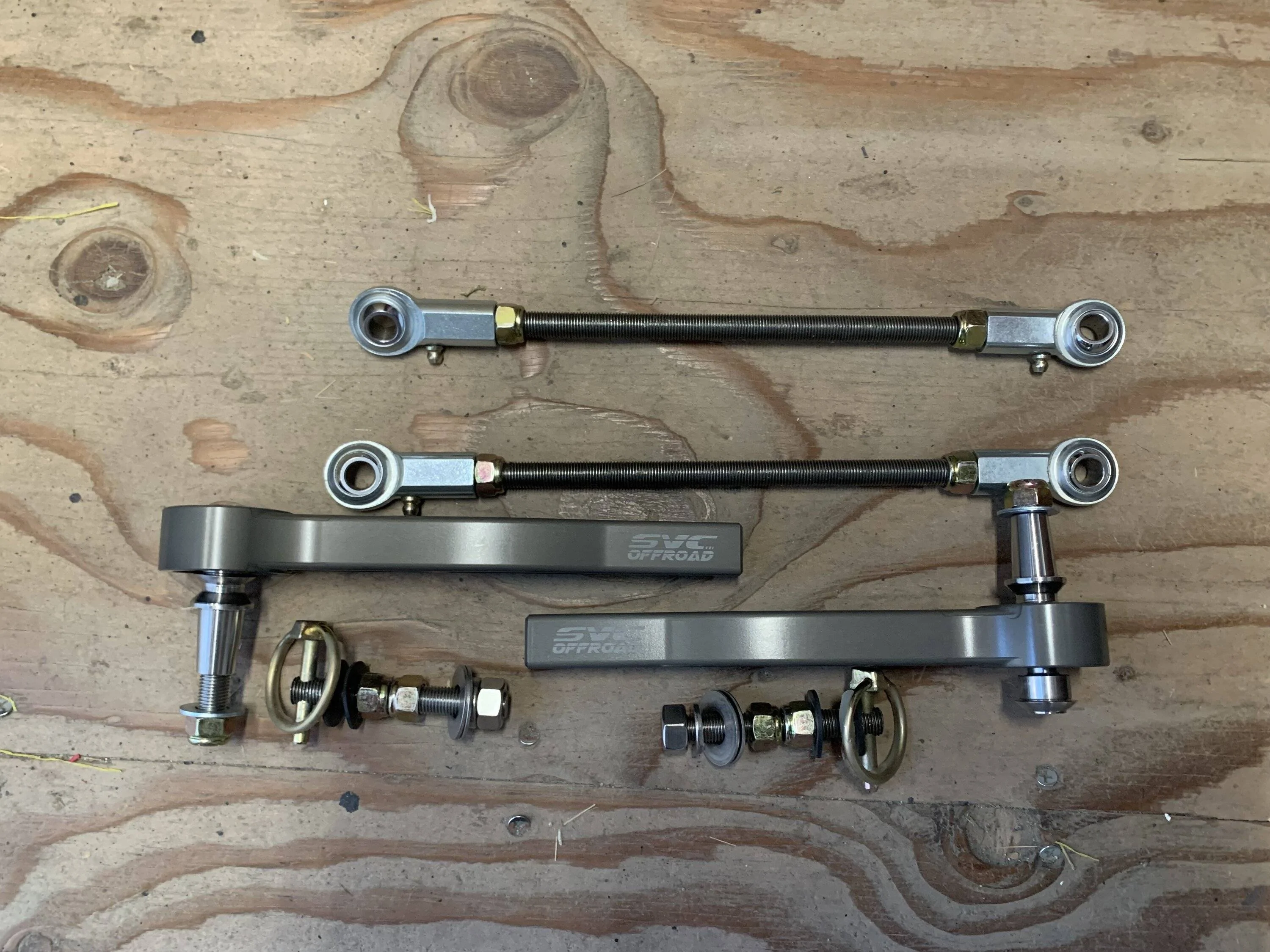

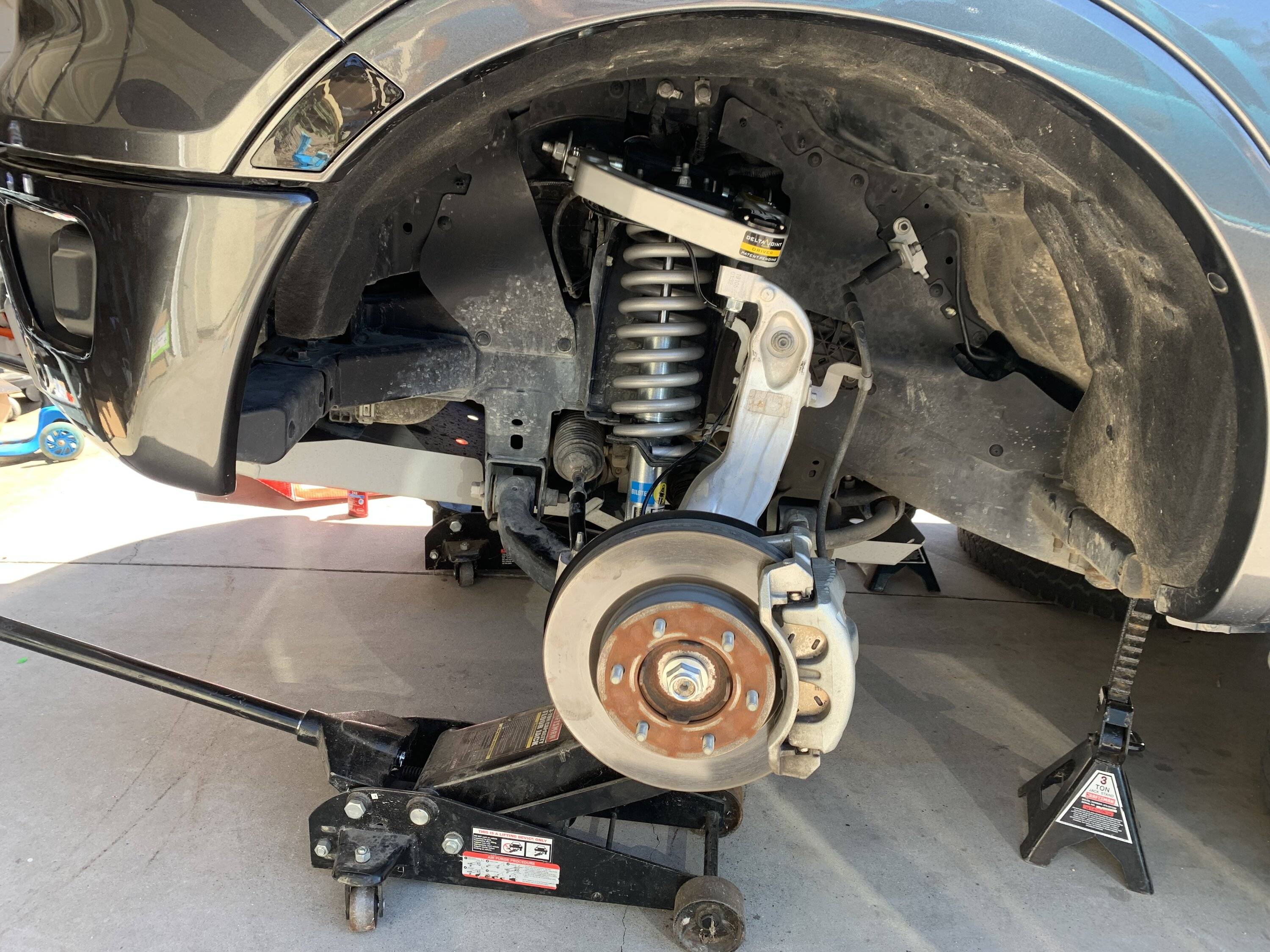

I am thinking of these https://www.apexdesignsusa.com/products/autolynx-sway-bar-disconnect
Apparently they will fit the ranger
Just came across this thread don’t think Apex auto lynx will work with our rangers. I emailed them earlier this year and asked if they would work with gen5 rangers they sent this picture saying they will bend.

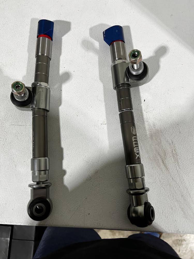

I went with outlandishoverlander haven't installed them yet waiting to do them with SVC tie rods and get it re aligned.

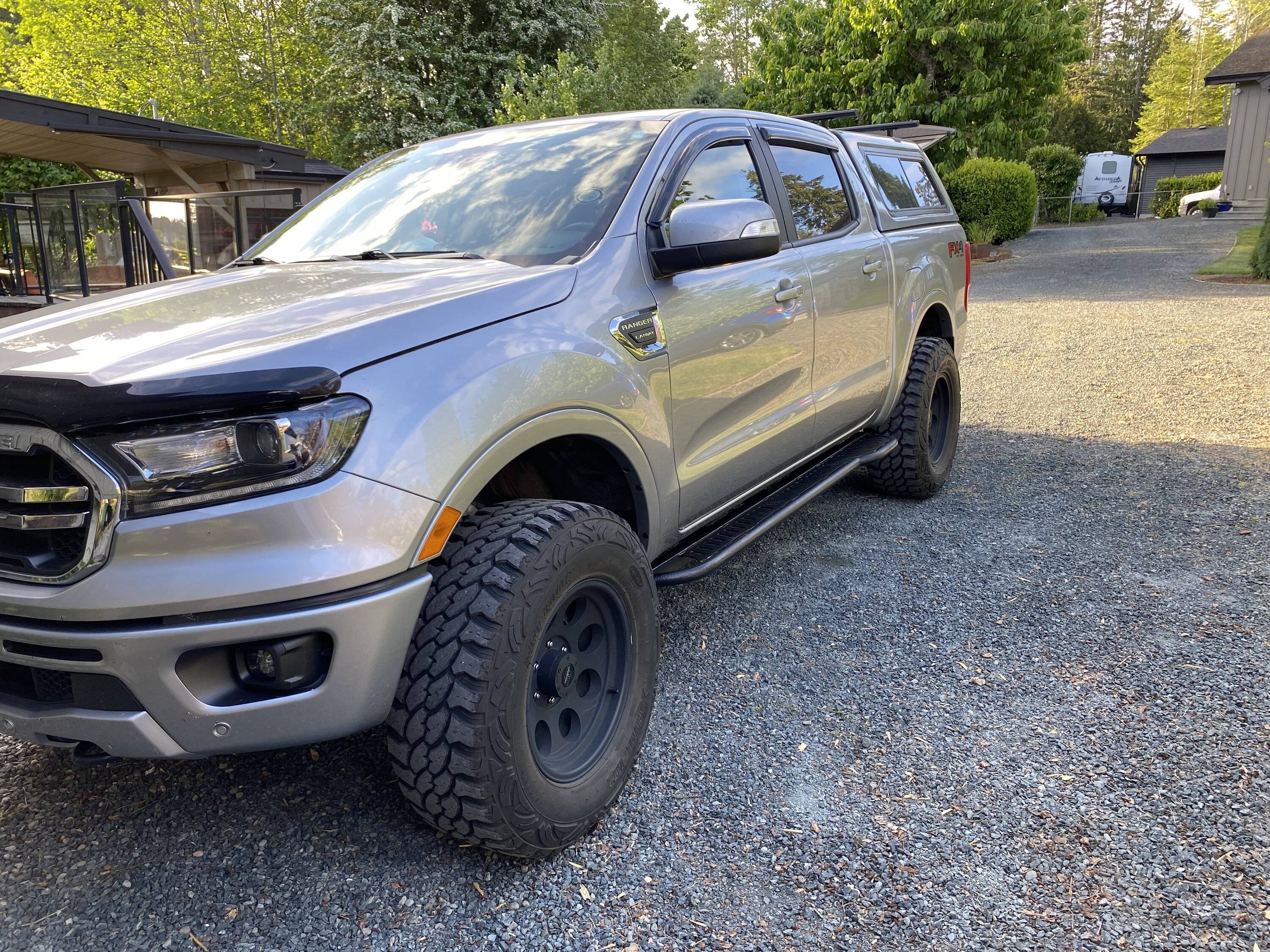

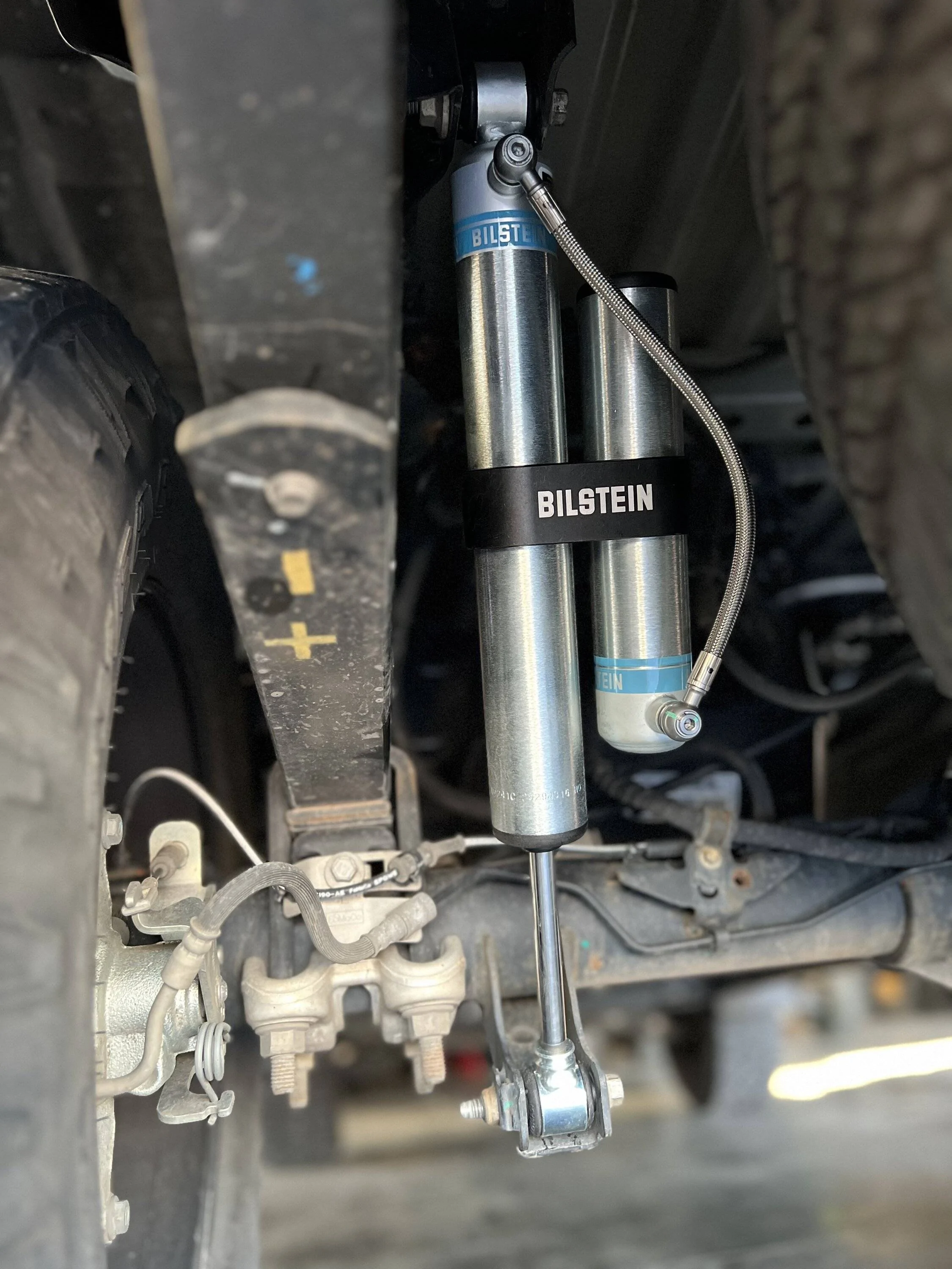

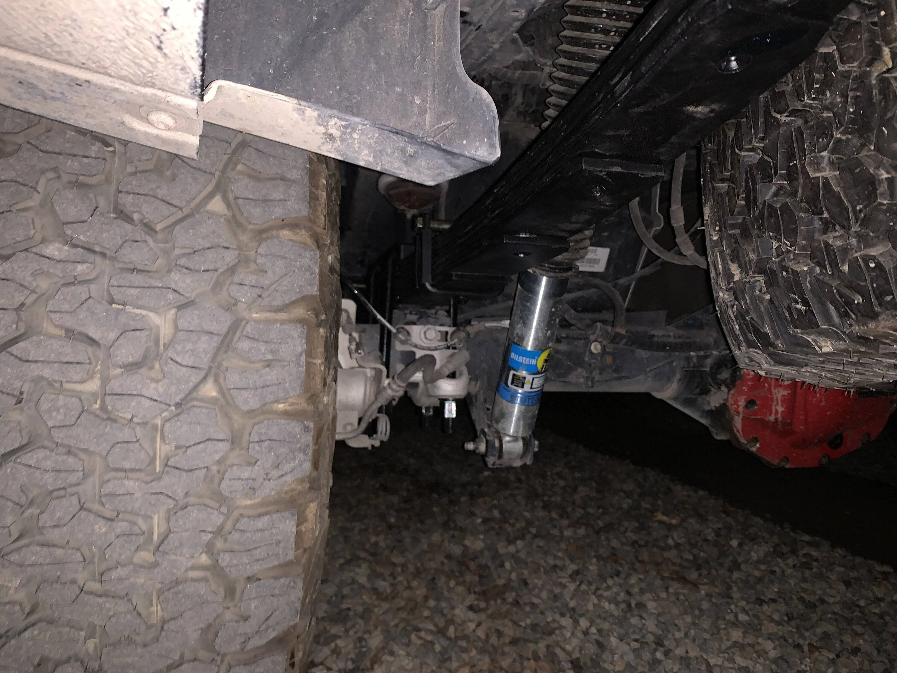

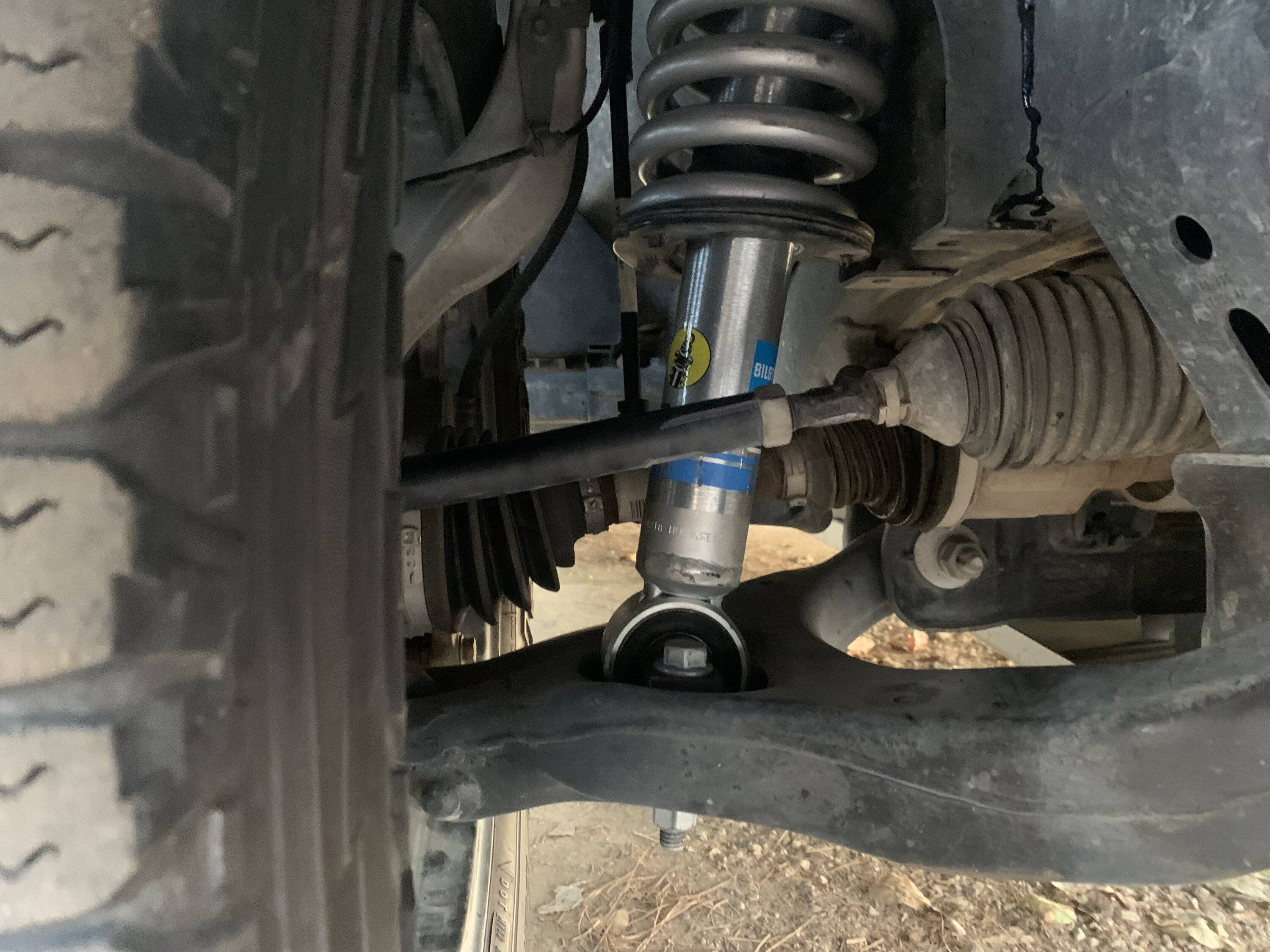

As for suspension on my truck I went with Bilstein 5100 all around paired with Eibach springs up front. 5100’s set at stock setting up front get 3” lift with springs. Still get full stroke from shock set up like this. Ride isn’t as stiff this way and truck is still level. I’m running 285/70/17 icon wheels 0 offset. There is some rubbing when flexed out. I also have fabtech crash bars but might have to remove egg-crate under wheel well to eliminate all rubbing. I have icon billet UCA with icon leafs in the rear. Maybe should have went with deavers icons squeak a little too much. But after I installed RTT they did get a little quieter.
Probably going to upgrade shocks in a year or so. I’ve only put about 7-8k miles on this set up so far but absolutely no complaints this was just cheaper than buying a full Coilover set up. Think I spent 600-700 on springs and shocks (all 4). I did have to take springs and shocks to a shop to get them pressed on though. That was another 30$

Thanks for the info, truck is looks good! outlandish overlander doesn’t ship to Canada, booooo,. Can you send me some measurements, I may have to look into making some.
Looks like 1/2” plates all thread rod with a locking nut. It’s 11-5/8” center to center.
