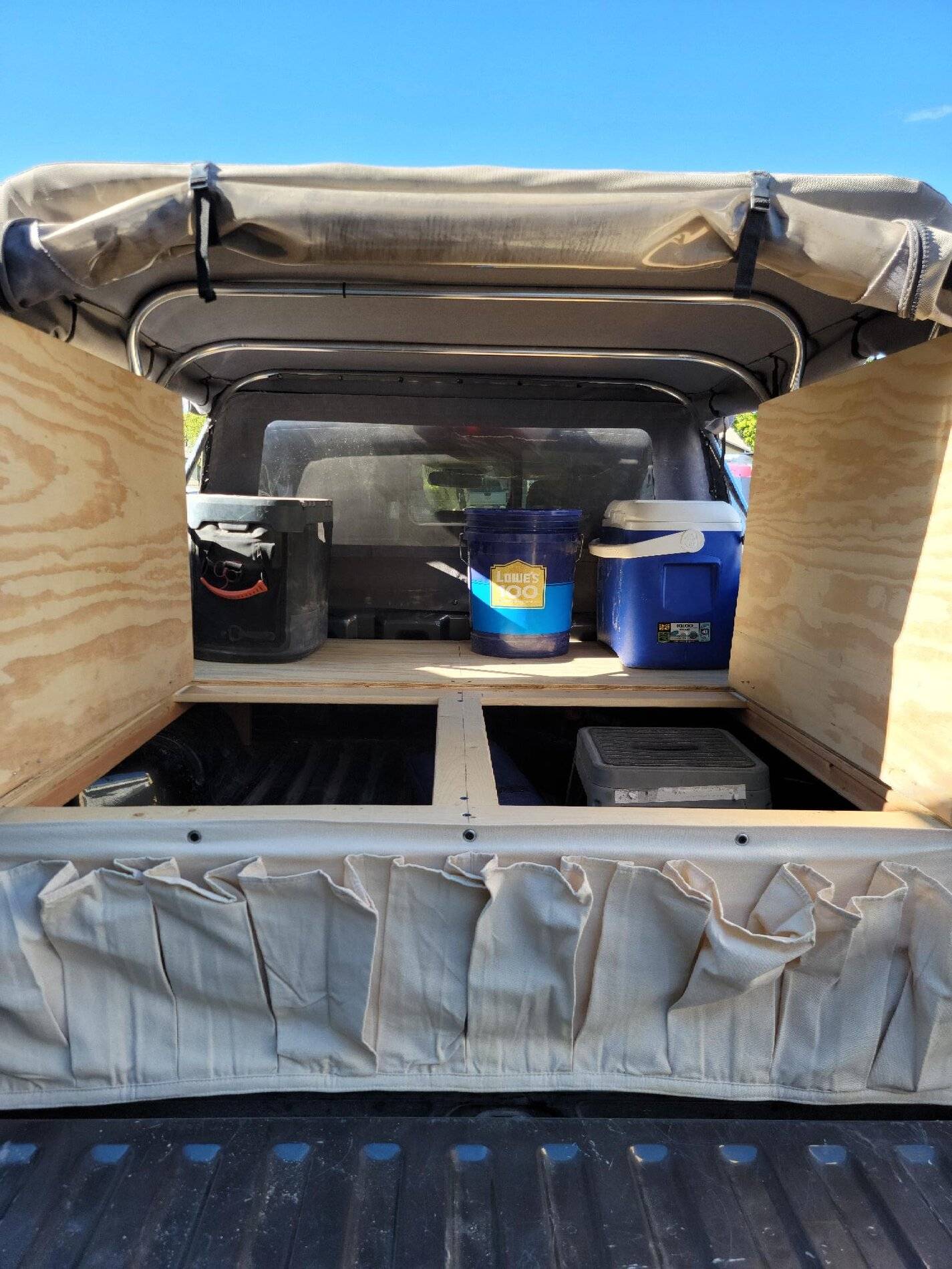

Thanks. The idea of the slat floor down on the bed floor and the gear in the foot locker up high is that we are able to sit up without hitting our heads on the topper. The slat floor also lets dust, debris, down feathers, etc. brush through down into the "bilge" until we get a chance to vaccum it out.

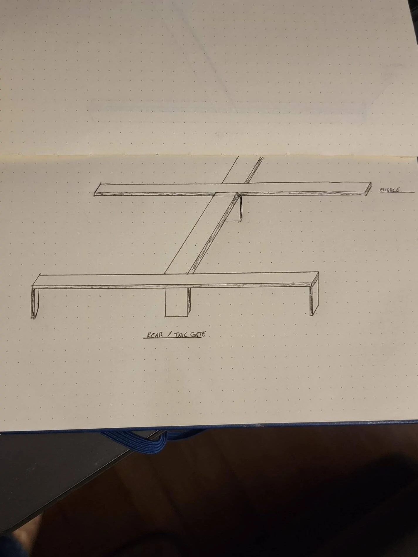

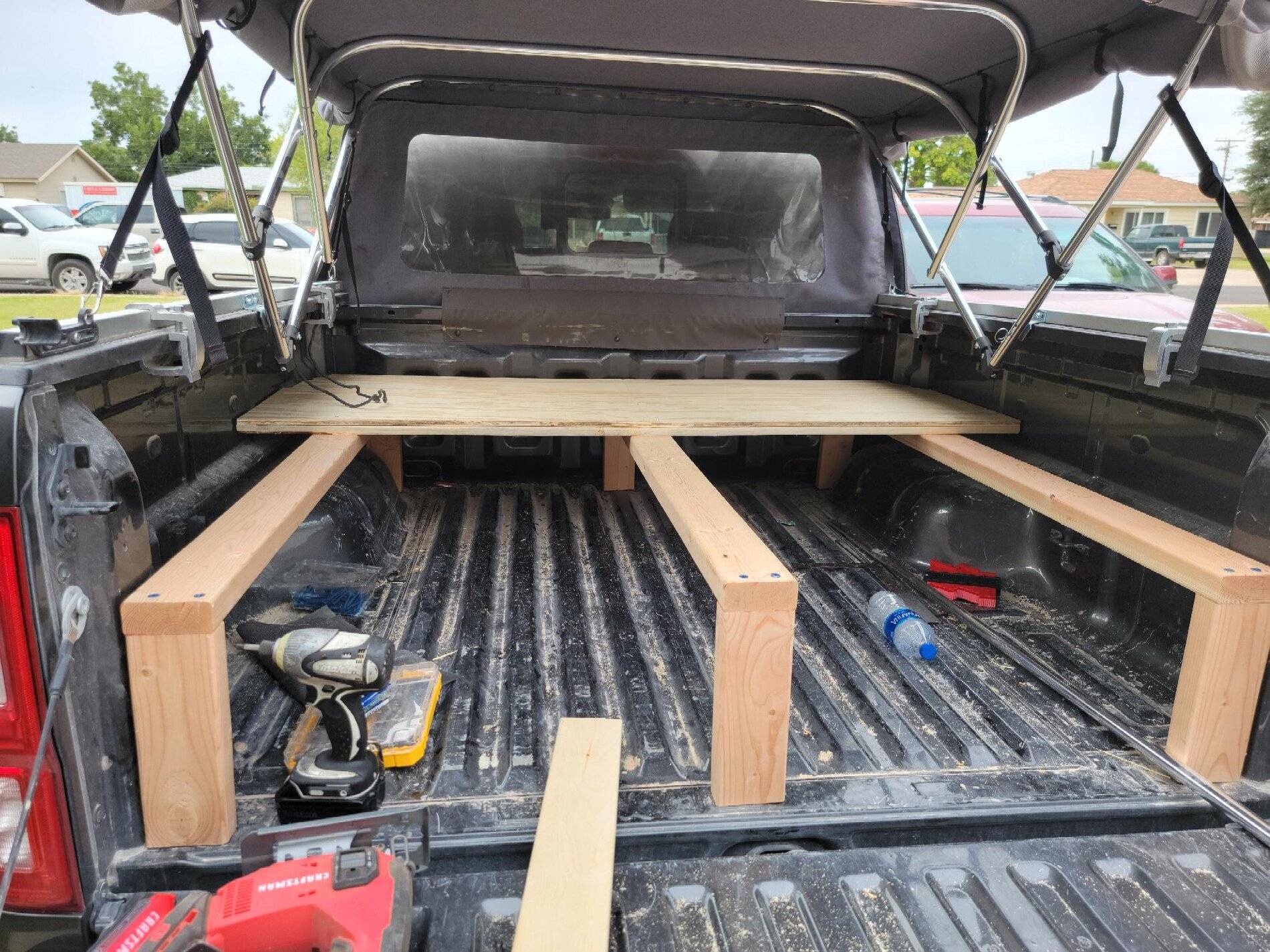

Hello everyone. Here soon Ill be heading out for about 45 days on the road for work and I was looking at doing something like this. Unfortunately I tend to over think things and second guess myself. At the moment I figure if I use a 2x6 width wise at the cleats front and back of the wheel well, a 2x6 in the middle from from front to back and with strategically cut and placed plywood I should be ok. However I keep second guessing it and ending back at square one. Anyone have any luck using 2x6s in this way?

I think I know what you’re getting at but if you could draw it out it would help all of us out a lot. I was considering just reusing factory tie down hook points. I was going to add 4x4 blocks in each of the four corners of the bed and use the factory bolts with a washer to bolt in the wood. Then lie a 2x6 or 2x8 down the center of the bed for support of the top 3/4 ply.

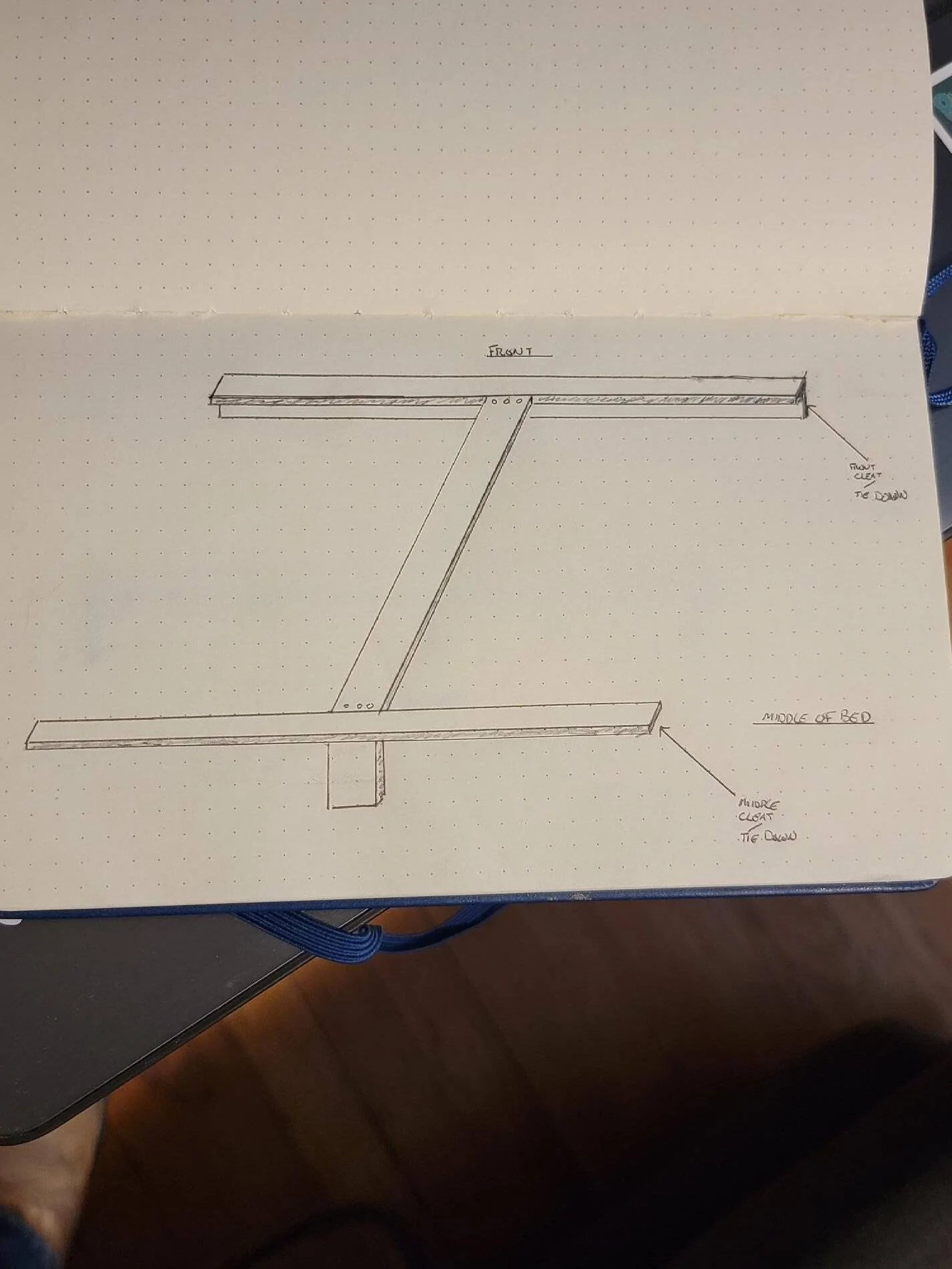

This is the best I could come up with quickly. So I do apologize for the sloppiness. Also please forgive the lack of measurements as well. I had it measured out and wrote down but cant find my log book that I wrote it in but once I attempt this Ill include everything.

imo, a lot more difficult than my setup as posted.

lol I know. The first draft was simple, 2x4 legs and frame that sat over the wheel wells, slates and build a platform. I began second guessing myself and it keeps changing. I even have a sketch of an metal frame.

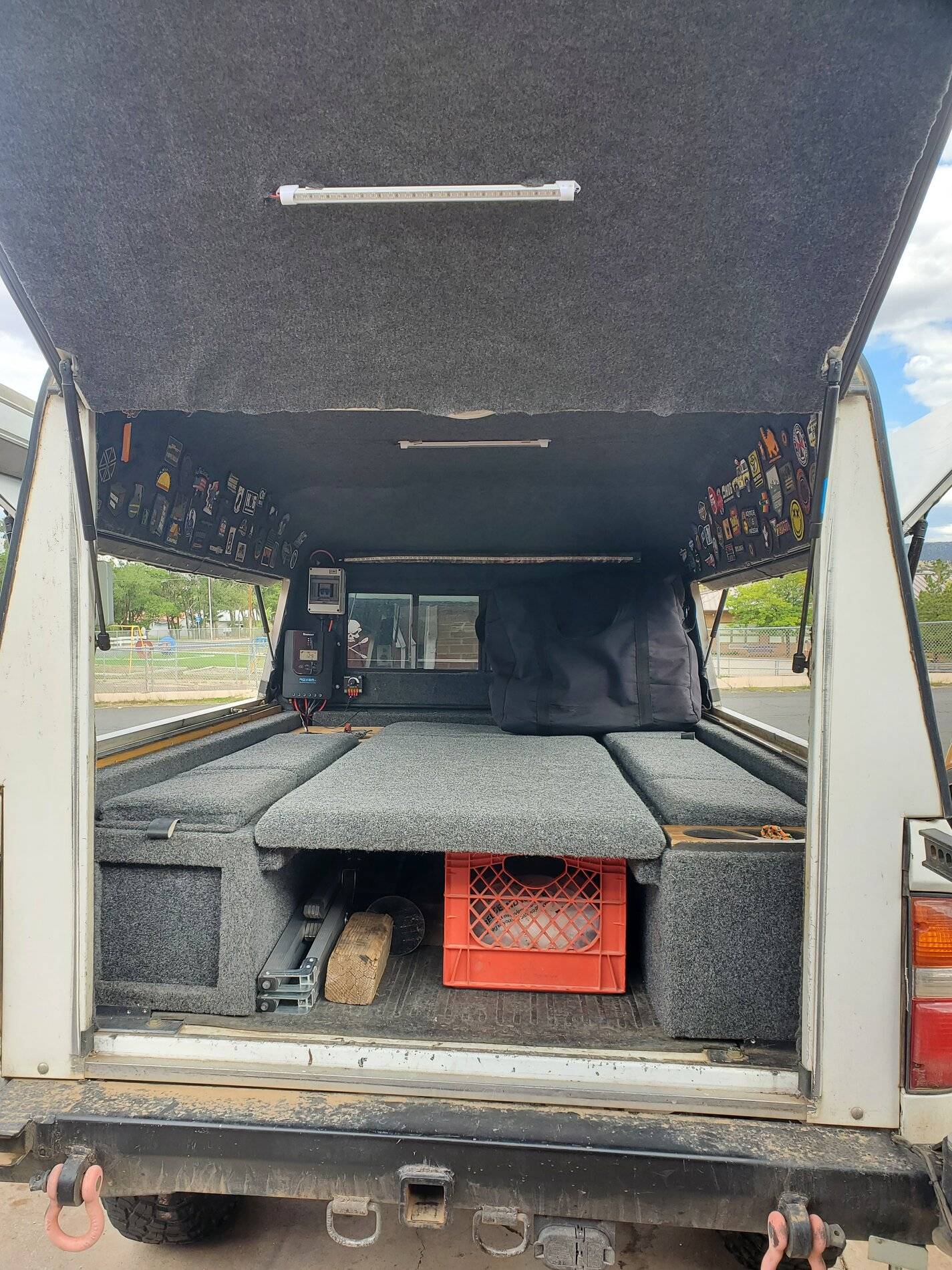

Not a Ranger, but this is what I have in my Tacoma overland rig. It works pretty good for me. And it was only $100 on Craigslist.
Someone sold that for $100? That’s a steal.. especially with lumber prices now.
