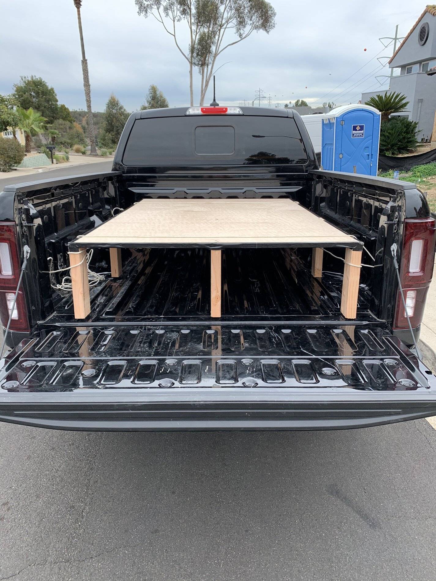

This was $60 a year ago to build with current lumber prices ends up being 100+ probably. This is really really basic but works for my needs. I slap a queen size foam mattress on top and a couple pillows. Measure the width and length and height you want. Buy the big cutout flat bed portion at your Home Depot or whatever similar store. A couple 2x4 cut down to height wanted 3 left, 3 middle 3 right supports. Wood glue on connecting portion of supports and bed and some screws. Gorilla tape wrapped edges and on top of screw portions for extra padding and splinter protection. Easy to remove with one person, amazingly easy with another hand.
Thanks for these details and the picture! Im 6'4" and will have to sleep diagonally so I need the plywood to run edge to edge in my bed. Think I'll have any luck running 2x6 from left to right across the bed and putting them on the ledge that's built into the wall of the bed?
Of course! One thing I will mention… when putting on a truck cap, you lose an inch or two of space.. I’m 5’10 and I already barely fit diagonal and with maybe .25 inch of space if I slept straight. I didn’t think of the cap taking that much space but it definitely affects it. Before building anything see if you can measure out a comfortable 6’5 of room diagonal with the cap on.
I wouldn’t trust have just it sittingon the ledges without under support IMO without a 9 leg support system the flat piece of wood will bend and crack eventually with sleeping on it, putting things on top of it etc.
Yea I will fit! No concerns on that front. Already tried it with a big piece of plywood laying on the wheel Wells. I was thinking of doing two 2x6 running the width of the bed and a support running down the middle length of the bed.

Awesome I think that will be plenty support. I like that idea.
