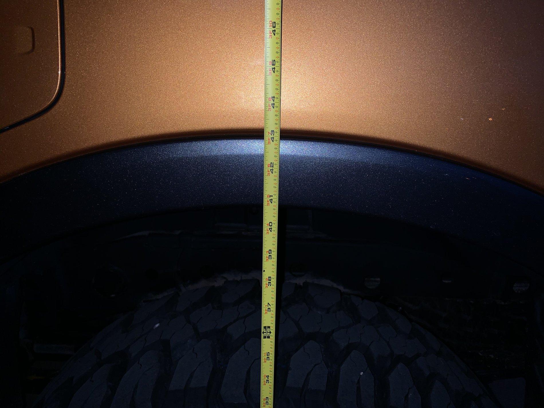

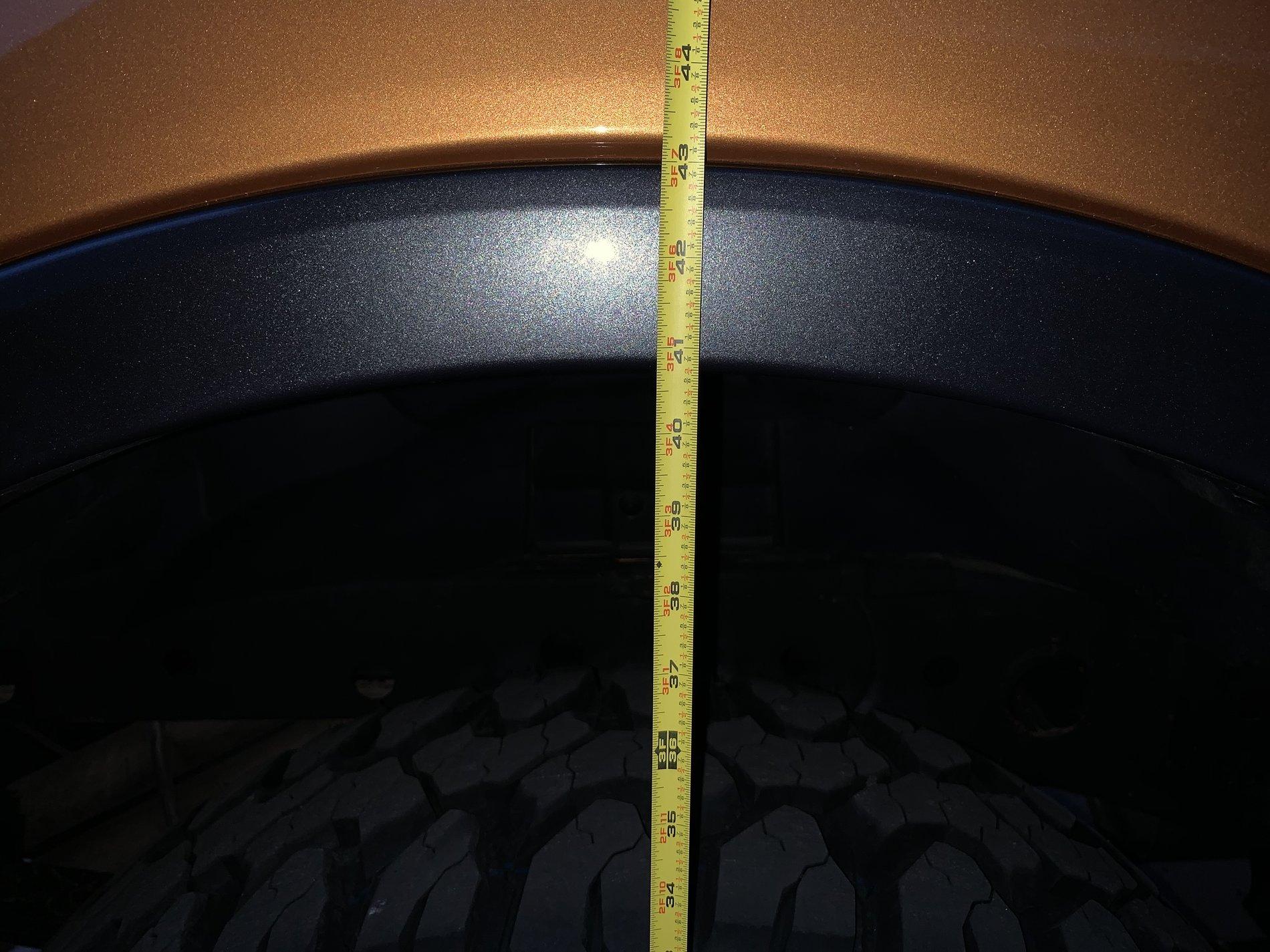

I did reuse the 1/4 shim that was on the drivers side from the factory.
Attached are the current rear heights.
THANKS for the reply.
Now it begs the question: Are the OME springs of equal arch/ride height or is Ford's frames/front suspension causing the lean ?
Hopefully someone orders the 1200# springs and can take similar measurements. I don't think the weight of fuel will make a difference.
I want to be able to run my springs without any spacers.
We'll have to let the mystery evolve.

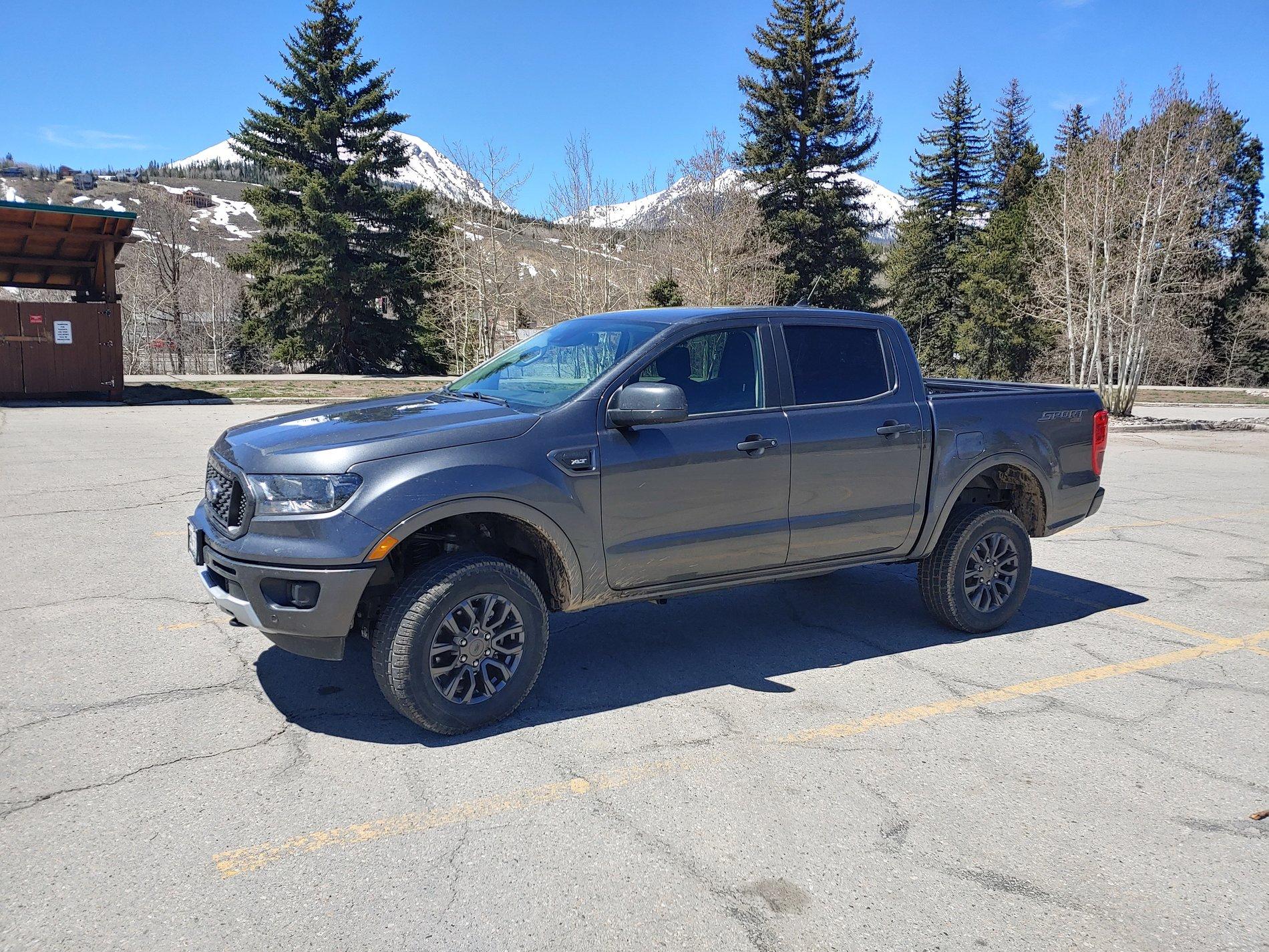

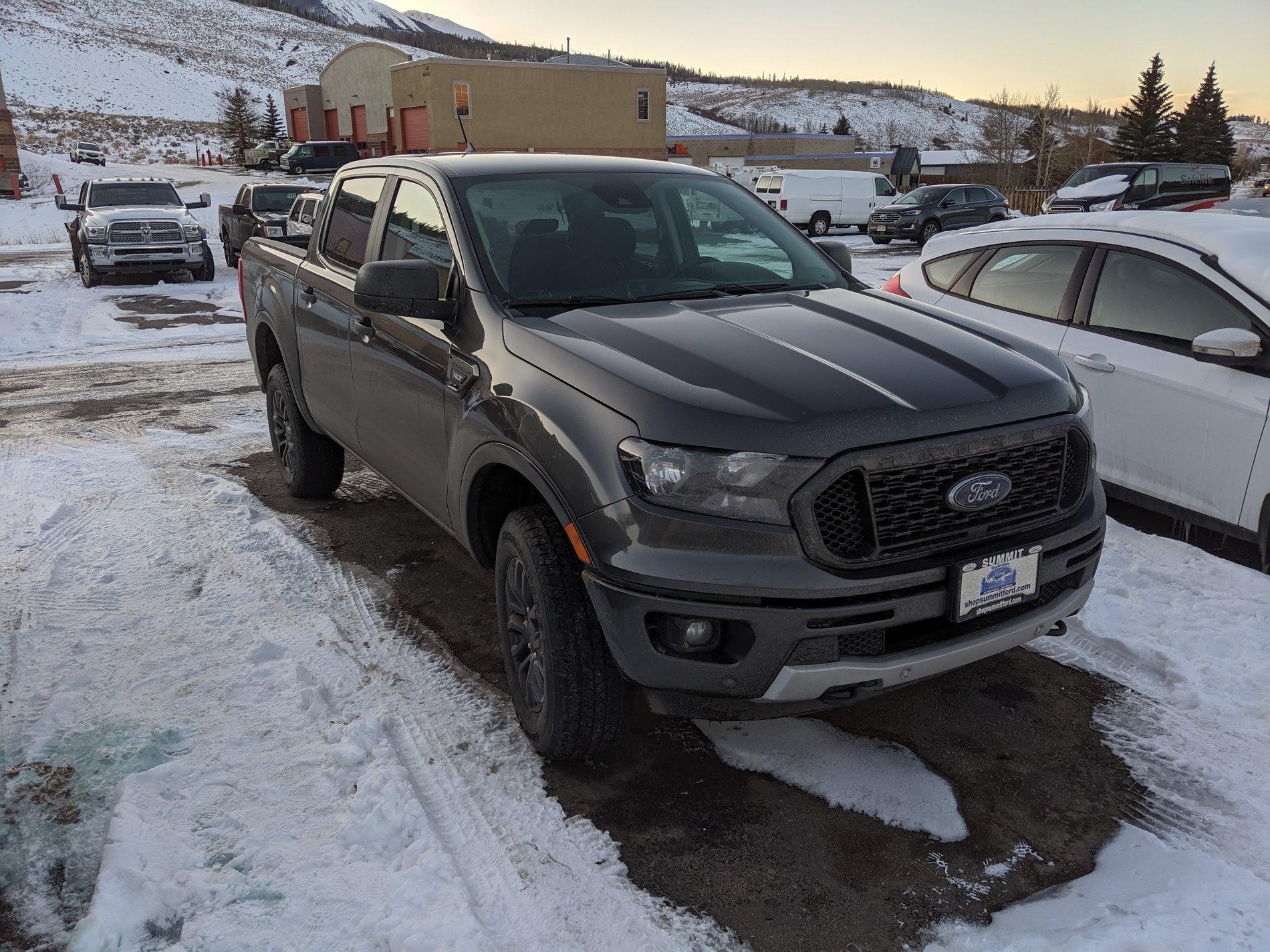

So I will have pictures tomorrow but I have finally installed the Old Man EMU kit!!!! So far from what I can say is for road manners it is nice. Bumps in the road that were not easy to tolerate are now easy to handle. As for offroad we will have to wait until next weekend as I have tires on the way.
Frenchy
Frenchy
Mar 15, 2020
169
7,711
11,024
Elizabeth, Colorado
Field Service Technician
So here is a before and after of the installation of kit. Overall it raise the front about 2.4 in and the rear about 1.5 to 1.6 inches. As stated before the right is pretty nice on the road and I'm yet to go off-road to see how it's going to do. The only complaint I have so far and I'll just have to figure out what's causing it to begin with is at 55 miles an hour I have a vibration. I had it before the suspension lift now it's just Amplified.
