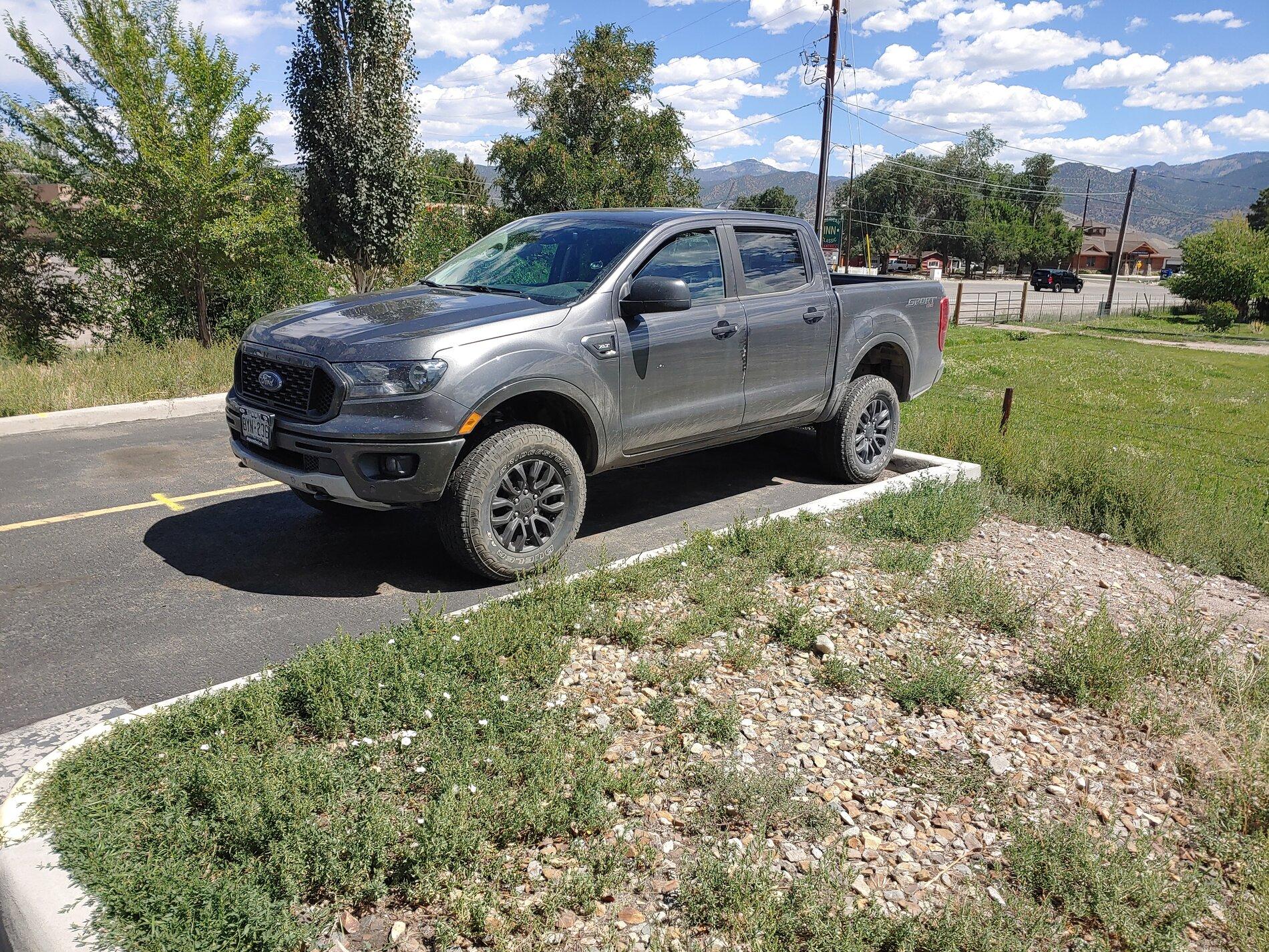

I went with 265/70-17 Bridgestone Dueler Revo3's. Both the suspension and the tires are nice.
Small list of what I like about it. The on road characteristics are cleaned up. I have that confidence through turns unlike stock where I had to slow down. Offroad has been set pretty well. No it doesn't have a perfect ride offroad but you can control the truck with ease compared to stock. You get the right amount of clearance. Some think you need a 6 inch lift..... You don't unless you are making a rock crawler and I wouldn't bother with a new vehicle for that. Me scraping thing underneath just doesn't happen anymore. Towing, unlike most suspension kits out there Old Man EMU designs thier kits for practical use including towing. I just moved and had to tow my 1983 280ZX and it did great. With the auto transport from U-haul the total weight was around 5,500 lbs and the truck didn't sweat it. Ride comfort was still there and the headlights were not pointing to the sky.
Now yes i took a gamble when I ordered the kit since no one here could say much and the people I worked with haven't heard of Old Man EMU. After installing it I can say i am impressed. I have had others ride in the truck before and after the lift and they notice the difference immediately. If that isn't enough I dont know what to say. Also it still rides like a truck and not like a car.
Hope this is the info you are looking for.
