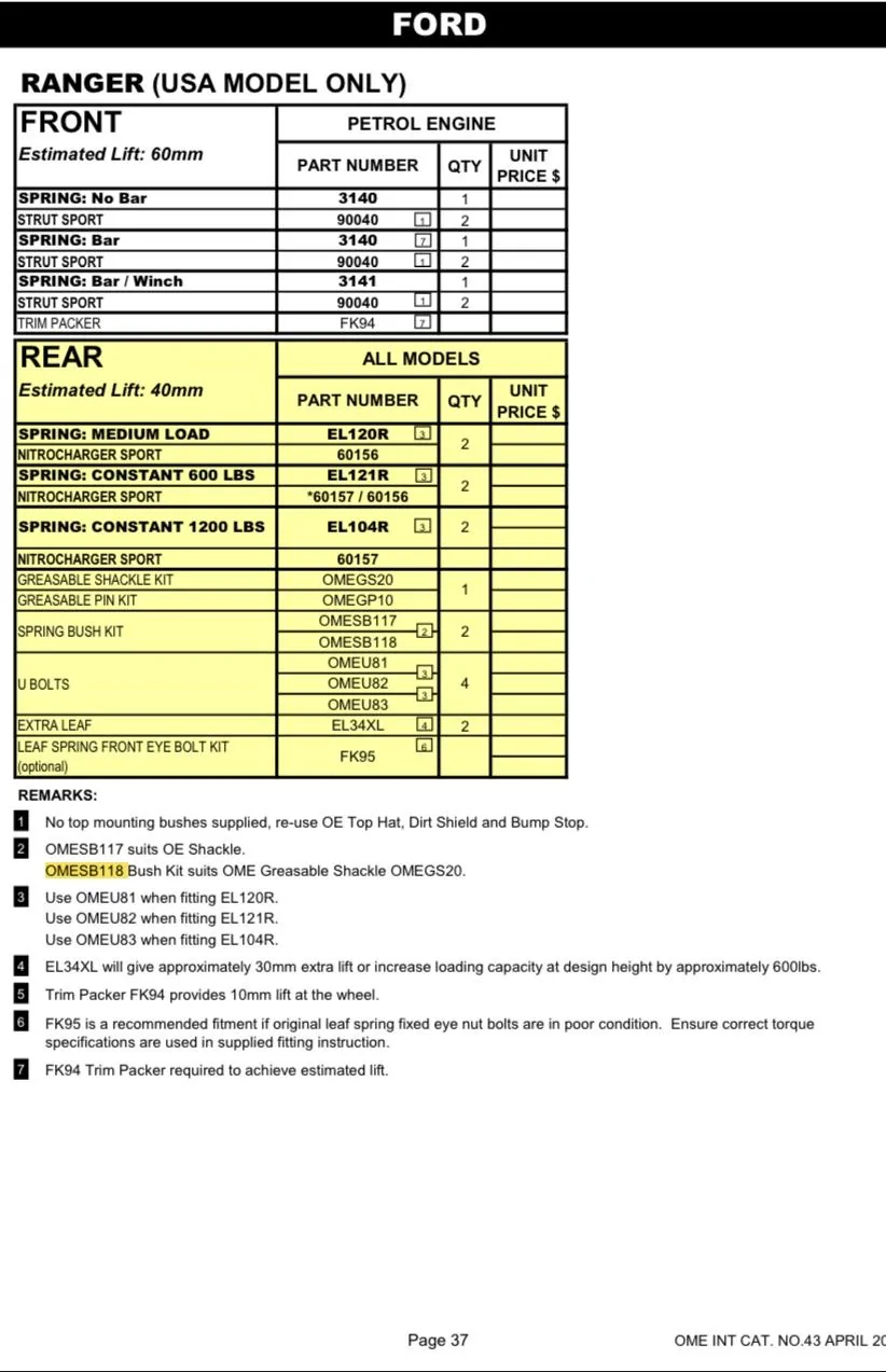

I can't imagine hauling 12,000 pounds in a Ranger. I assumed it was a typo when I looked at the website, but maybe its GVWR? I think it adds a couple thousand pounds to the payload of the current suspension? Maybe.
Hah yeah I didn’t take that statement with much thought. Unfortunately ARB USA isn’t very forthcoming with the exact details on these leaf springs. I might try to call ARB AUS and see if they can provide some more accurate info on the leafs. Either way I’m hopeful that I can get a little more articulation out of these.
Nothing, not even new leafs, can change your truck's GVWR or rated payload capacity. These springs have the tensile strength to theoretically handle up to 12,000lbs of load, but that does nothing to change the factory ratings of the truck.

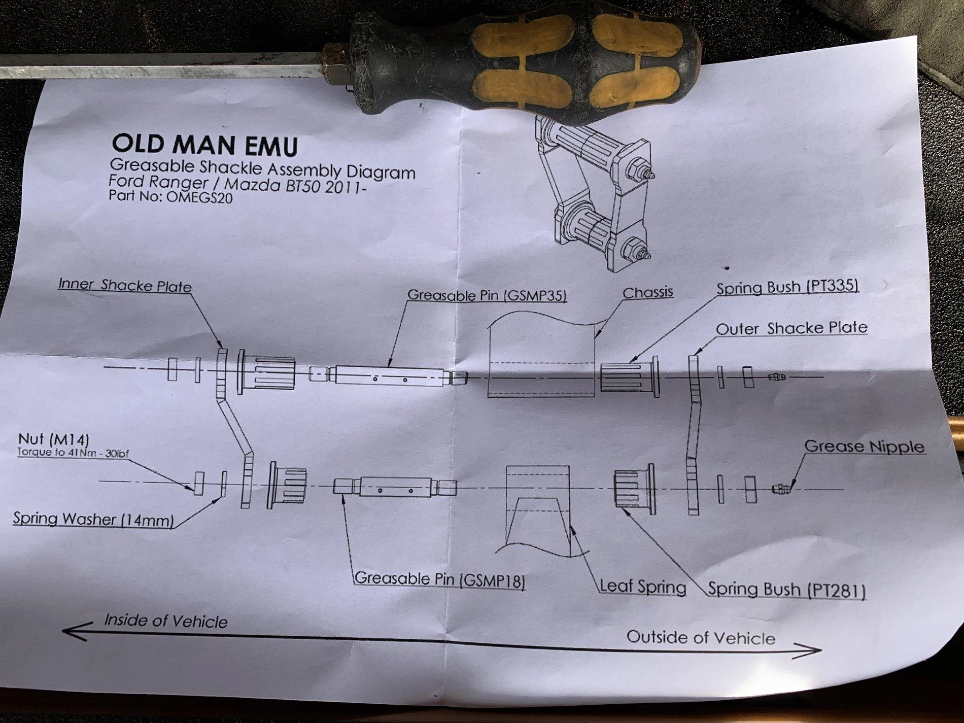

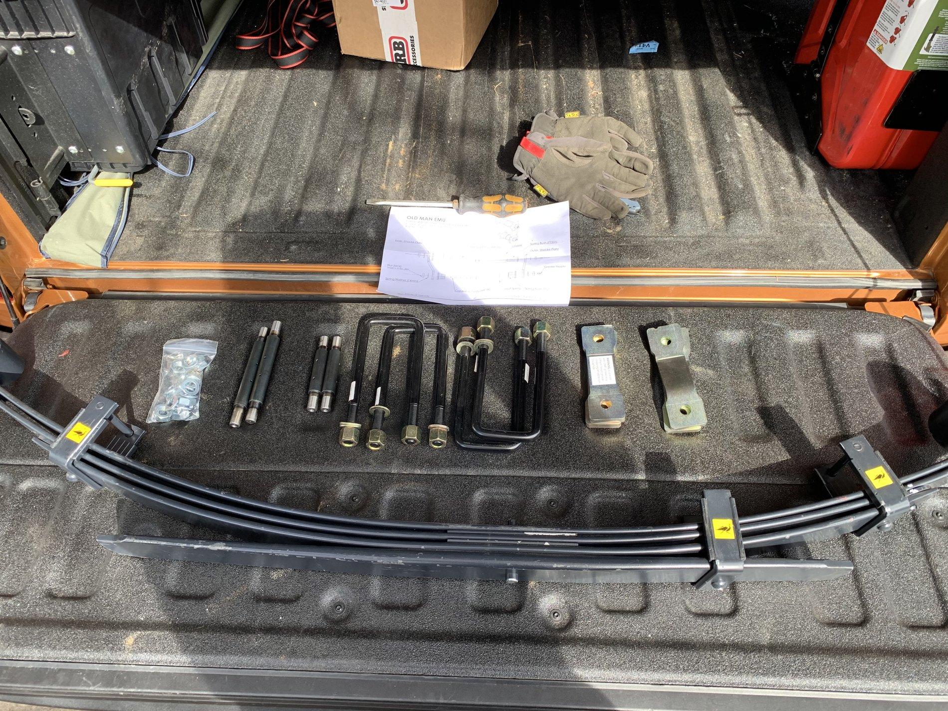

Okay so the install is on hold now. The kit is missing the bushing kit which Jason with stage3 will add to the kit from now on. Always uncharted territory with new parts like this so it’s understandable. ARB has the kit in stock and hopefully it will ship soon. Until then I’ll post the pics of what I do have.

Kind of interesting that it did not come with the bushings to begin with. You would think with a company like ARB that it would come with everything you need including the bushings

Well from my understanding the leafs are mean to be sold with the shocks as a kit. But stage 3 is offering the leafs as an individual upgrade option which I am very happy to see. Another issue is the massive disconnect from ARB AUS to USA which has really limited the information on parts. So it’s a small inconvenience in the big picture since Icon won’t have springs out till September/October. Being the first is never the easiest hah.
Thats the 1.7 inch springs?

Yes, these are the 1.7” lift springs.
Looks much beefier than that stock bar :clap:
If my backend starts to droops, may be a spring upgrade in my future. I'll add it to the list
I agree, they also have the option to add a leaf (EL34XL) to the pack for an extra load capacity of 600 lbs.
