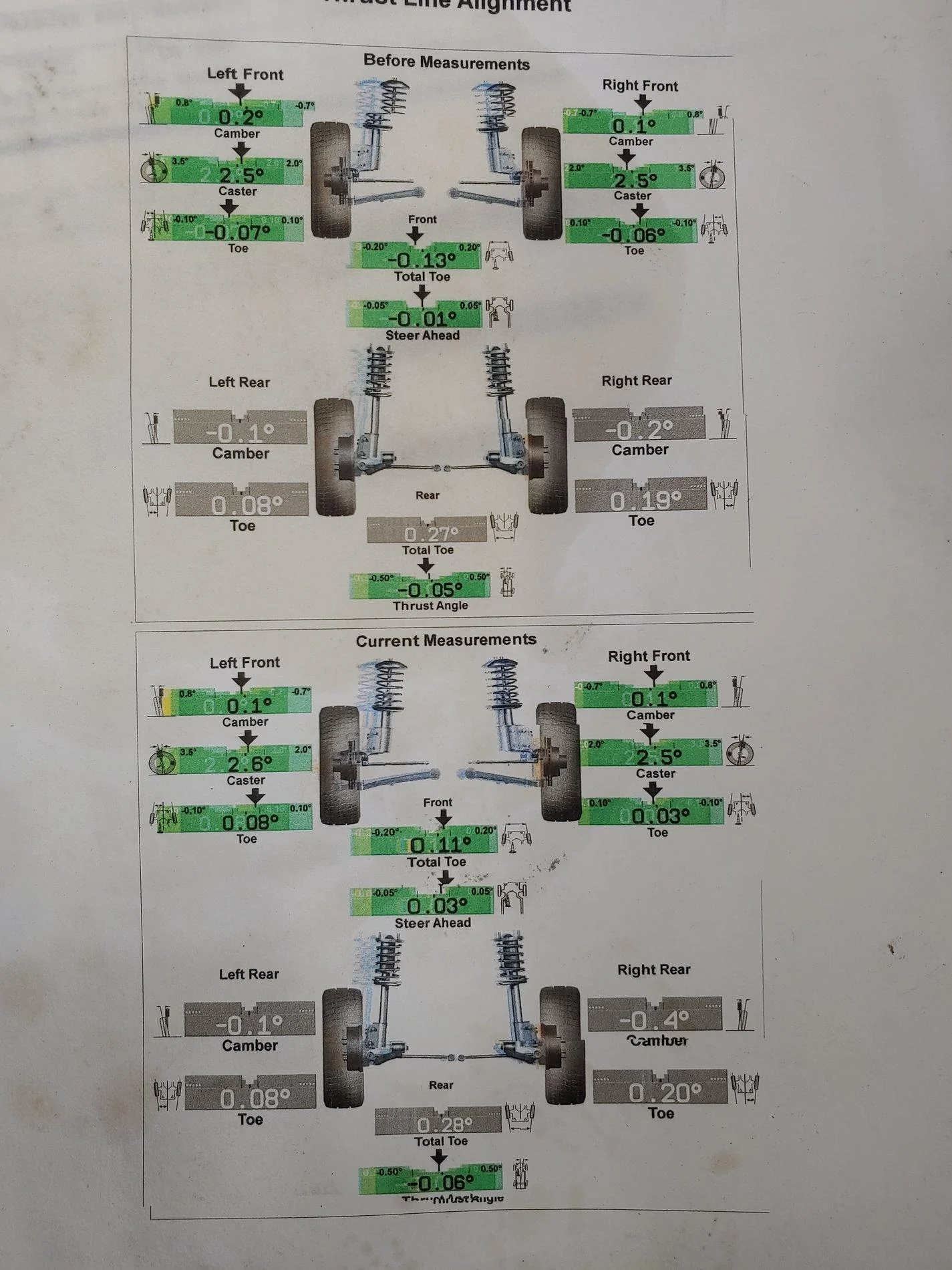

Also to add here are the alignment specs for the old man emu kit with my fat ass in the truck.
