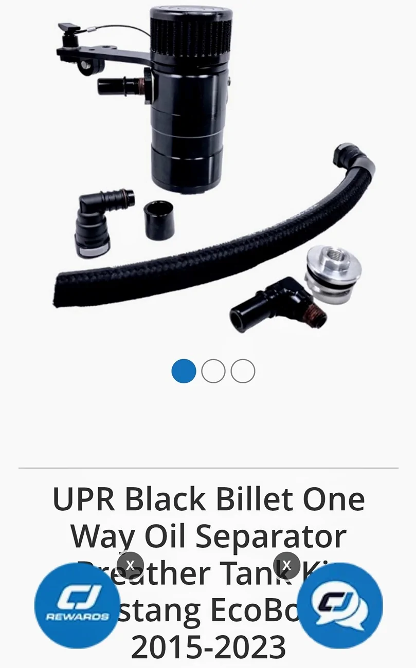

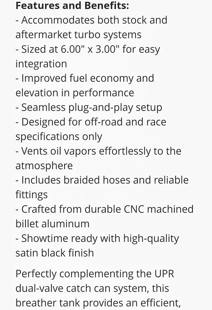

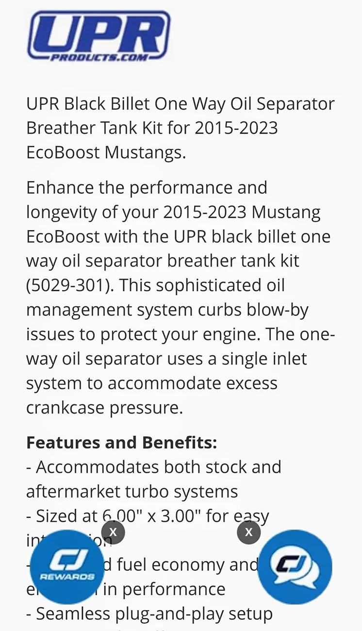

Does that make an argument for the vented oil filler cap? I've considered those but the feedback was they seem to cause reduced fuel mileage - I wonder how?
When the owner of UPR spoke to me about our trucks he took the valve cap off mine while it ran and held his hand over the hole stating that the pressure escaping was evidence of power restriction.
I'd only wonder the pressure in the crankcase was weighted against piston rings or addressed by the second vacuum line I was picking up that day for the catch can (which they branded the WOT option).

No, I would not vent the oil cap. If you're wanting to reduce oil vapors, a GOOD air:eek:il separator is the way to go.

It would allow unmetered air into the fuel-air mixture, so the PCM couldn't control the mixture properly.

I think the caps people were installing had a pressure valve for venting only?
It seemed a mod that really didn't catch on.

The 2.3 Ecoboost engine uses a speed density control system meaning venting the oil fill cap will not have any impact on controlling the air fuel mixture. However, there is a sensor in the PCV system that measures air flow and venting the oil fill cap will/can cause check engine light and a trouble code.
