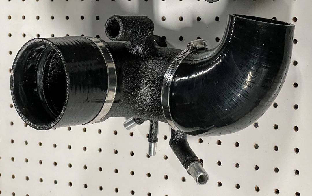

Here's the elbow that connects the intake to the turbo inlet by @Loweredon33s
I wonder what all those connections can introduce.
The outlet at the top of the valve cover feeds into that elbow before the turbo. The Ford Performance catch can interrupts that feed. Outlet from valve cover goes to catch can. Outlet from catch can goes to the elbow. It does collect gunk especially in cooler weather ( 6-8 months around us LOL). Otherwise it’s a direct shot right to the compressor wheel and then the intercooler.
