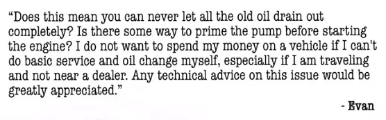

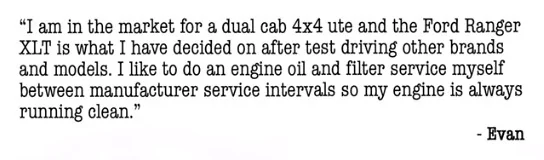

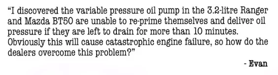

I assume the Op has a Australian version with the 3.2 diesel. Everything I can find on this subject is that if you drain the oil for more than 10 minutes, the pump can lose prime. I would contact a local Ford Service department or just read your manual. Also, from what I read, in some parts of the world, doing your own servicing "can" void the warranty. I think you should make darn sure what you are getting into and understanding what you are doing when changing the oil on that engine

last weekend i changed mine for about 4th time. best time so far 20min to pull on ramps, take well liner out, metal tray, etc. any faster imo is sacrificing something..

at this point, if you've done lots of research, and found nothing....thats your answer.
its not a problem with the 2.0 like it is with the 3.2

yes it should be changes ASAP.
we lost couple 3.2 engines because of that.
also, you can replace your variable oil pump with fixed one, same fit.
it can be found in t4 rangers and some ford transit.
1c1q 6600 is partnumber.

Thanks for your reply, but only on the 3.2 engine?
