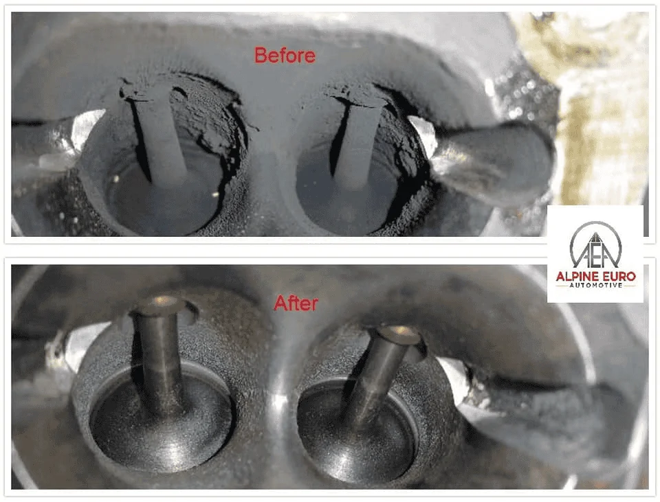

Some additional info from a user on another forum, hes trying to find me pictures from 6 years ago atm.
"So coming from a focus st and the 3.5 ecoboost world many years ago this was a large problem. In college with my st we did a test of diffrent things and catch cans seemed to do minimal for carbon buildup. The only thing besides walnut blasting we found to work is to run water meth injection which cleaned the valves in 3 gallons so about 2 months and then maintained it. Definitely not for everyone but if your wanting to add some performance to its a great choice"
And someone else told me that is mostly vapor/oil sludge as how wet it is. this is 90k miles of actual carbon build up. Thus, it seems catch can works great for vapor/sludge but not carbon build up.

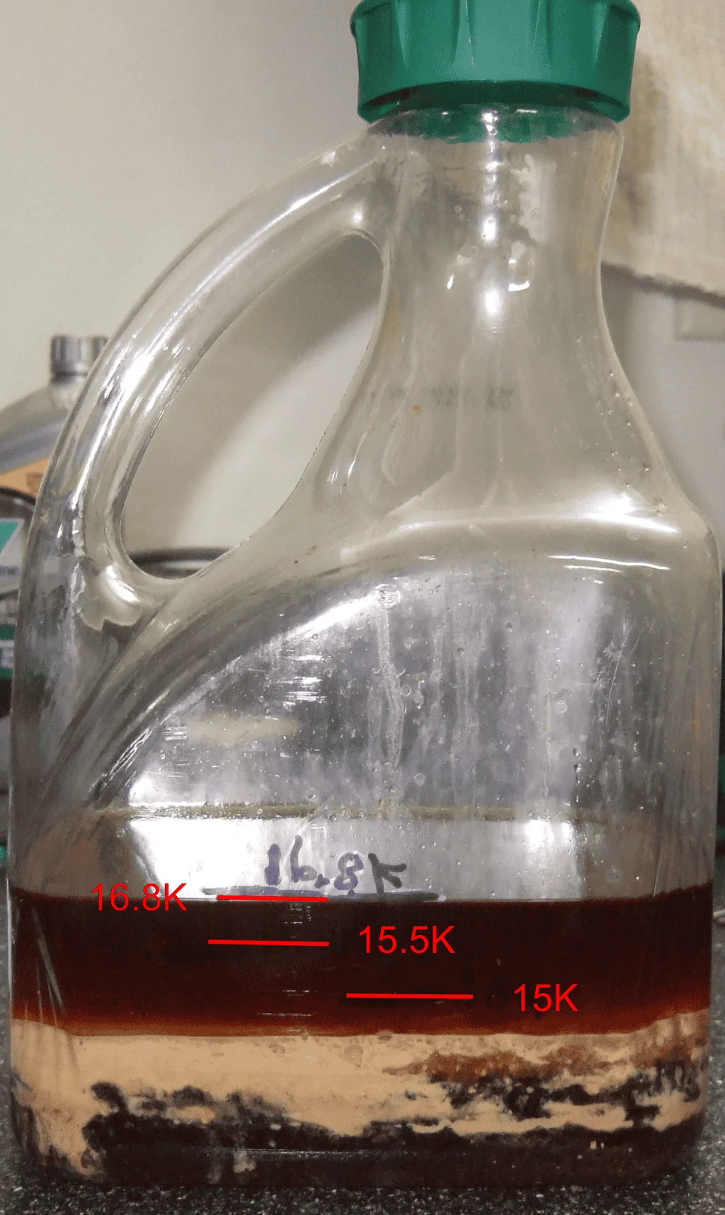

This is my collected goo from my 2020 Ranger since purchased new in Aug 2020. The last 1800 miles was over this winter including two 600 miles trips. One little rain, the other clear. Temps were ~35F on both trips.
The bottom appears to be oil, the creamy delicious stuff in the center appears to be water/oil mix (a good guess based upon what happens to oil when a headgasket leaks from a water jacket into the oil), top appears to be unburnt fuel (smells like it anyway).
It collects much faster in high humidity cold weather.
I rarely check it in the summer, but buildup is quite fast in the winter. I've had the UPR can fill in a week!
As an aside I replaced the baffle oil O ring with a zip tie (the O ring functions as a retaining ring holding the top baffle plate down against the baffle. The zip tie is also loosening up over time (expanding). I'm going with a stainless steel crimp ring the next time I have it apart. I'll use the retaining ring at the bottom to take it apart to clean it. Why UPR didn't use a retaining clip on the top eludes me. They put the detent on the shaft.

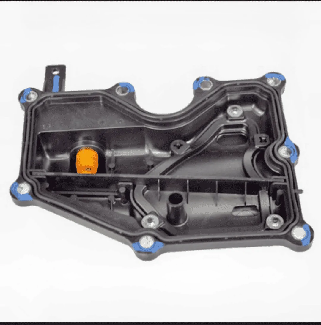

My Ranger to date only has 1600 miles, far from me to think about carbon buid up. But just wondering here in this forum if there are any members installed an OEM oil/seperator like the one below;
OEM Part# M-6766-R23 .

Is there a drain on it and if so where does it go?
I know we're warned to check/drain the CC frequently since sucking the crud they collect into the intake could be disastrous. Now I'm wondering if the CC keeps the intercooler clean too.
Some suggestion in another thread it may stave off egr sensor failure as well. The factory seperator isn't impressive.

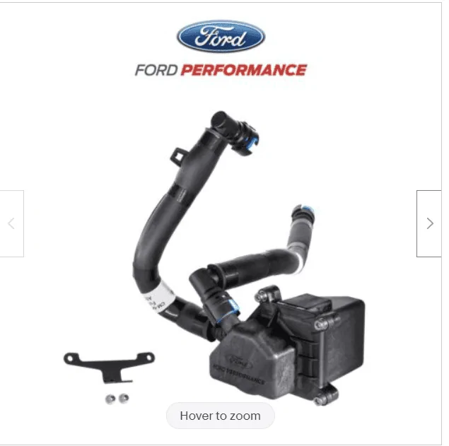

I see the advantage of the check valves on the UPR then.

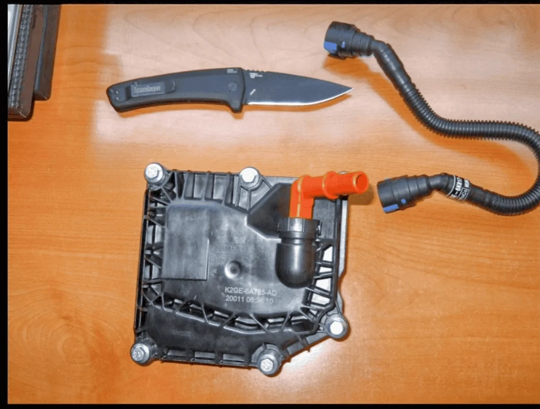

That catch can looks like it barely qualifies as a catch can! I wonder how much testing was done on the design. Emptying it looks to be messy.
BTW, I love the Kershaw Launch 7300BLK knife! Got one just like it!
