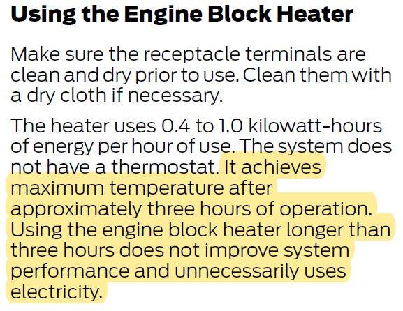

I'm sorry but that simply isn't true of our vehicles. From the Owner's Manual
This is why they should be on a timer
My comment stands correct as written. They are meant to be used over night and in extremely cold conditions. The heater will keep the engine warm as the heat is continually dissipated by the ambient air.
Notice the phrasing from the manual "....approximately 3 hrs" and "0.4 - 1.0 kW-hrs"
Run it for 3 hrs unplug it and in a few hrs the engine will be cold again, its basic thermodynamics.
Did you even read my post that says to put it on a timer so it shuts off just before you're ready to start the vehicle? No time for the coolant to "cool off".
Try it but if you do use a timer be aware it may not be able to handle the current draw.

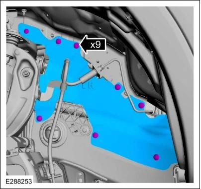

Step 3 of installing the heater element is to remove the fender splash shield. This is the same shield that is removed to R&I the engine oil filter. This splash shield is held in place by several plastic rivets which over time can become hard, brittle, and break. I ordered some extra rivets just in case any get broken. Part # for the rivets is W715694-S300 and is packaged as qty 1.
Lastly, if you're doing this job yourself you going to need to order some of the yellow coolant for top off - either concentrated (VC-13-G) or prediluted (VC-13DL-G).
