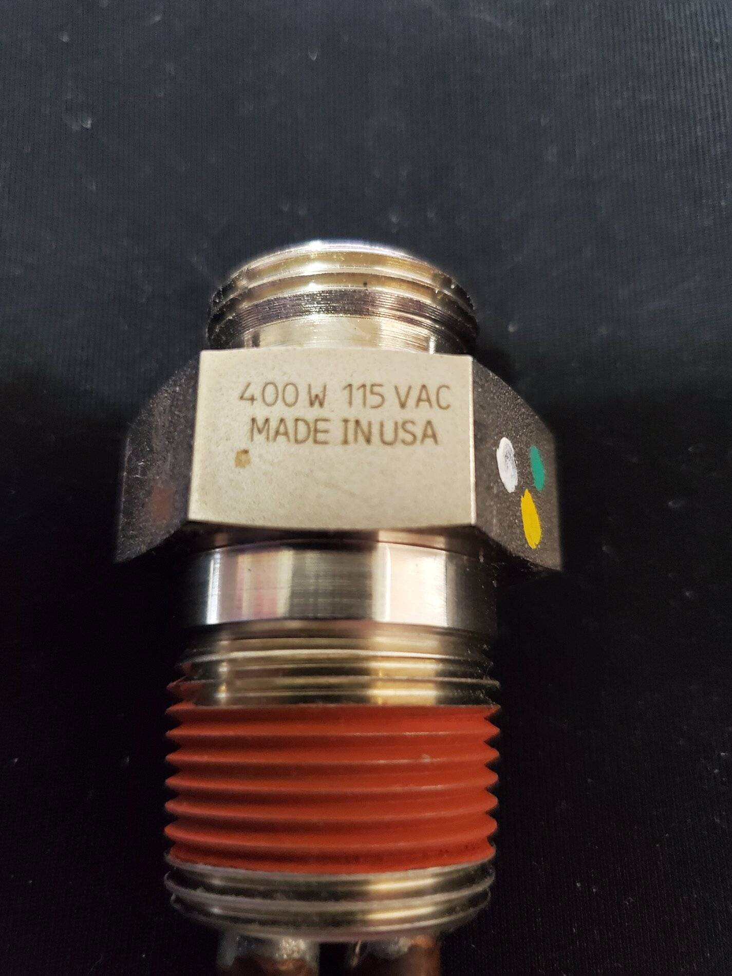

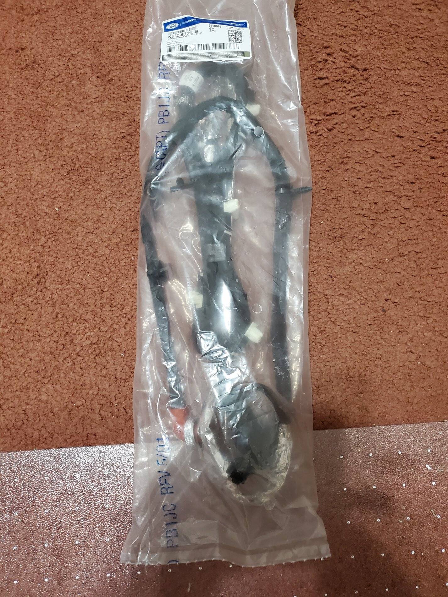

Update...
today the heater element and wire as. arrived.
I was alarmed at how long the wire as. is - 8 to 10 ft. I called my dealer and suggested they contact one of their partner dealers in the north that may have a Ranger on their lot with a block heater, and to send photos of how the wire as. is routed from the factory. They could also contact Ford Tech Support for this information but at any rate, the tech isn't going to stumble his way through the installation and get the routing correct.
Another thing that surprised me was the rating on the heater element. 400 watts at 115 volts. This means the heater element would only draw 3.5 amps from a std household outlet. After giving it some thought, the heater element is only trying to heat 12 qts. of coolant. So I guess it is sized properly.
