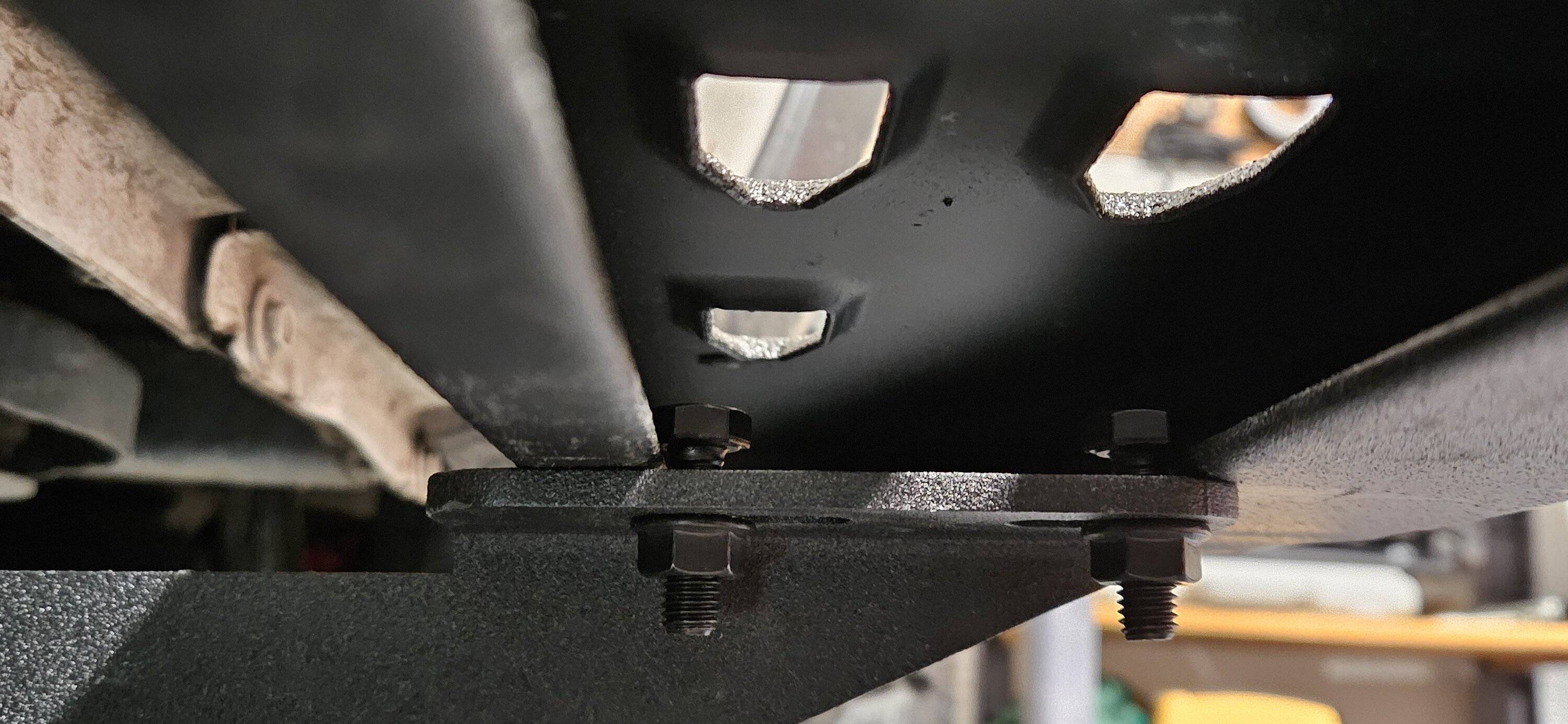

Just got the RB20 Slims...
Is this how the boards attach to the brackets? I didn't get any other hardware and was thinking there would be some type of metal bracket to sandwich inside the board... if this is how they attach, they're going back.. this is a crappy design.
Please let me know if yours are the same or if I'm doing something wrong, nothing else in the boxes.

Looks like you are missing the pieces that go in the channel.

Something definitely looks off. Send them that picture

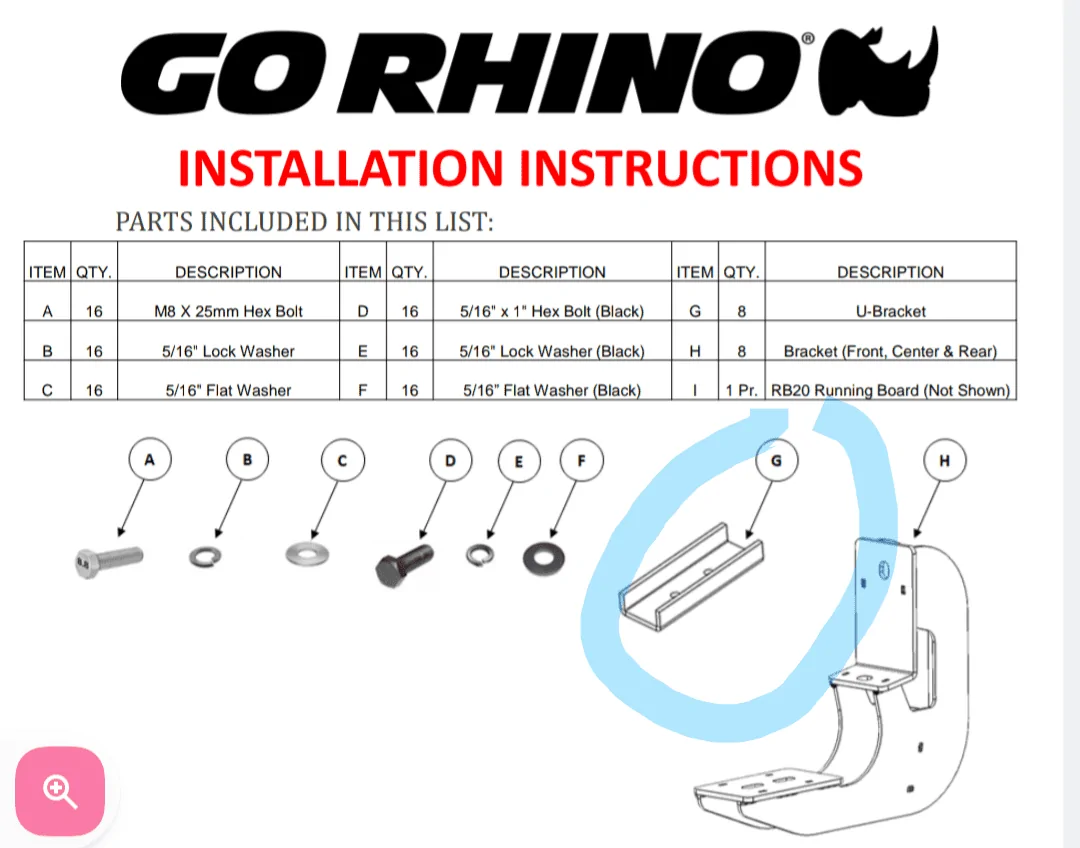

Per the instruction manual there should be a u channel that the bolt goes into...

Sometime it just takes another set (or 25)of eyes :)

From the pic, yes you are missing the U-Channel, I just installed this set 2 weeks ago

You’re missing the U brackets.
