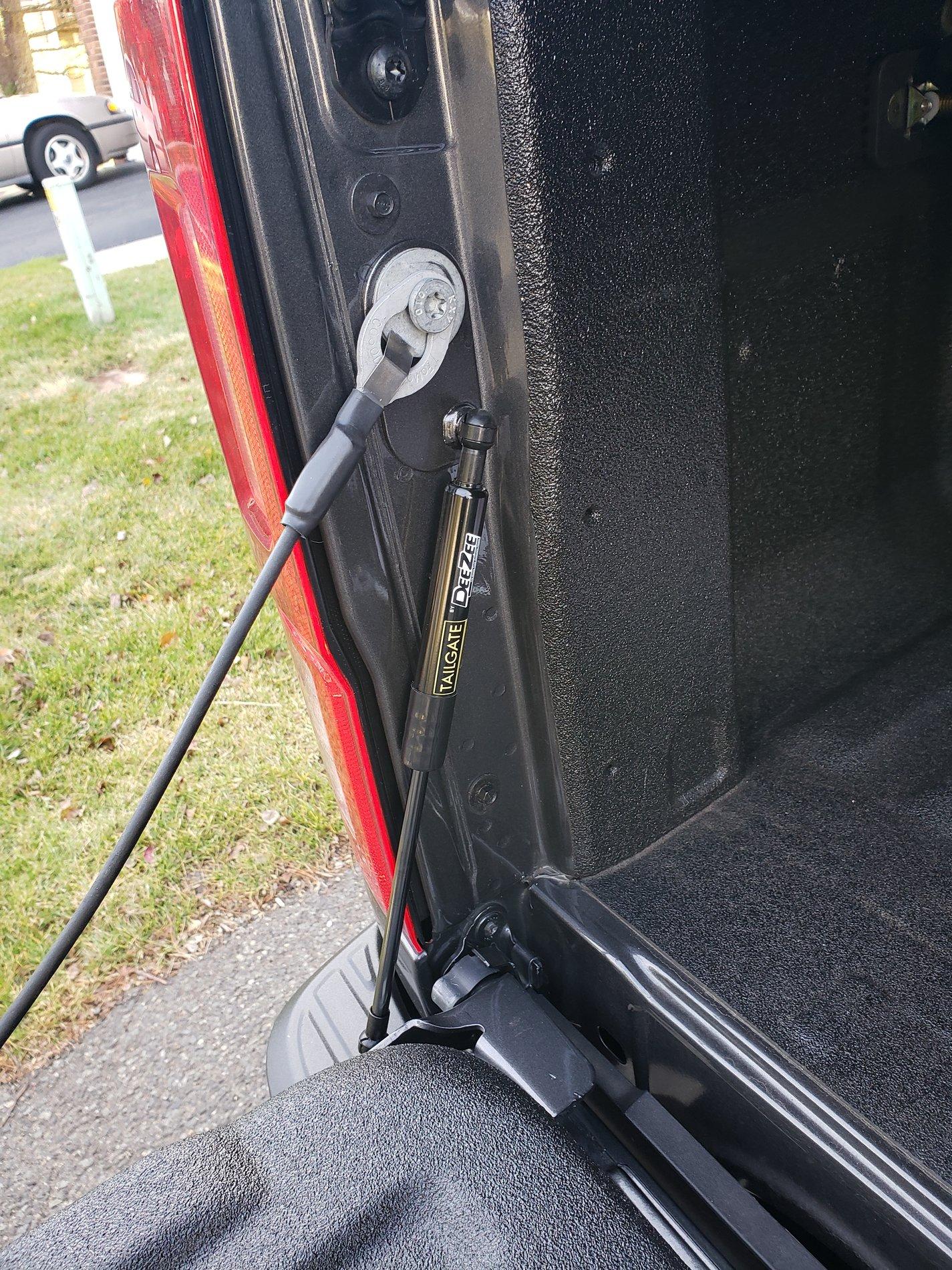

OEM 2019+ Ranger Tailgate Damper Part# VKB3Z-99406A10-A by DeeZee DZ43206
4rd SVT
Nov 22, 2019
246
166
In da Driver's Seat
Ford SVT, Ford Performance, Winter-Beaters
I just ordered the tailgate damper from Levittown Ford (sponsor) for 40.25 and 2 sill plates for $21.86 and free ship cause my order was over $50.
Can post the link with the part numbers for both the tailgate assist kit & the door sills.
I tried searching for the sill plate numbers- looking for the black version.
Tried the Ford part # VKB3Z-99406A10-A for the tailgate assist kit & nothing.
Tried eBay & Amazon using both VKB3Z-99406A10-A & DZ43206.... nothing...

It’s in Ford Accessories, not Ford Parts.
Heres the Damper. https://accessories.ford.com/catalog/product/view/id/12567/s/damper-asy/category/198/
Not sure which sill plates you’re looking fir. Here’s the list page: https://accessories.ford.com/catalogsearch/result/?q=Sill+plates

You can order from Varsity Ford for $40.00.Use code WELCOME at checkout for free shipping. Thanks to @Msfitoy .:like:
https://www.varsityfordparts.com/oem-parts/ford-damper-assembly-vkb3z99406a10a

4RD the part number is correct for the damper in Ford accessories. The F37Z-1013260-A is a sill plate from 80's Ranger that requires slight modification but many here are using. I ordered from Levittown Ford (sponsor here) and you can use code FS2020 for free ship over $50. Good luck Bret

Guessing you cut off the locking tabs & used 3M tape to attach it the truck panel?

Public Service Announcement: Don't be like some of us and assume you have a T50 Torx in your toolbox. I and some others thought they did and you end up running out to get one. I only had up to T45...:)
..:::: BUY A T50 Torx unless you are sure you have one! :::...
This has been a public service announcement! Carry On! :)
I'm cheap so I just borrowed my neighbors. :D
I know I have a full set up to T70 :sunglasses:
I’ve never needed it, but it’s there! Lol

Anybody else having issues getting the factory installed fasteners loose? If not, how difficult was it to replace the original fasteners and is there a trick to it? Mine will not budge and I hate the thought of a service appointment for a 10 minute install.
