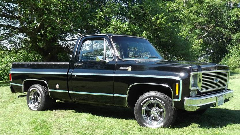

My 1st truck was in '91 or '92 and was a '78 Chevy Scottsdale, looked just like this one, cept had Rally wheels and was how trucks were supposed to be :) I love the Ranger, but it's gotten so civilized, it's become silly, LOL!
