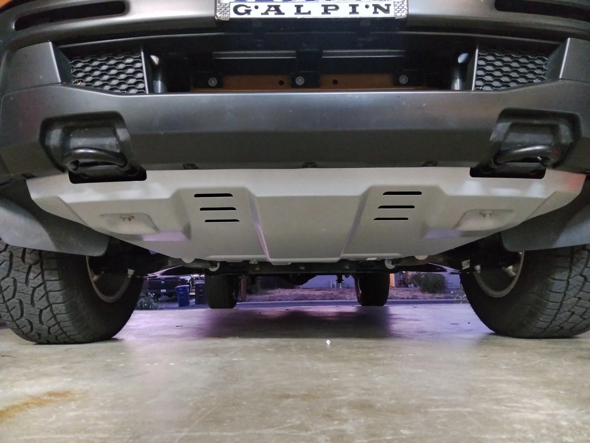

FX2 doesn't come with Skid plates! Just some 1/2 azz piece of plastic that's supposed to look like it has one!
For real Skid(s)- front and trans plate, you'll need 2 4x4 tow hooks- the 2x4 ones don't have the brackets the skid needs to bolt to, and 6 bolts, besides the 2 Plates. There are 2 choices for the plates, the standard, which is less then 100, and the silver, which is around 3. I got the silver, has a little more coverage. FX2 is like a 500 option, main thing it has is the locker. FX shocks are garbage, threw mine in the trash instead of reselling them. Get a FX2 sticker! lol.
KB3Z-17A954-A​
Tow Hook​
$70.64​
2​
$141.28​
KB3Z-5D032-B​
Skid Plate​
$278.54​
1​
$278.54​
W505443-S439​
Inner Bracket Bolt​
$1.38​
6​
$8.28​
KB3Z-5B018-A Front Shield <<< this si the Trans Skid plate, like 30 bucks.

I saw that about the tow hooks right after I posted this. I've also been trying to find a part number for a fuel tank skid plate without any luck. And.... No stickers. ??? I've already removed everything fron the paint that's not bolted in, or have a hole behind it besides the hood protector. Maybe a window decal. ?

Yeah, I can't find the one for the Tank either, or a picture of it.
