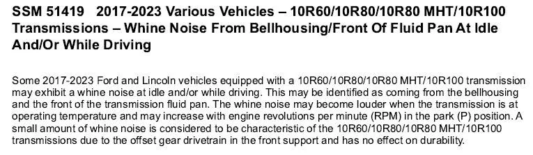

The slight wine noise is - Normal
This is the slight noise you can hear under light throttle from a stop, you can barely hear it, but it is there.
Anything more than this - is a concern
Can't hear it at all in park, has to be in drive, and under acceleration and load. Mine is more of a grind/whine not sure what to call it but I know how to describe it.
Picture the noise a bearing makes that isn't properly lubricated...
That.
Apparently it's coming from my trans. Crazy part is if I ease off the throttle a touch it'll usually stop.
Either way getting swapped ??‍♂
