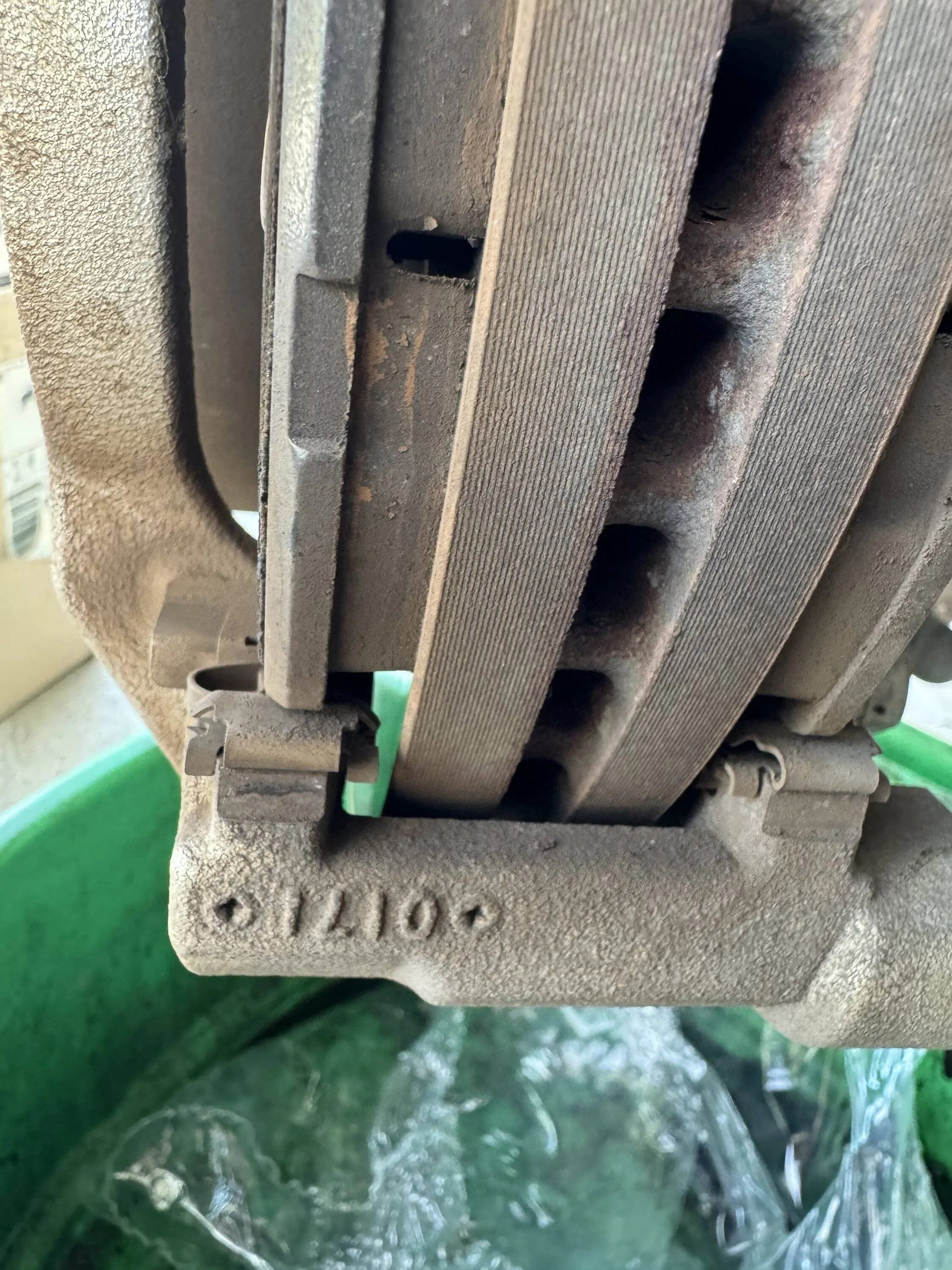

I'm at 64200 KM (40,000 miles) I had to do rear brakes today. Admittedly I have a heavy foot, I drive fast and brake heavy as a result. I also have a heavy truck, with full steel skids plates throughout, steel sliders, steel front bumper, winch, bigger tires, and they are 8 ply. I also have a tonneau cover, roof rack, and carry more tools and recovery gear than average. Al this adds up to expectation of higher brake wear.
With that said, I have never had a vehicle the wears rear pads out before front pads. I will have my front tires off tomorrow to see what they have left, and will compare pad size as well.

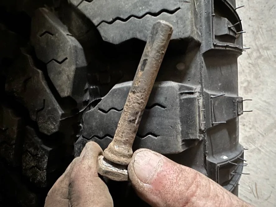

One thing I found today was the driver's lower caliper slide pin was rusted almost solid, which is the root cause for my immediate need for brakes. That resulted in my caliper canting, the pads wearing uneven, and the warning bar rubbing. The leading edge was worn almost right to the metal (another few days would have been rotor damage). The trailing (top) edge was still 15-20% available. The boot has a small hole on the bottom, which looks like it was caused by a pinch. That allowed the grease o be pumped out. I also off-road and have many times been in water deep enough to submerge the entire wheel. There was no other damage, no signs of impact, and considering the location of where the mount it, I don't find it highly likely to be caused by me, but also recognize that being directly on the bottom, and my truck being 2.5 years old, I realize it's as likely as it is to be a factory fault.
Over all, both outside pads are only about 65-70% worn. The passenger inner pad is 80% worn. If not for the bad slider pin, I think I would have gotten another 5-10K miles before they would have hit the warning bars.
Rear pads were $115 CDN, none of the aftermarket parts stores had any options. There was only one local dealer with 1 set of pads in stock and they told me they were weeks to months back-ordered just a few months ago.
The new caliper mounting bracket is $190 CDN, picking it up in the morning and installing it tomorrow.
