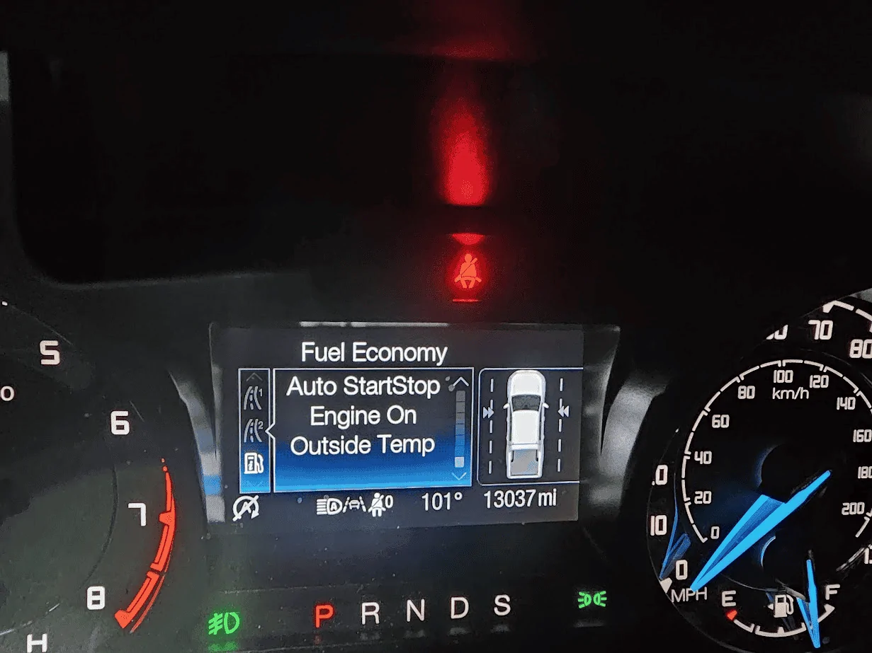

Yeah, you can look in the instrument panel, I think under fuel economy (but not 100%) and it will show why ASS may be off. Probably says off due to charging, which points to the short trips or bad battery.
If I recall, some of the new trucks had it deleted because of the chip shortage?
This is correct. If you go into the fuel economy menu and scroll up/down you will find the current status of the ASS. It will tell you why it isn't activating when you are at a stop and thinking it should.

Just thought of it but my Ranger has not shut off at a stop light for over one year now . Not complaining just do not get it . Maybe because 90 percent of my driving is short trips . Believe me I am happy ! Any ideas ? Also no device is charging in ac plug .
This Screen on your Fuel Economy Section will give you a basic idea of what is happening. It will change while driving and show what condition might be keeping it from shutting off. Mine shows system charging or Outside Temp during the summer.
