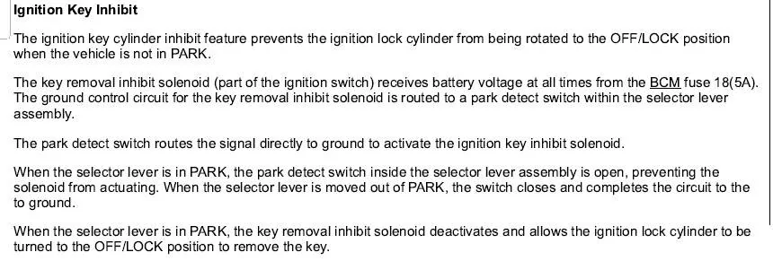

The Ranger has this:

good to know
i was making the assumption he was in the off position.
