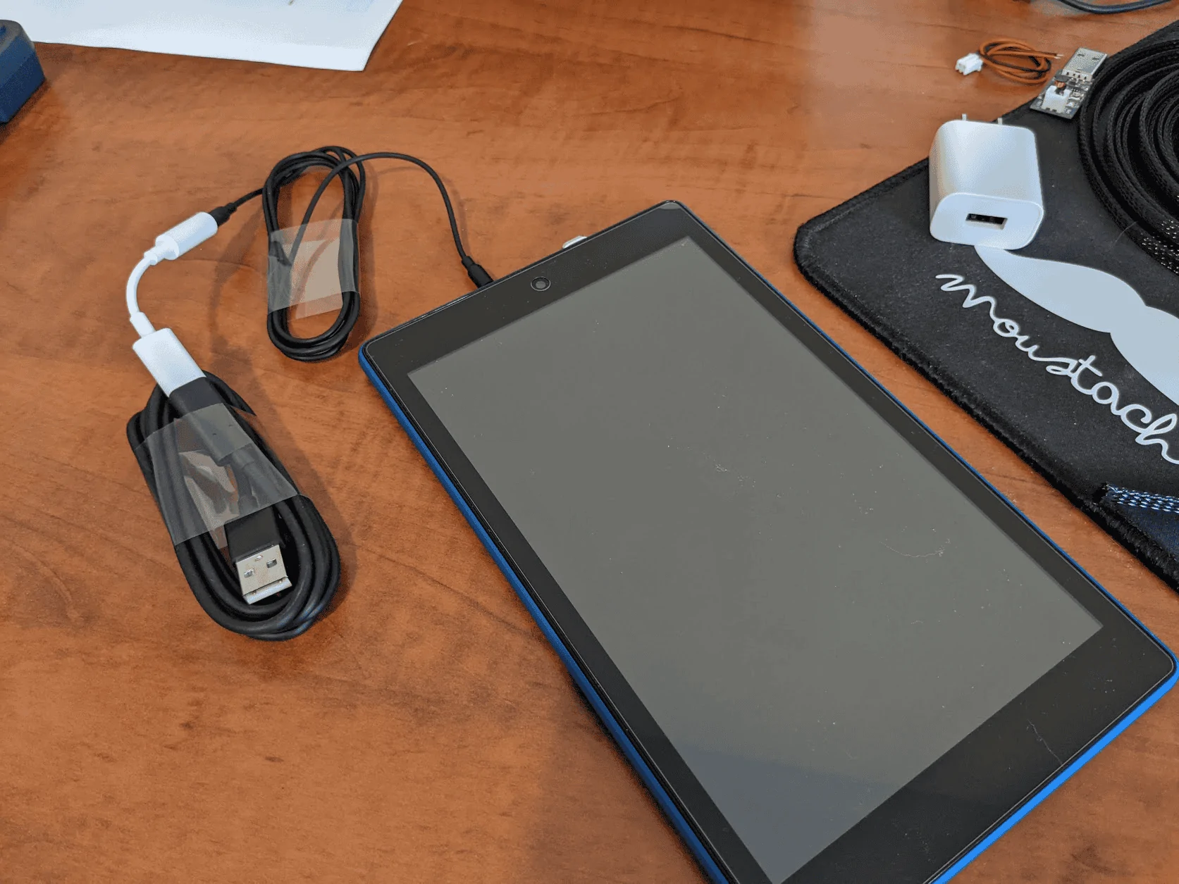

I found something that outputs 3.5m so I am going to try this gross combination of cables and see if it works with SYNC :D
TechnicallyReal
Ryan
Aug 20, 2020
460
606
Eh?
'19 Ranger Lariat 4x4
Software Engineer / IT Admin
No luck. SYNC says the USB device is not recognized. I wonder what the expensive Naviks adapter does differently.

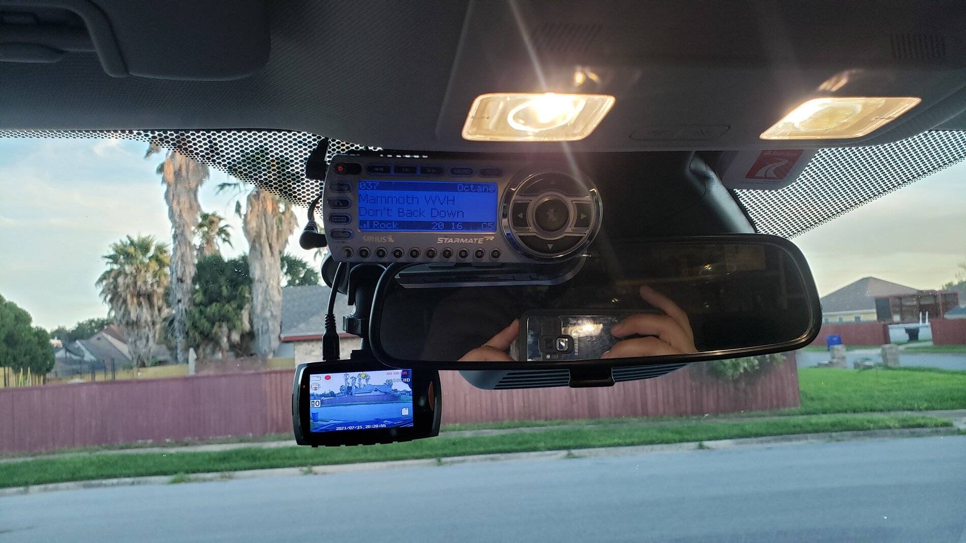

Ok, i have had sirius radio since the early 2000s. Since the plug and play sirius devices. When the NASCAR channel was not a channel and only a show from 2 to 6 central time. So i have 4 devices that play siriusxm as it is called now. I do not pay a dime for it! Yay! So the trial ended on my Ranger, I have my favorite radio installed on the Ranger. But no aux cord, and the fm transmitter feature has a lot of static. These devices are not linked to an account, as far as I know, and have been giving me free radio for about 7 years now. I used to pay. But came to find out, no aux cord, and the sirius people can not beat free for satellite radio. Need the aux cord solution. This pickup does not have it......ha...ha. jokes on me.cheaper to pay a lifetime subscription than pay for the novik device. So looking for the cheap solution to have clear and loud liquid metal, and Dave moody on the radio again. So I will try the devices i ordered for Tuesday and see what works

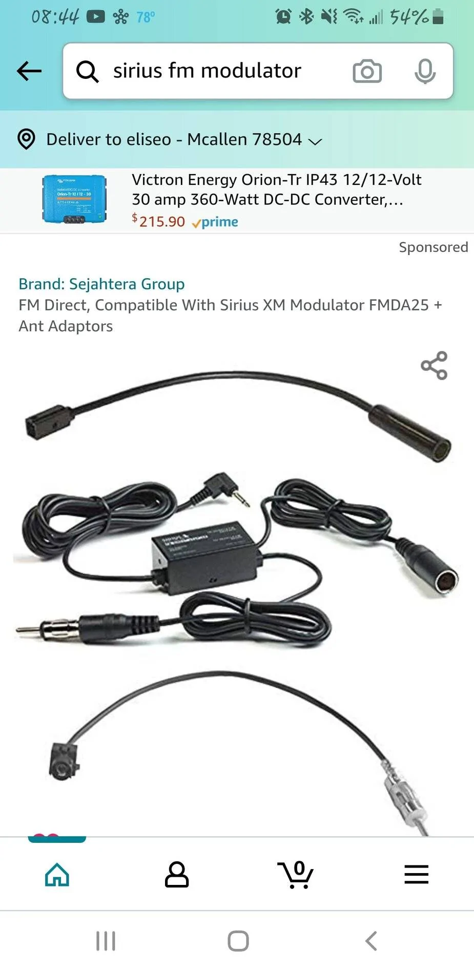

Thanks, found the fm modulator for the plug and play devices. No adapters needed just plug and play.

Ok. Update. Jul 20, 2021
None of the devices worked.
Not recognized by usb sync.
The novik harness or the fm modulator. Going with fm modulator next.
The first one should work if you have it setup as a Bluetooth transmitter. USB should only be used for power, not for passing the music over. That's what the Bluetooth part is for.
Basically, you power the transmitter using a USB port. You pair the transmitter to SYNC like a phone. And you feed the transmitter using the AUX cable. To listen to the music you would set SYNC to the Bluetooth audio source (not AUX)
The second one won't work as it does everything in the opposite direction (for vehicles with AUX but without Bluetooth).
Not sure what the third one is. Got a link to that one?

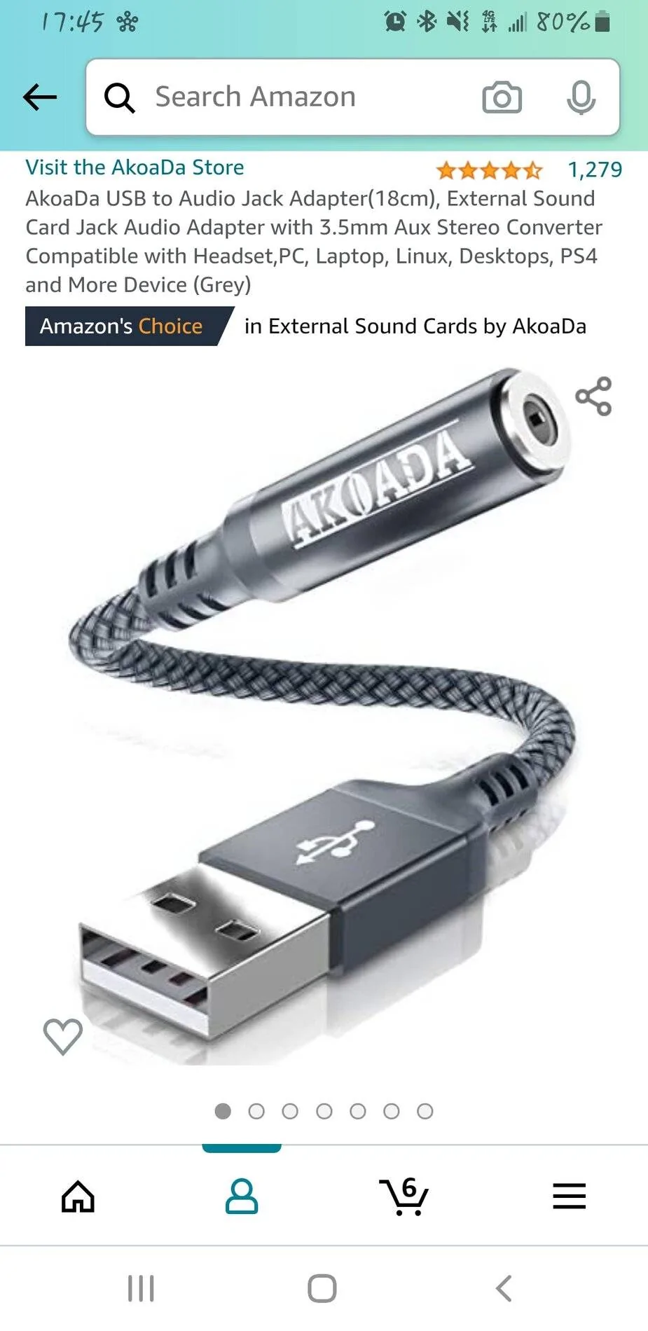

This is the third one. The first 2 devices did not work. They attempted to connect, and connected, but i was then told by sync that it had no features that would work with sync.
Hence, no connection. So it recognized the bluetooth device, then rejected the devices. The aux cord to usb was nothing more than a conversion cable. Again, sync did not recognize it. So......Amazon music it is. Or iheart radio. Or deal with the fm transmitter on the siriusxm radio sounding like a far away radio station.
The fm modulator is my last ditch effort.
