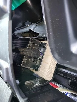

I agree, I barely touched the gain adjustments for big swings. I found the high spot on volume to be around 19-20 on the sync dial. I did the Kicker microphone self adjustment too and have been pretty happy with it. I added the amp about a week after I changed out the speakers and although the speakers alone were a big difference, the amp was another world. I strapped my amp up behind here so it is easy for me to get to to make adjustments if I need to .

Behind the dash, above the glovebox, there is a steel bar that already has 2 holes .. perfect to run a few screws into the wood base to which my amp is mounted. You do need to disconnect the glove box assist damper cable. It was a struggle to reconnect.
