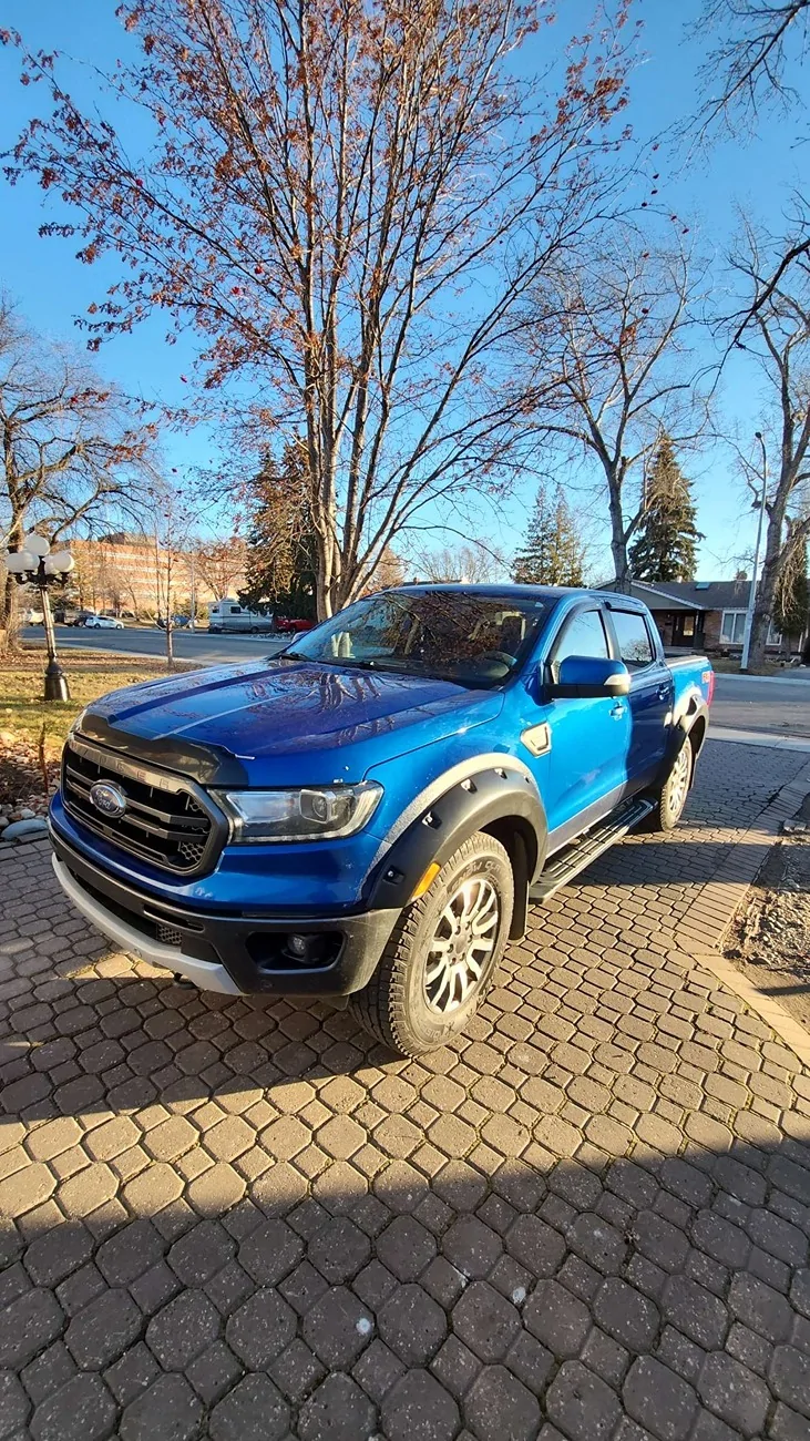

Hello everyone,
I picked up a 2019 Ranger Lariat in the fall of 2025. I've really been enjoying this little truck so far. This is my very first ranger, and truck in general. I'd like to get some longevity out of this thing and be able to take it on many winter and summer adventures. Looking for general info on a few different things, here goes.
1. I put some nice 18inch winter tires on since im up in the land of snow 8 months of the year. That being said I had to remove my front mudflaps since the tires were rubbing ( specifically on the screw heads) when I was steering. They still rub slightly but only when im fully turning the steering wheel, other than smaller tires is there a good solution for this? I am also looking for thinner mudflap solutions or reputable brands for that sort of thing, I would like to have something back on to prevent the slush and mud flinging down the running boards. She came with aftermarket fender flares that I quite enjoy the look of so I need a specific shape to tie into that extened width as well.
2. Speaking of the fender flares. Looking straight on from the front, the bumper is about 2 inches thinner than the fender flares and to me it looks a little silly, other than replacing the entire bumper, is there a solution for this?
3. The gaping hole in the front bumper... what are some good lightbar, or other solutions to fill that void?
4. I am thinking of getting some 17" summer tires and rims, any suggestions on good summer tires for light off roading and camping/ adventuring would be wonderful.
5. If anyone has any knowledge on general things to watch out for, or aftermarket parts that add to a better experience with these trucks, let me know!
I intend to use this as a daily but also an adventure rig, lots of hikes, camping, and trips for snowboarding. If you have any tips and things you'd like to share, please dont hesitate. Thanks! :)

BLUUUUUUUUE! ONE OF US!
I'm so relatively new to the Ranger club too so take everything I say with a grain of salt.
1. Best bet to resolve rubbing is probably some sort of level/lift. I’m not sure what you mean by 18 inch tires. Do you have the tire number? Mines 265/65/R18 for example. I think off-road tires are numbered differently though.
2. I think a good option is getting wheels with a smaller offset, so they stick out a bit further. Wheel spacers are an option but I’ve never had them and they seem to be generally frowned upon.
3. No idea
4. BFG KO3s might be a good bet. I had them on my F150 and like them. They’re a bit heavy though. I have Cooper Road+Trail on my Ranger now and I also like them but definitely less aggressive.
5. Everything I see is watch the transmission. I’m planing to add the MBS dipstick with a new pan, an early fluid change and a new transmission pan. Otherwise, suspension is mediocre and I’m also planing on changing that out. Defer to the experts here for everything else!
Sounds like we have similar plans! Can’t wait to see what you end up doing!

Welcome to the forum! Spend enough time browsing and you'll develop a list of things to check or anticipate.
And what you can do yourself to update or upgrade. I believe real truck folks are resourceful on top of practical people. Those flares scream for different wheels, I guess the previous owner put the stockers back on when they sold it.
That blue sure is nice.

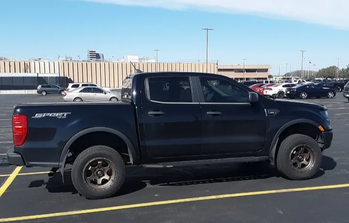

Nice truck. Welcome to the forum and the Ranger club lol. I have Bilstein 5100s and the fronts set at 1.8 to level it and 17x9 Fuel Shok wheels with the +20 offset on the stock size Goodyear Wrangler ATs.
Here is a picture of my truck. Maybe it will help you with your wheel and tire options.
