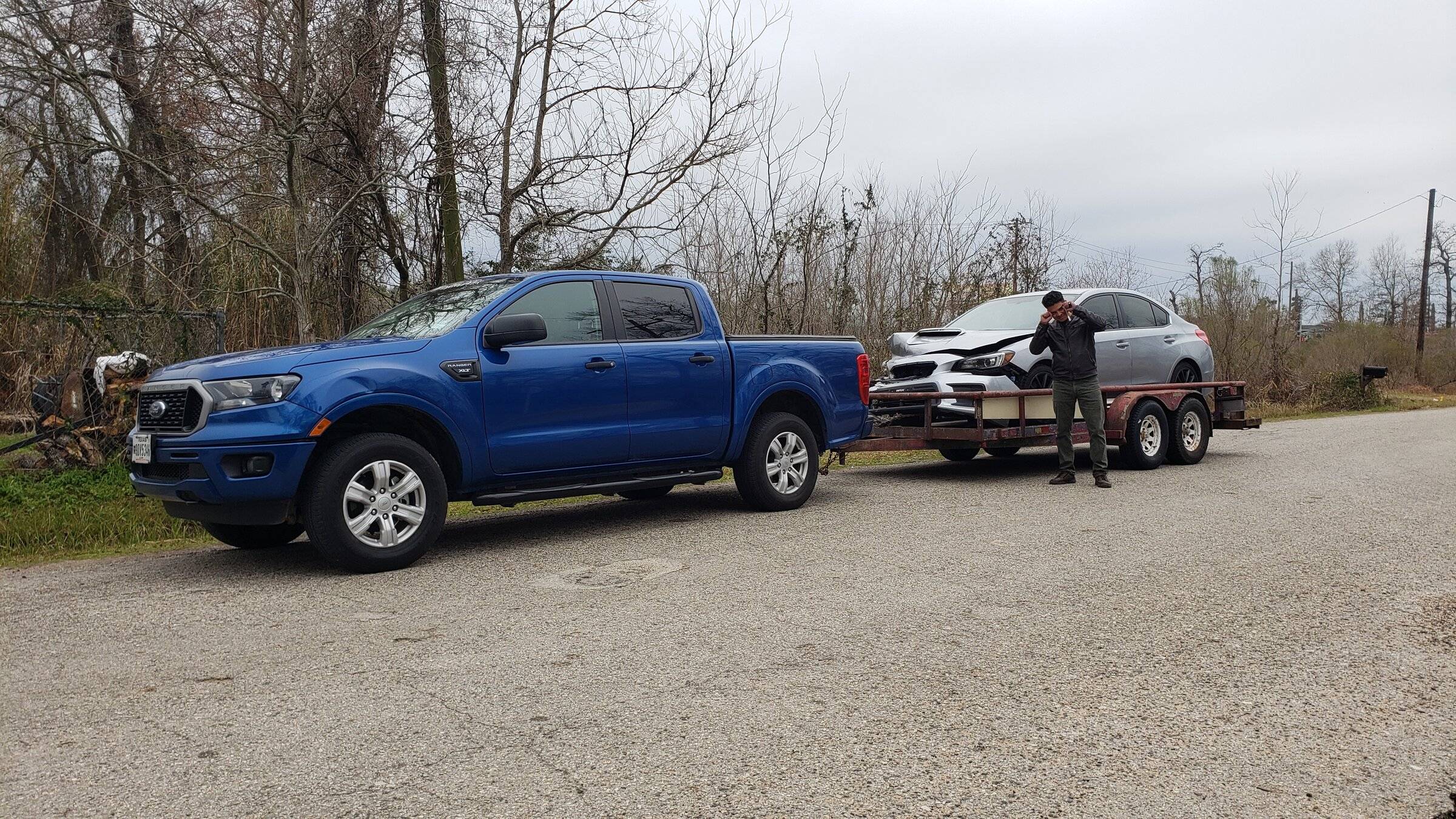

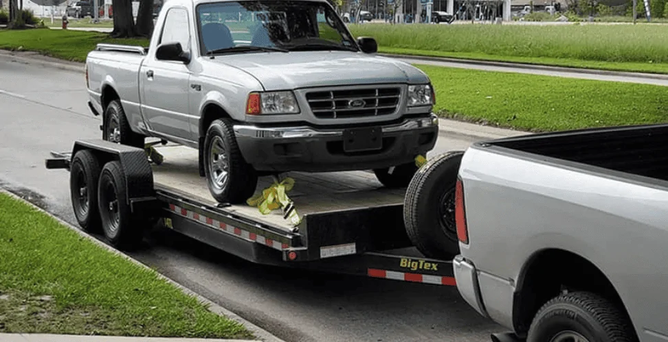

Disappointed its not a new ford ranger doing the tow
2300lb trailer plus 4500lb truck
6800lb tow, gen-y adjustable hitch, ranger can do it!!
