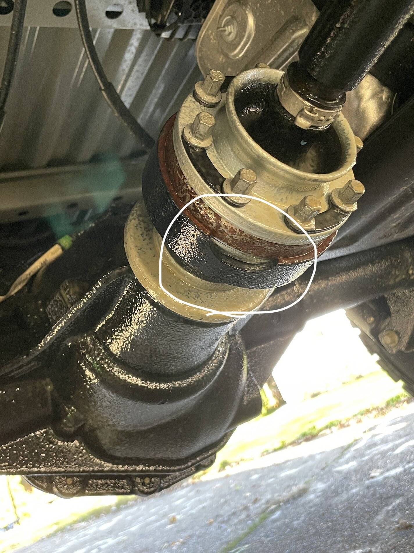

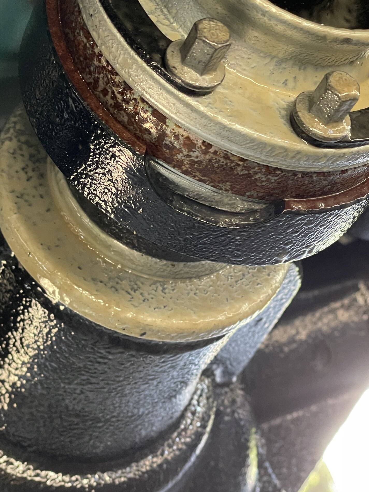

First a foremost forgive my mechanical ignorance on this one if it’s normal. I was under my truck today doing a fluid film application before salt season gets here. I noticed what looked like a little chunk of metal missing near the rear driveshaft. Is this normal? Is that notch supposed to be like that? I have a 21 tremor.

First of all that is the rear CV joint that the tremors have in place of the rear U-joint. Yes it does look like a normal machined notch.

I was under my truck earlier.Yes mine has the same notch !

That notch makes it easier to get the driveshaft on/off.
