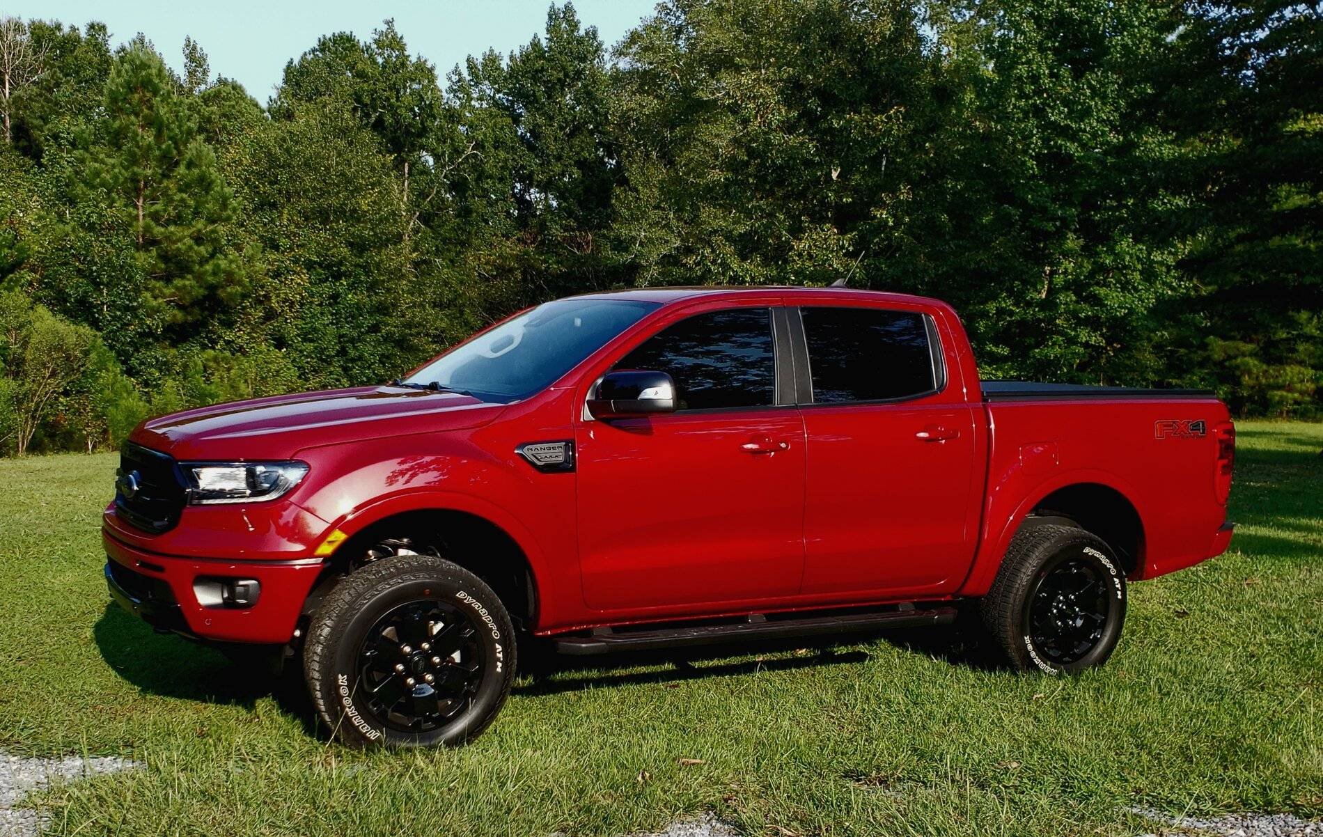

Well I've had bad luck since getting the 2020 a few weeks ago . Leveled her out then went to get alignment and the rear bumper was damaged . Parts on backorder for that so just in a holding pattern to get repaired . Today the drivers side CV started clicking and is leaking grease badly . Have been driving OK since the level kit was installed but I know this was my fault so just took to mechanic to get repaired on my dime . NO part to be found anywhere , Uggggh ! Most places say national backorder until at least Oct 20th and then it's a matter of how many orders are in front of mine :(
If anyone knows where to find a new or used drivers side front axle for a 2020 crew cab FX4 Lariat Ranger please let me know . I can find several for 2019 or even a 2020 XL/XLT but they all tell me they will not work on the 2020 Lariat .
