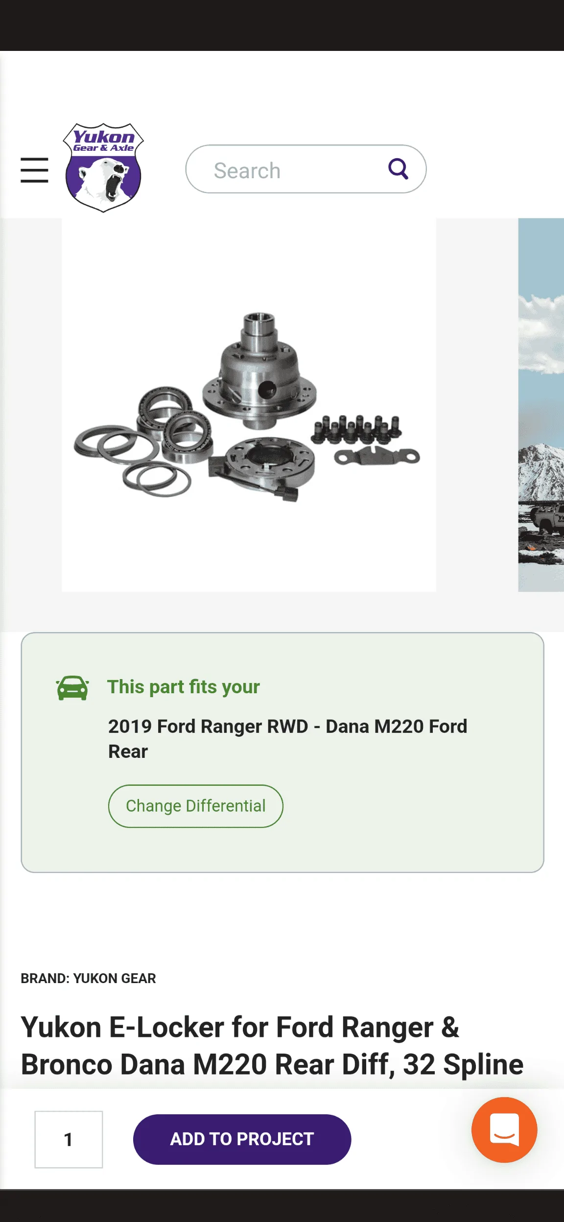

Went to the Yukon site and they have the factory elocker for sale and it states 32 spline so I guess that means I have 32 spline axles since I have the elocker.
I'm starting my off-road racing next month and at a rally track and will keep the stock housing for now with abs disabled to be able to get sideways in the dirt. I'll upgrade to a 9 inch when I can. I'm currently fabricating +5 control arms and a bed cage for the truck so this is definitely not a priority.or in the budget.
