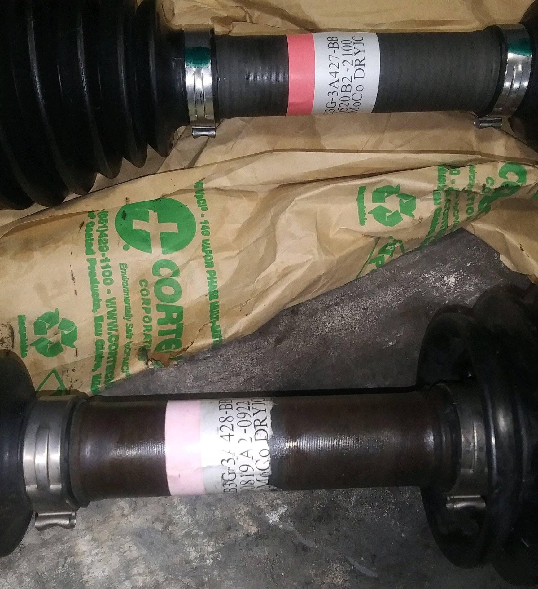

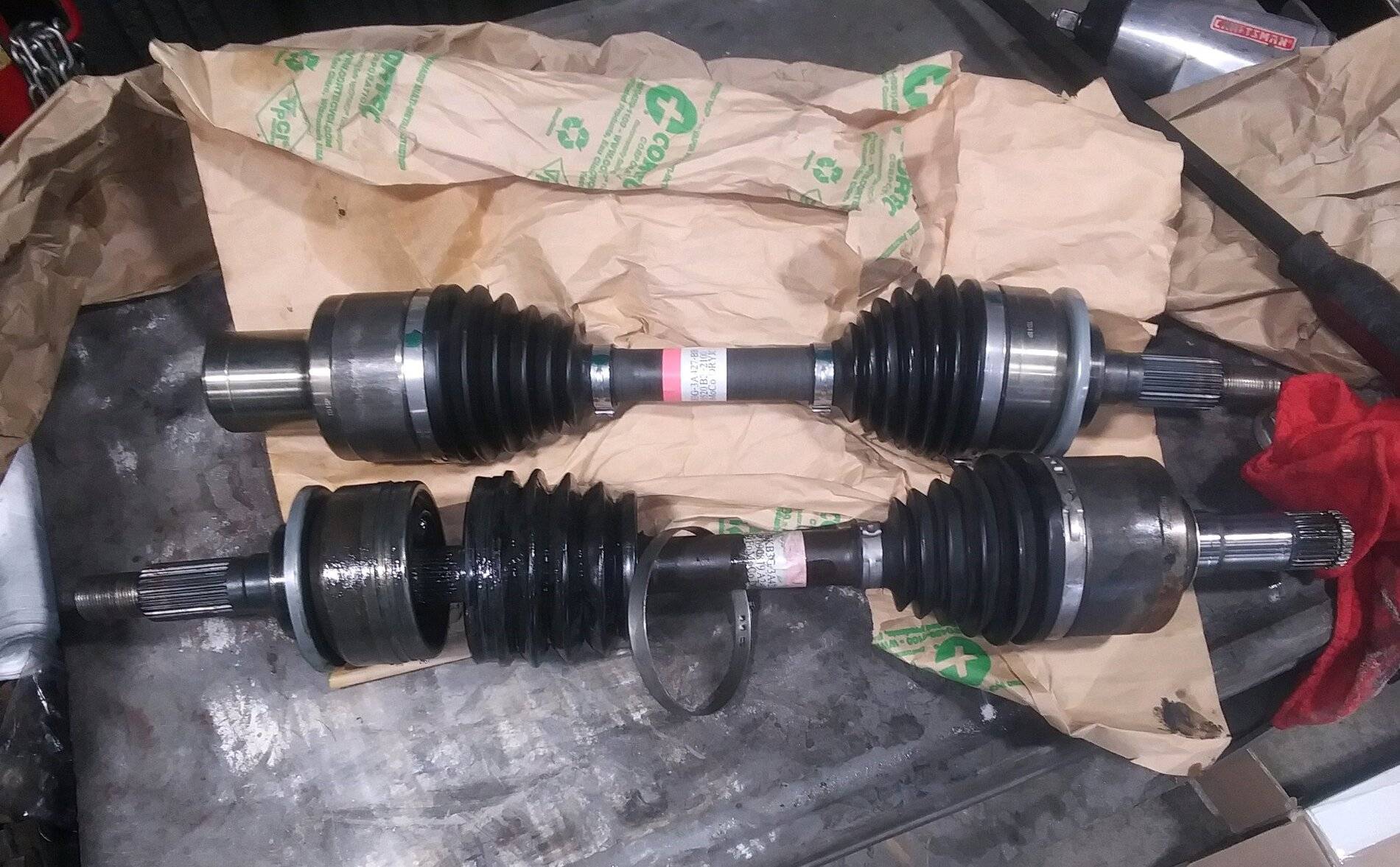

Benny was a great help and located a part but it is the wrong one .
The part that keeps getting shipped is for the passenger side . My repair shop ordered one 3 weeks ago out of Atlanta and the last one I ordered from the link Benny provided was listed as a leftside but when they come in they are the shorter one for the passenger side .
# KB3G-3A427-BB , but my broken axle is a # KB3G-3A428-BB . The passenger side only has one splined shaft sticking out where the 428 has a splined shaft from both ends . My part says KB3G-3A428-BB .
Are they referring to the part as looking from the front of the truck or are they listing it incorrectly ? We have specified a drivers side when ordering .
I'd hate to wait on this backorder and it still come in as the passenger side .

I'm not sure but whenever I give them my VIN # every used place says it will not fit .
Even the Ford dealerships that I have ordered a new part from don't know what is what . Here are pics of the new part I have been sent twice and my old broken part . When you look at the Ford Part sites they show the #427 as the left side with towing pkg but mine is a #428 which the sites list as the right side.

I thought I would give an update to my delimma .
On Friday I visited the large dealer that my Bronco and Lightening are reserved thru and the parts manager tried to help me with the Ranger debacle . He found out the system now shows the CV shaft is on national backorder until late November and it list the reason as "Excessive Demand" , whatever that means . Also the 2 parts that I thought I had found but were the wrong side (in the correct box) when they came in is due to some # changing by Ford in its parts system . The left side CV was a # KB3G-3A428-BB . The "G" is an engineering designation and that letter changes to a "Z" in the parts book . The right side was and still is a # KB3Z-3A427-BB . Ford however , changed the left side part # from 428 to KB3Z-3A427-B . To make matters worse they have the CAD drawing and descriptions flipped flopped in his book . What is shown to be the right side is listed as the left side in the description .
Hopefully they have all this figured out when the new batch starts shipping but no one could offer any assurance that it would be :(
