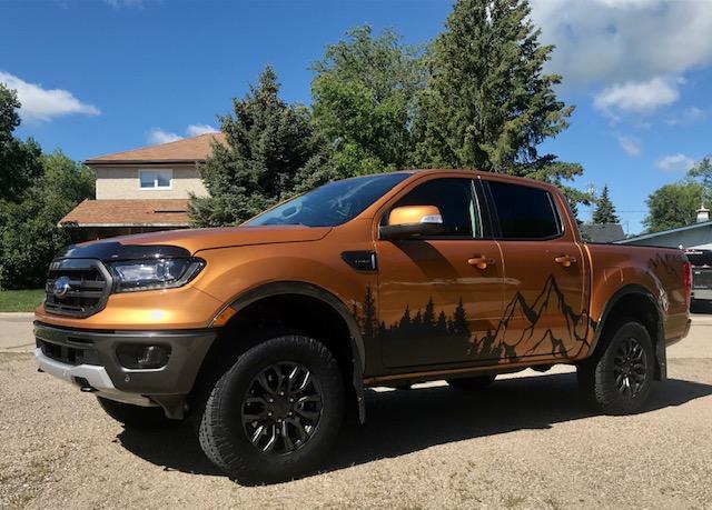

I have the BDS lift in my 20' FX4 Sport Ranger Crew. I love the kit! Made the truck look more like a "truck" in my mind as I couldn't stand the front rake. Install took me 1.5 hours in my garage on a Sunday Morning ( Journey man Tech ) I had the front end alignment corrected immediately(toe). Suspension travel seems to be the same, haven't bottomed it yet. Ride quality is no different than it was, however I installed the kit immediately and had less than 30Km on it myself. I went with the BDS kit as I was concerned about the amount of Stress on the upper strut mount studs with a 2" spacer at the top. I like how the BDS kit splits the lift between the 2 positions.

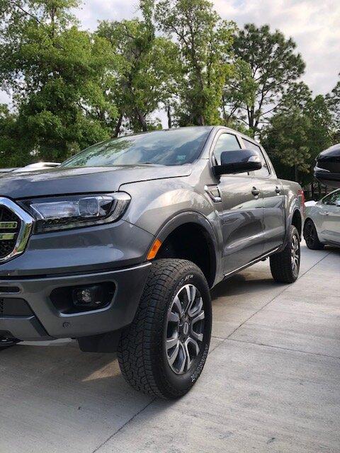

Did you have any issues installing the preload spacers on your truck? Mine wouldn't fit down the body of the shock, I even got it ripping hot with a heat gun and still no dice.

Welp... im thinking it was an issue with the shock bodies. The lip at the top was 0.002 inches too wide, but the body itself was 0.010 smaller than the spacer. Guess it was just a freak occurrence. I'm thinking of going with the readylift kit, since it uses a spacer on the top and bottom of the strut rather than the pre load space on the shock.
