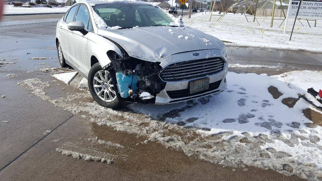

Glad everyone is ok. I had a lady make a left in front of me an this happened. They didn't total it but it was $5400 for the repairs. I'm not usually a big fan of fixing a car after a serious hit but the air bags didn't pop, radiator an AC were untouched. I traded it in about a year later. I couldn't tell anything had been changed. If she were a little slower or turned a little later I think the radiator might have be destroyed an that might have pushed the repairs high enough to total it.
With the replacement costs of vehicles now I would prefer to repair damage as small as the OP has VS dealing with no selection an premium pricing.

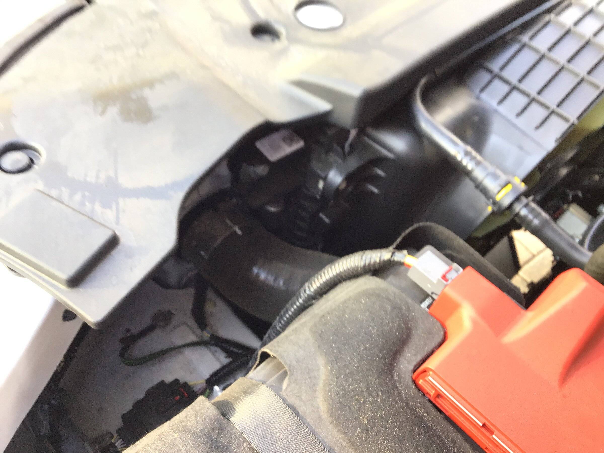

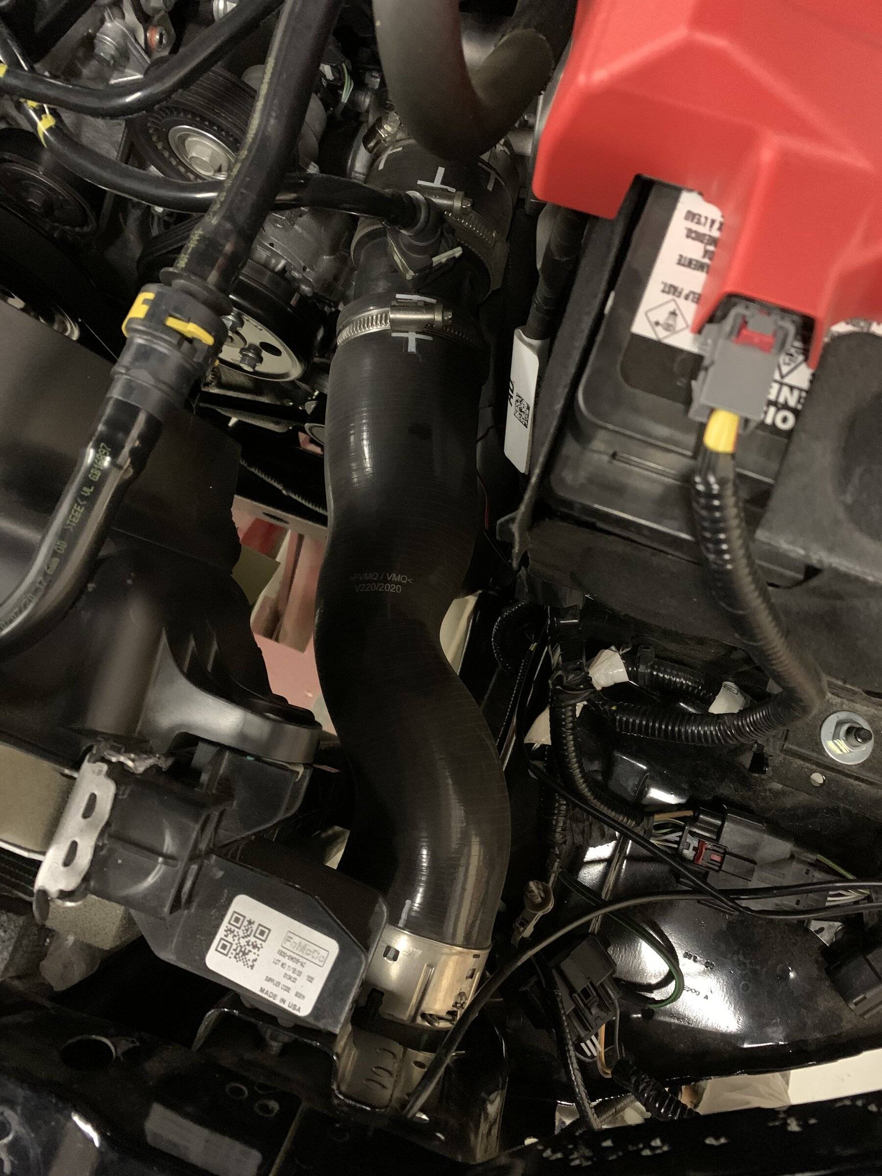

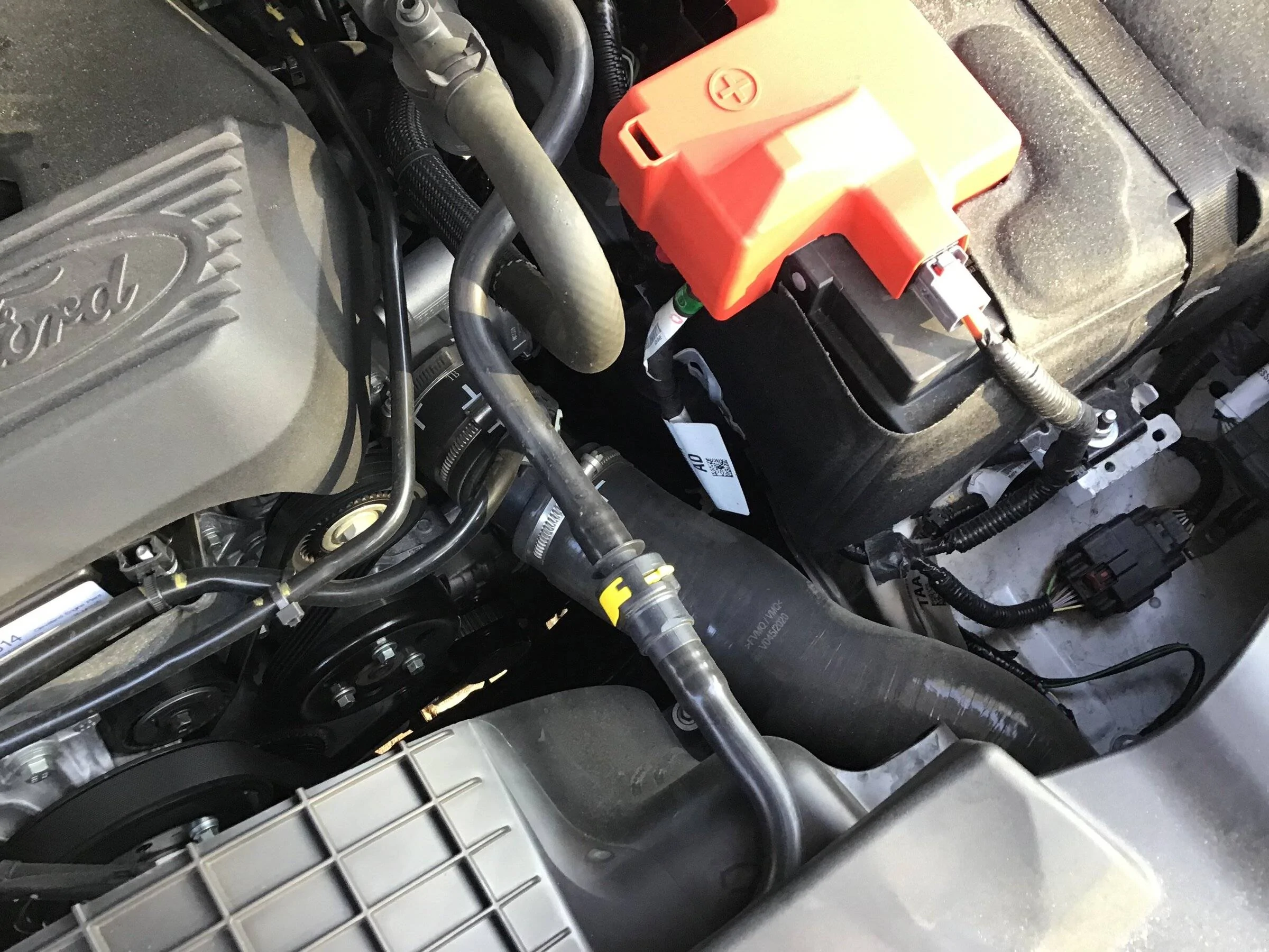

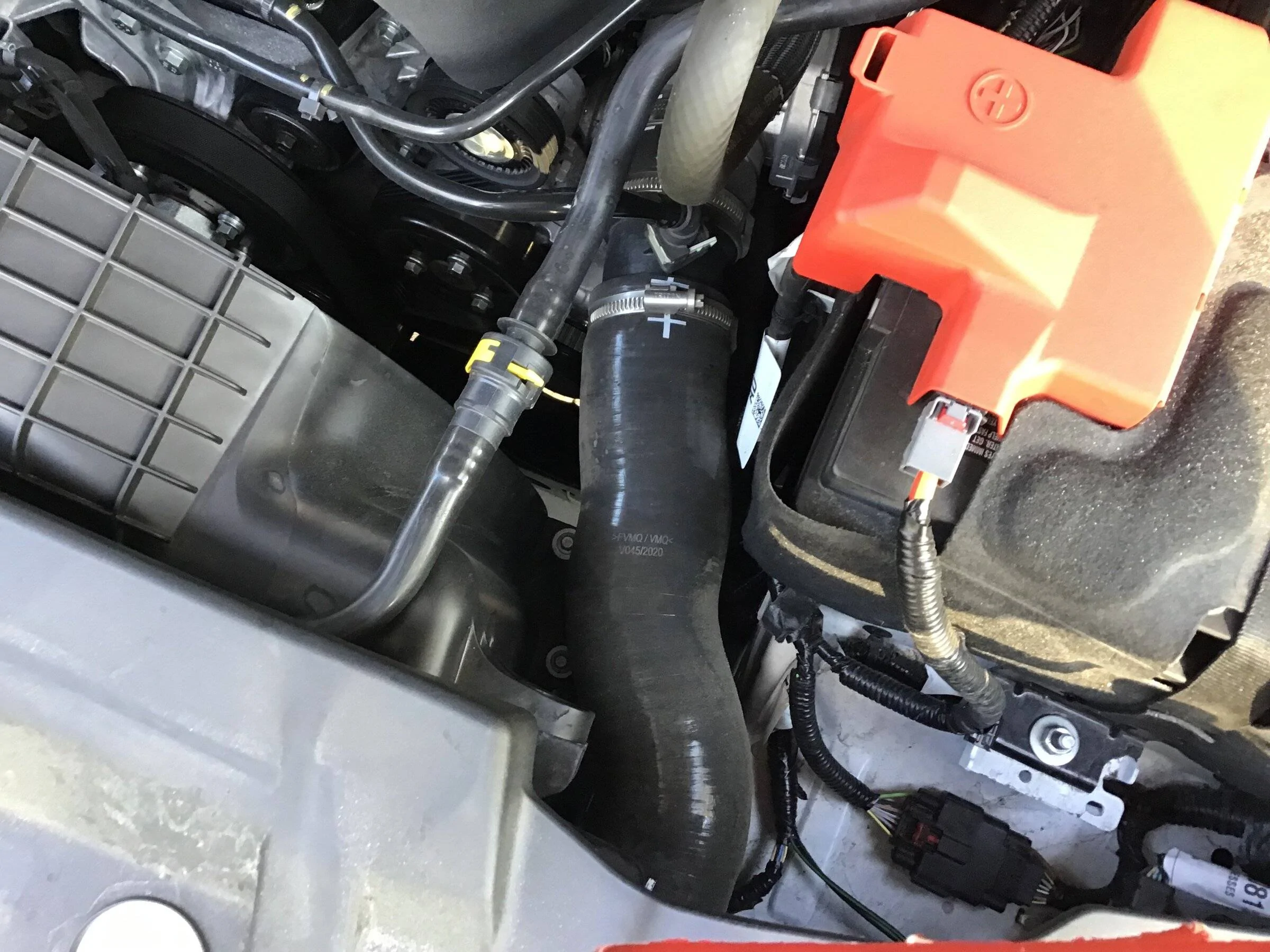

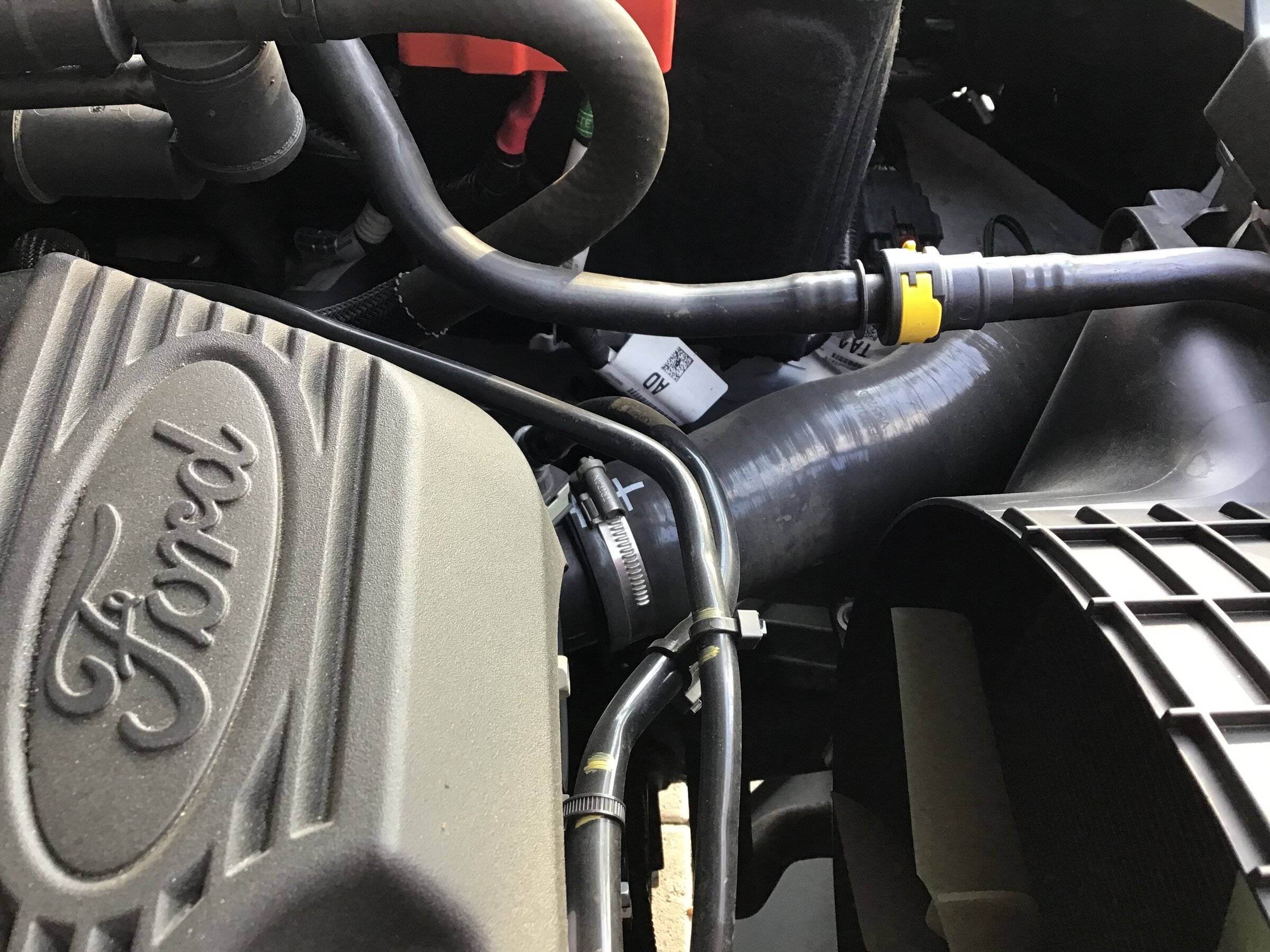

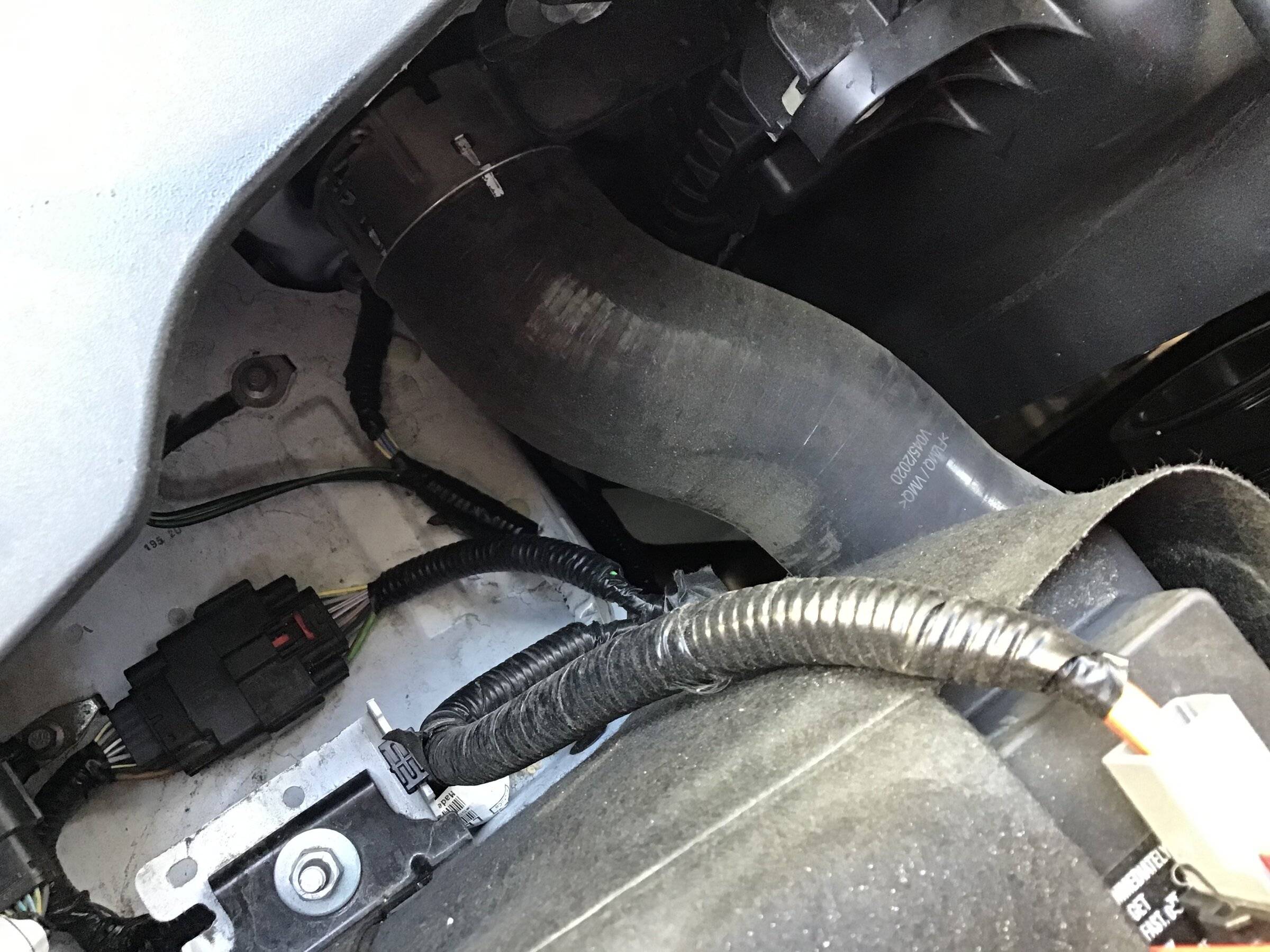

Would anyone mind snapping a picture under your hood looking right down at the inter cooler ductwork right beside the battery? My other parameters are checking out but this bend just doesn’t look right to me.

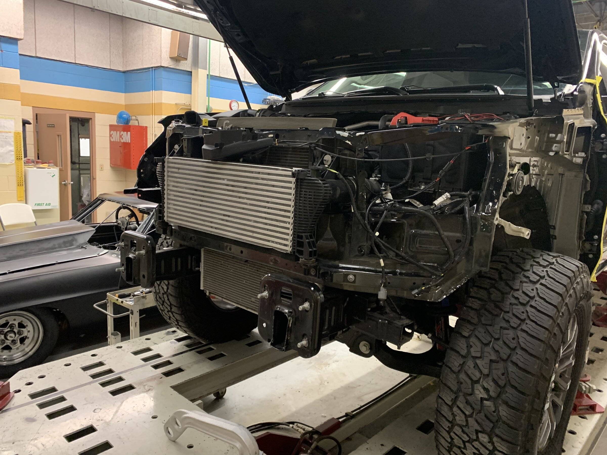

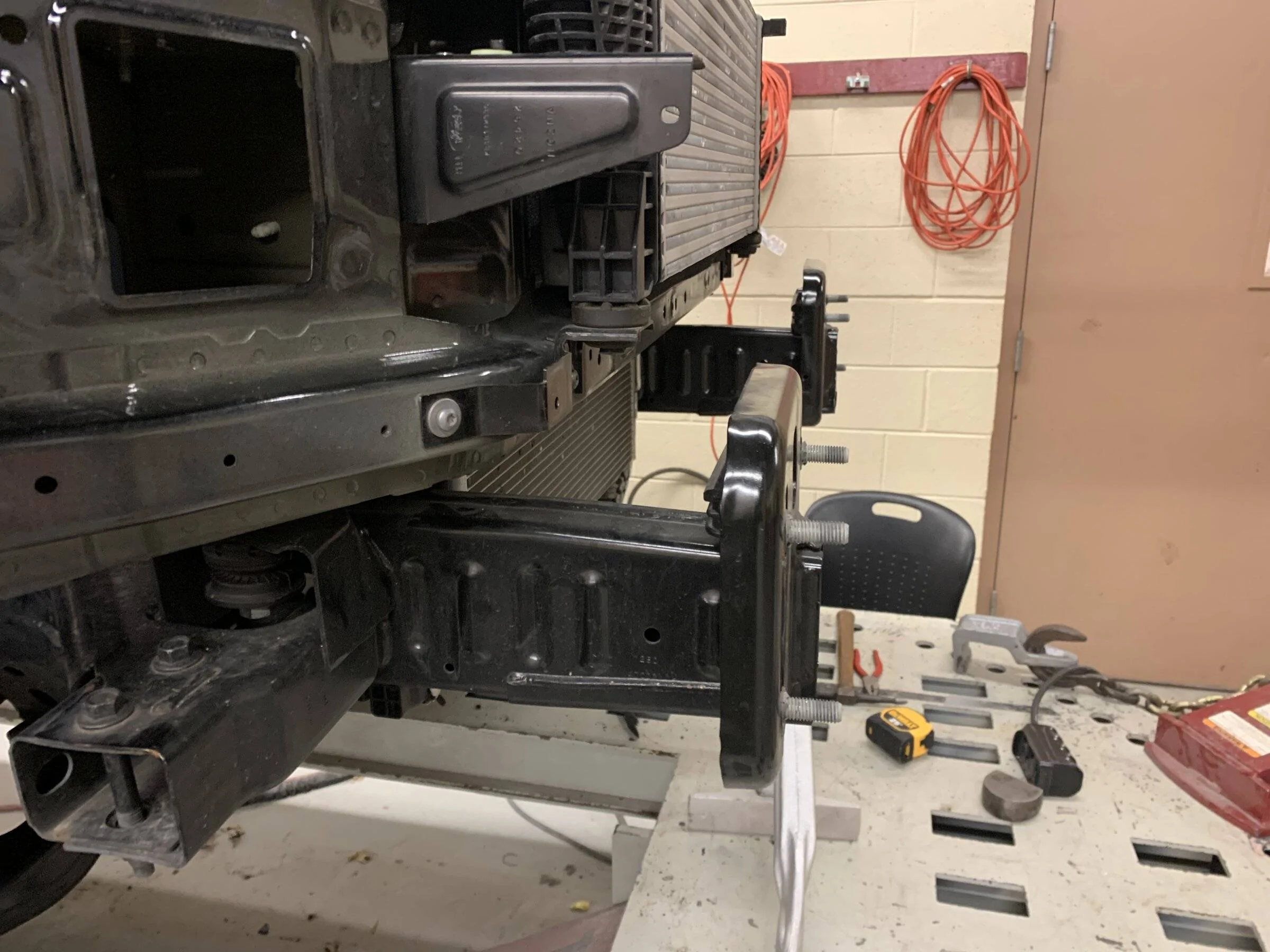

All frame and radiator core support pulling is complete and back into specs. As a new parts go back on will further tell the tale that everything is exactly where it supposed to be again. Just impatiently waiting for $6400 in new parts now. Yes that’s Just parts, Some upgrades yes, but Just parts.

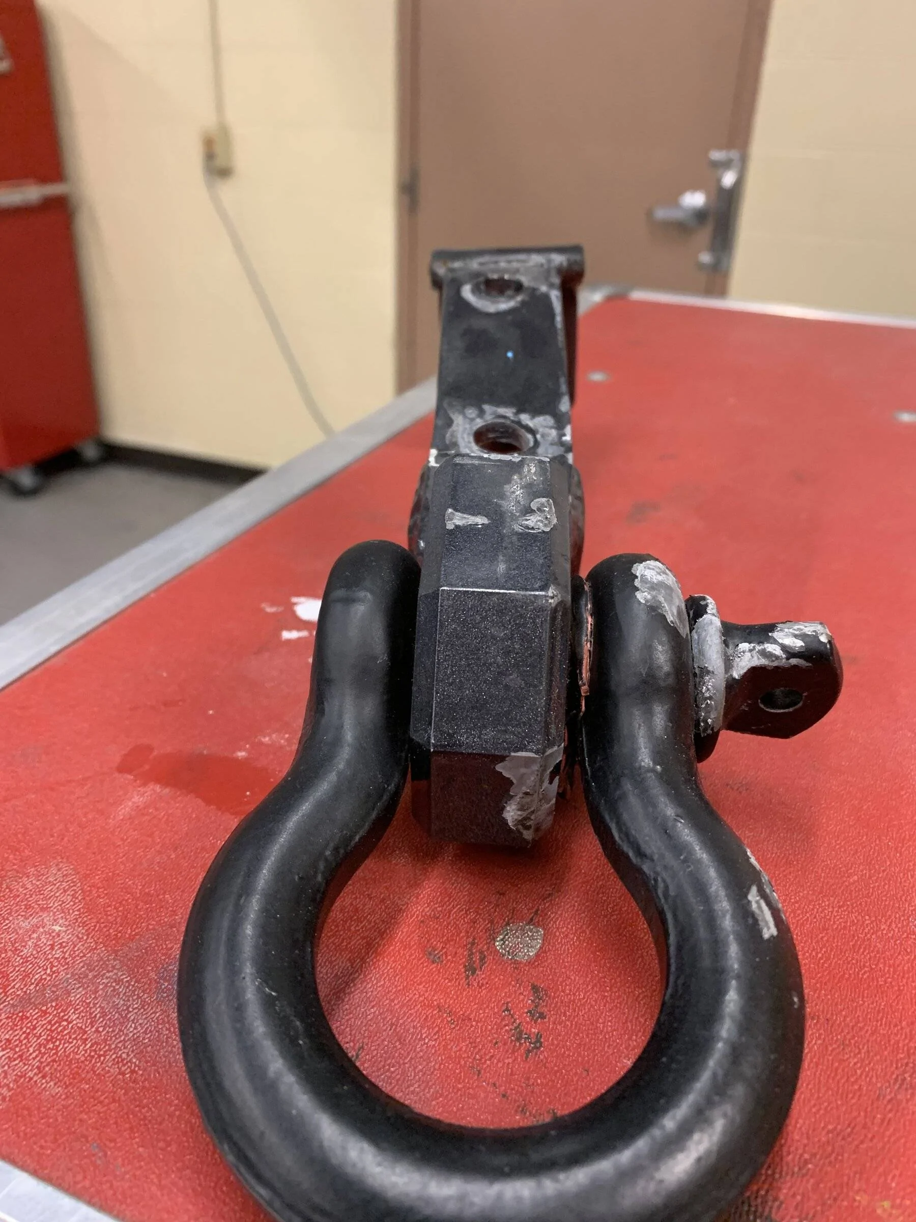

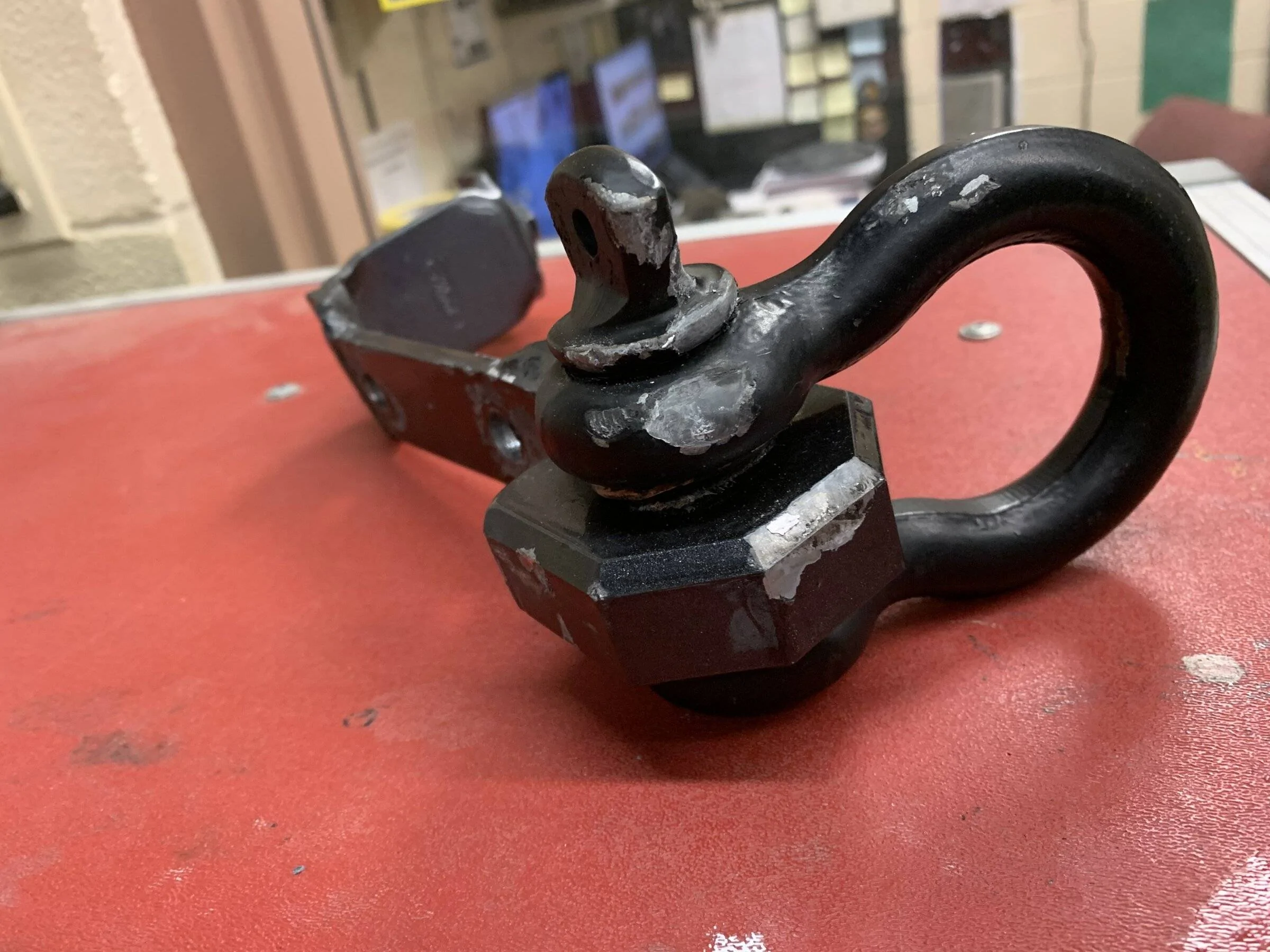

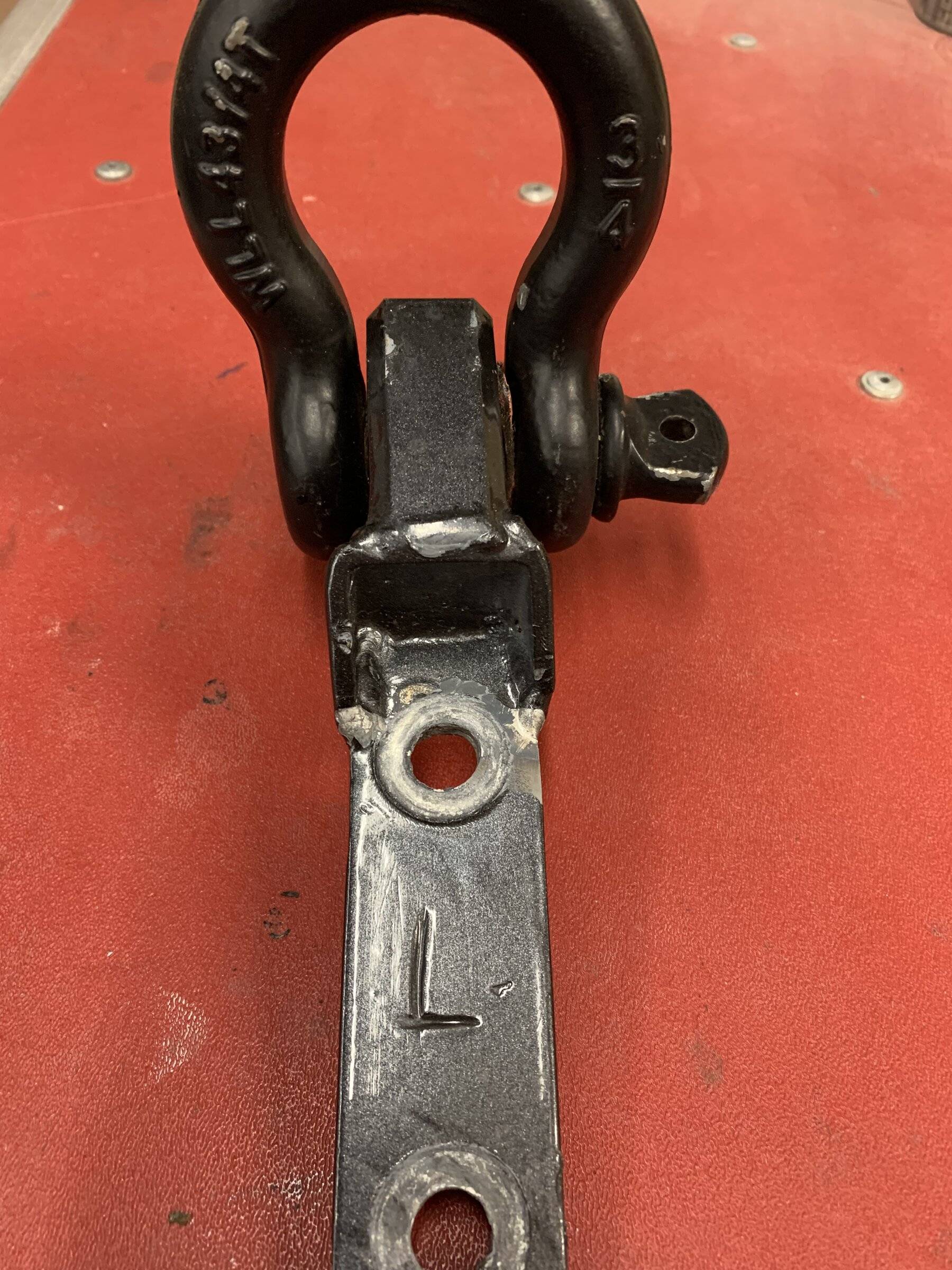

In another thread on here I showed where I made these. I utilized the factory skid plate mounts and welded these Amazon shackle blanks onto them. I believe this shackle mount was the very first part to come in contact with the other vehicle during the crash. Welds are just fine but you can see the bracket actually bent sideways. Little heat to straighten it up and it’ll be perfect again. Anyone out there afraid to do some welding don’t be, get yourself a good MIG welder, get a little training, and go for it.
When you heat metal like that to reshape it you will draw the temper out of it. By quenching it in water you get some of that hardness back.
