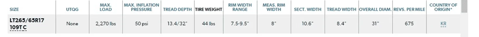

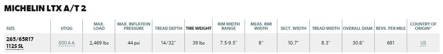

I just replaced my 265-65-17 Hankooks with 265-65-17 Michelins... and the diameters were different.
Can you explain this for me. It does not agree with what I have been told by several tire dealers.

It's simple. Even though they are classified as the same size different tires(both make and model) will be different between each other in diamiter and width by a little bit. If you go to Tire Rack and look up a tire size and look at all the tires available you will find in the specifications that they are a little different all together.

From the Discount Tire Website:
Hankook Dynapro ATM, The OEM tires that came on my Ranger
________________________________________________________________
The Michelin tires we recently had installed

Yes tires of the same size will vary in diameter between manufacturers. Usually only a few decimal points. Tires of the same size from the same manufacturer will also vary. For example look at Hankook,s DynaPro ATM. The LT265-65-17 version is 31", the P rated version is 30.6". They all will weigh different also, which also plays into driveline load.
