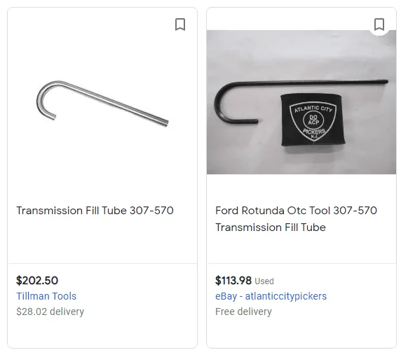

I have a little 12v electric pump and a tool that I made to suck it out. Ford actually has an 'official' 10R80 tool that is completely laughable. It is something like $100 and is a hook-shaped piece of tubing. I went to the local Home Depot, bought a metal toilet standpipe, filled it with sand (to keep the pipe from crimping) heated, and bent it.
As far as the amount of fluid? Umm, I don't remember off the top of my head, but somewhere in the 4-5 quart range? I don't recall filling up the gallon jug I had to catch the output of the pump, but my memory is foggy on that.
I did just stumble across this thing, which is the first I've seen it and it actually looks damn cool, and would eliminate the guesswork:
https://fordspecialtools.service-solutions.com/en-US/Pages/ItemDetail.aspx?itemID=122824
It is a Euro tool, but they're stating for the 10r80's. I'll have to look into it a little more, but it would be awesome for refilling and getting the level right. (watch the video to see how it works)
--Edit--
If you want to see the 'official' Ford tool and have a good laugh, the part number is 307-570, and it goes online from between $100-199. IT IS A BENT PIECE OF TUBING!!!! Whoever makes them is laughing all the way to the bank. I don't think even Sna-On could make something like it and justify that price.
