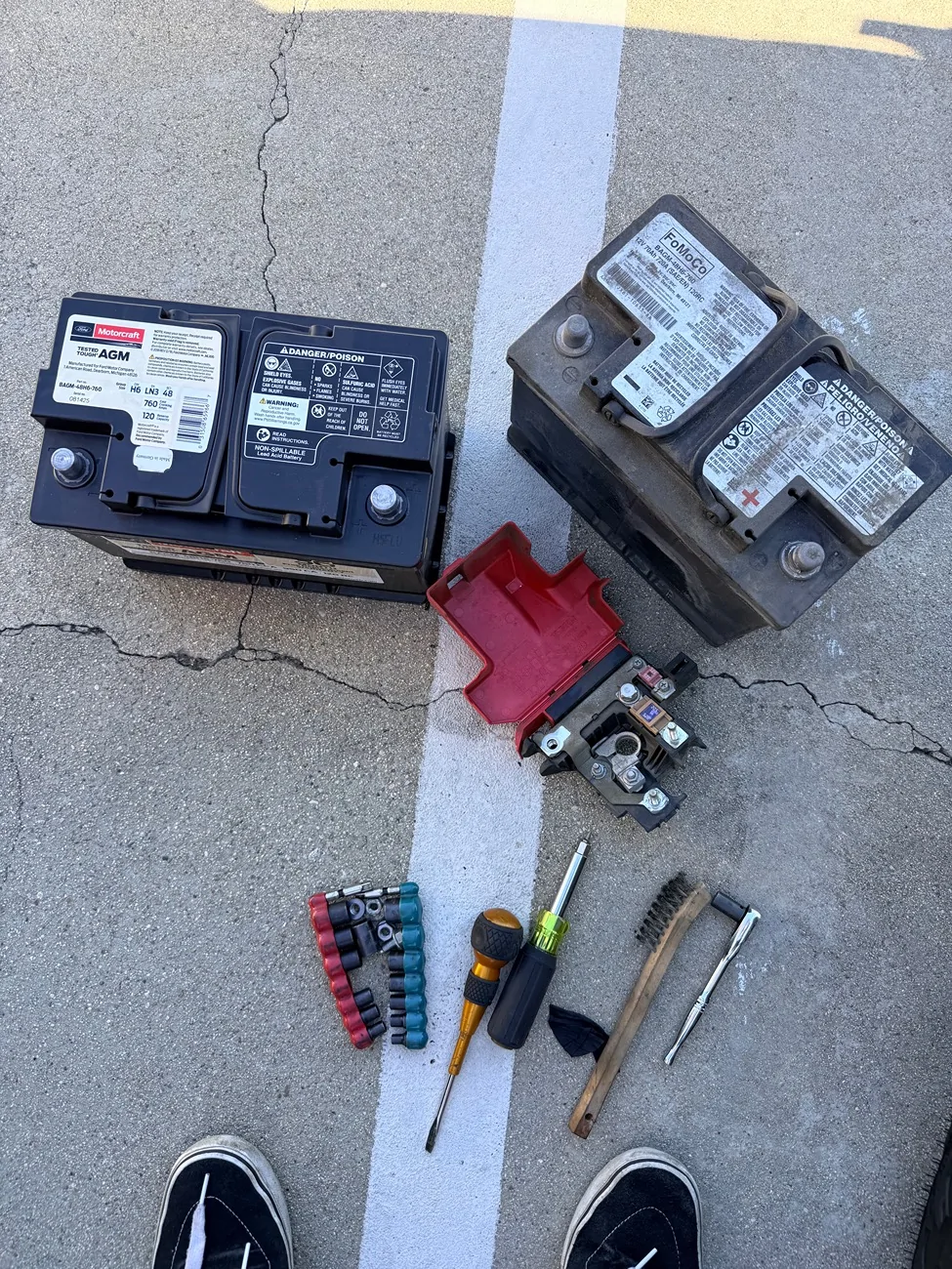

1,2 switcharoo. New battery from Ford in place. Surprised the new battery didn’t come with the fuses. 🤨
Ive never seen a battery come with fuses. It's not part of the battery. Are yours blown out?
I reused mine when I replaced the battery.

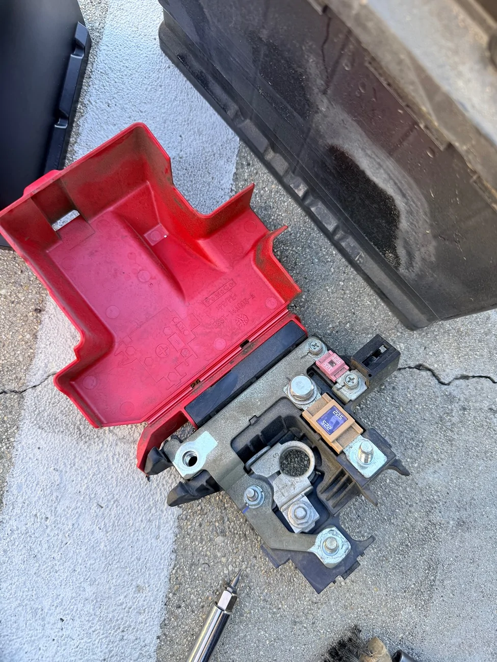

I started looking for that fuse online and I think he must have been referring to the entire circuit breaker assembly. Itā€˜s $289 CAD MSRP.
EDIT: Information from Benny at Levittown Ford added from another thread. The fuse is not available from Ford but the entire assemblies are…
Non Tremors use​
Tremors use​
Yes, for some reason - Ford does NOT have a separate part number in their system (USA) for the simple fuse and the only way to get the fuse from Ford is to get the complete BMFL Assembly.
At one point I found the Ford PN for the 225 Amp Fuse (ROW) but lost it (Grr), but the actual MFG number is the Flosser 8048225-part number.

Pretty sure that is a standard fuse you can buy online. I have one in my toolbox of a different amp. Probably from car audio.
I have seen them on AliExpress for $2.50 for a 200A or 250A I have not seen a 225A
If mine ever blows I will just stick a 10gage wire there...

No they weren’t blown out just figured the new battery had them mounted already.
No as it is part (an extension) of the battery cable to incorporate the (Fuse Links) into the wiring vs old school (Imbedded) into the wire. Now instead of trying to find the hidden fuse links, they are mounted on top of the battery and are now a physical fuse that functions as a fusible (slow blow)
fuse.

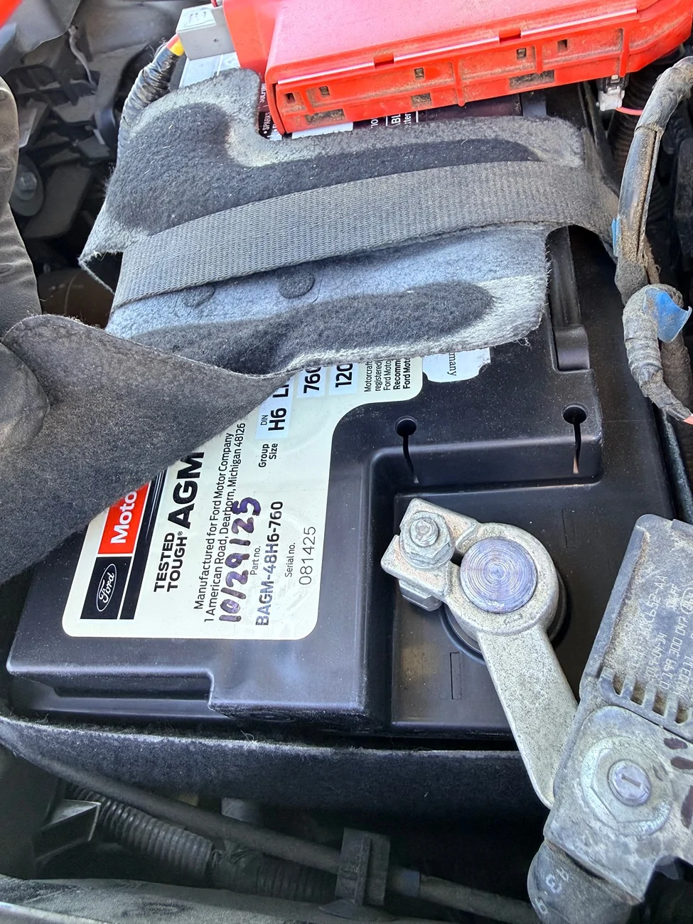

Is that an after-market battery blanket?
Mine has mouse holes and, if it's aftermarket, obviously I need one! =D
Even if yours didn’t have holes in it I’m guessing you’d still ā€œ need oneā€. šŸ¤£šŸ˜‚
FOMO isn't just Ford Motor ya know! =p
