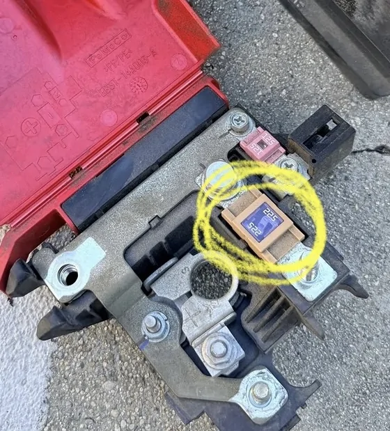

1,2 switcharoo. New battery from Ford in place. Surprised the new battery didn’t come with the fuses. 🤨
Fuses? Do you mean the ones in the positive terminal block?
If so, believe it or not, this one…
…costs almost as much as the battery. :oops:
EDIT: New information shows otherwise - see below.

Wow - that’s very interesting. When my battery died, I had roadside assistance take my truck to the dealer. The guy who showed up cooked the fuse when using his jump pack to get it running so he could back it off the property to get it onto his flatbed. He left the jump pack attached while he drove out the dirt lane and things got bounced around - It’s a bit rutted.
Anyway, the battery was replaced under warranty and the service advisor said the blown fuse was a costly $275 mistake but that the towing company was taking care of it. Since the battery was covered under warranty, I figured that was the cost of the fuse. šŸ¤·ā€ā™‚ļø

I had found this site a while ago and bookmarked it in case I needed the fuse.
8,802
42,033
Here
XLT
I started looking for that fuse online and I think he must have been referring to the entire circuit breaker assembly. Itā€˜s $289 CAD MSRP.
EDIT: Information from Benny at Levittown Ford added from another thread. The fuse is not available from Ford but the entire assemblies are…
