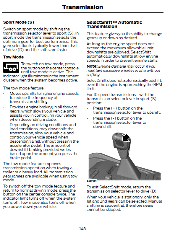

it does not reprogram shift patterns to match your driving style...
either i'm an idiot who cant read, or more misinformation needs to be corrected.
for shitzngiggles, heres everything from the manual so it can be read if desired.
comprehension of the data is also optional

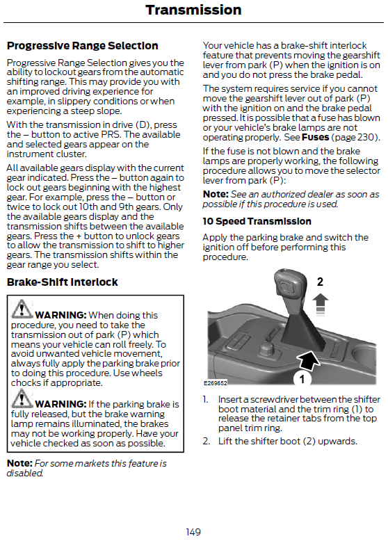

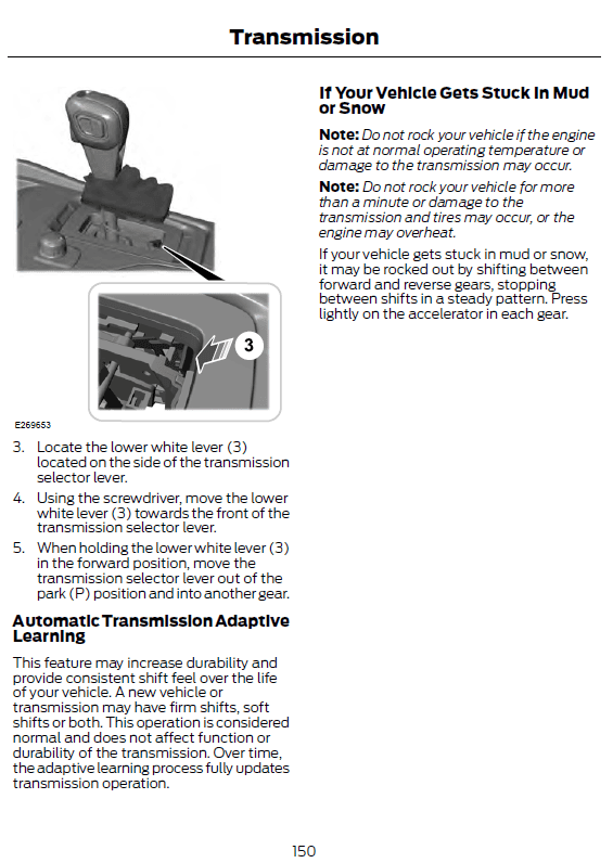

What does moving the white (3) lever forward do?

It's for when it won't come out of park with your foot on the brake, read the page before it helps explain it, hey, that's what I had to do, I thought the same thing, "what does the white lever do?'
lol...I read it 3 times and didn't get it...

I head scratched and thought "that should be all on one page"
