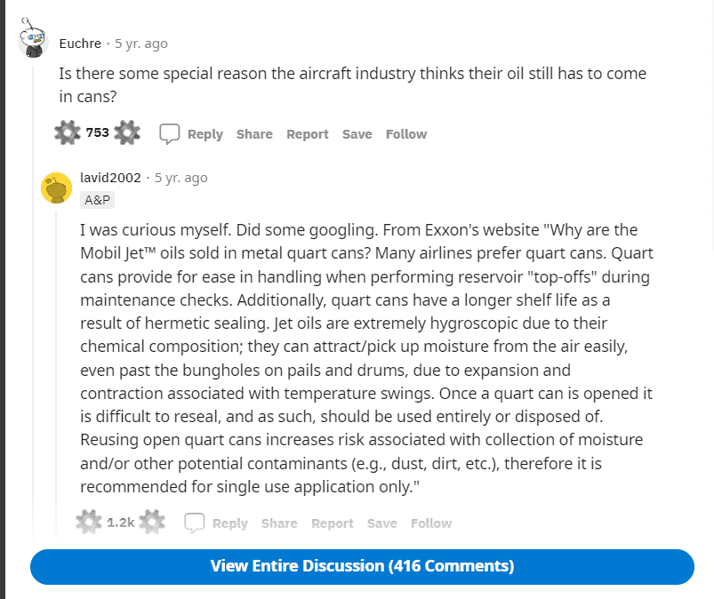

Talking about Oil - I've always wandered in my 30 years of Aircraft Maintenance as to why, aviation oil still comes in the old-school cans, and why it was never switched over to the plastic bottles like automotive oil did - the only thing I can come up with is the plastic locking ring-falling into the scupper or moisture protection (cans have better seal)-IDK. I've asked over the years, but nobody knows???
This comes up on Reddit and makes sense.
I didn't read the other 400+ comments so I don't know what else was added.

Cool-Thanks, yes if we use say 1/2 can-it either gets dumped into the service bowsers for (IDG's) or dumped into the used oil barrel if they are already topped off (unless you are working in the rain) then it goes straight to the used oil barrel.
