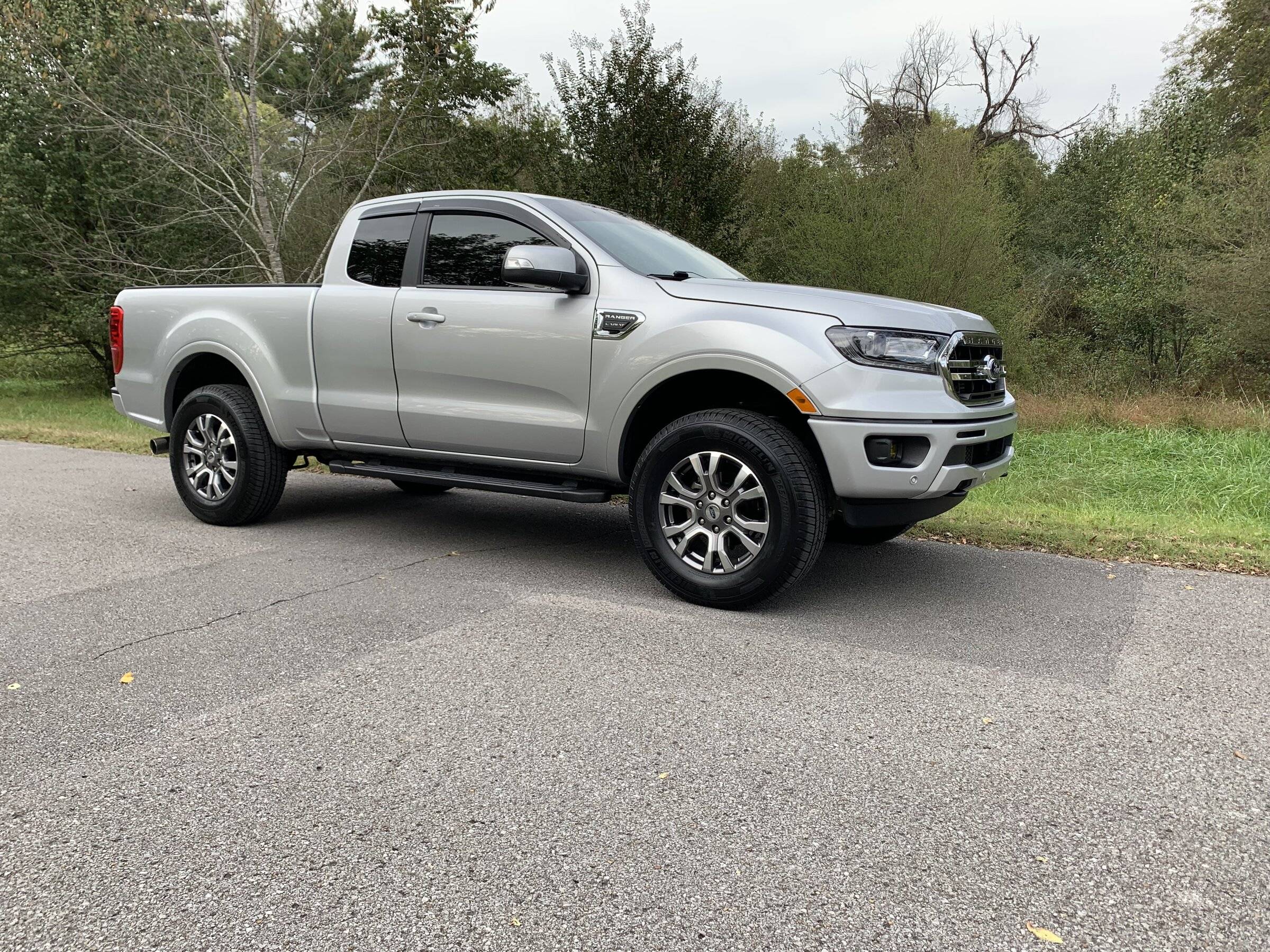

I used Eibach’s adjustable coil overs on the front to make it more level. I adjusted them to the same height as the rear, measured at the fender edge, which was lower than how Eibach had set them.
Mounted 265/70/18 tires and now have to step up into truck.

That looks great, and I see that you have the “boomer-approved” chrome trim, just like me. I like your wheels better than the PVD fake-chrome set on my garage shelf.

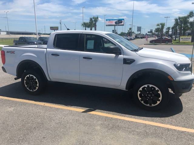

This is my STX SE 2WD with a level kit and stock tires. It was done by the dealer, so not really sure if it was 2 or 2.5", but probably just pucks on the front springs. Nothing added on the rear.
