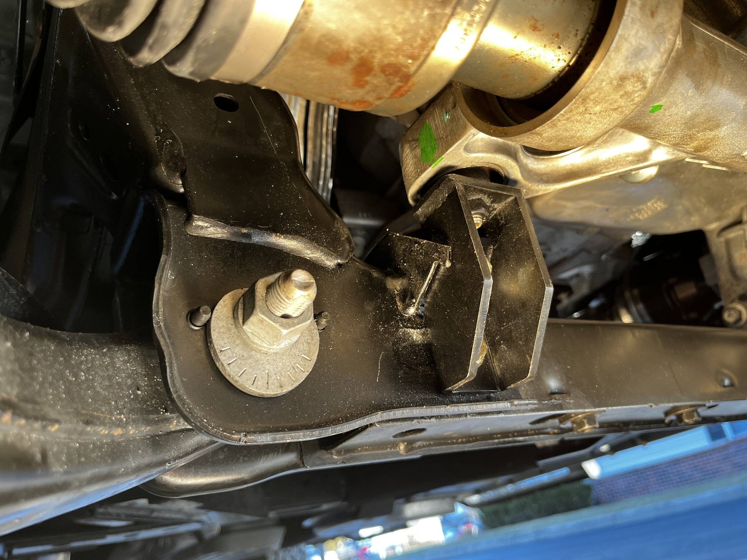

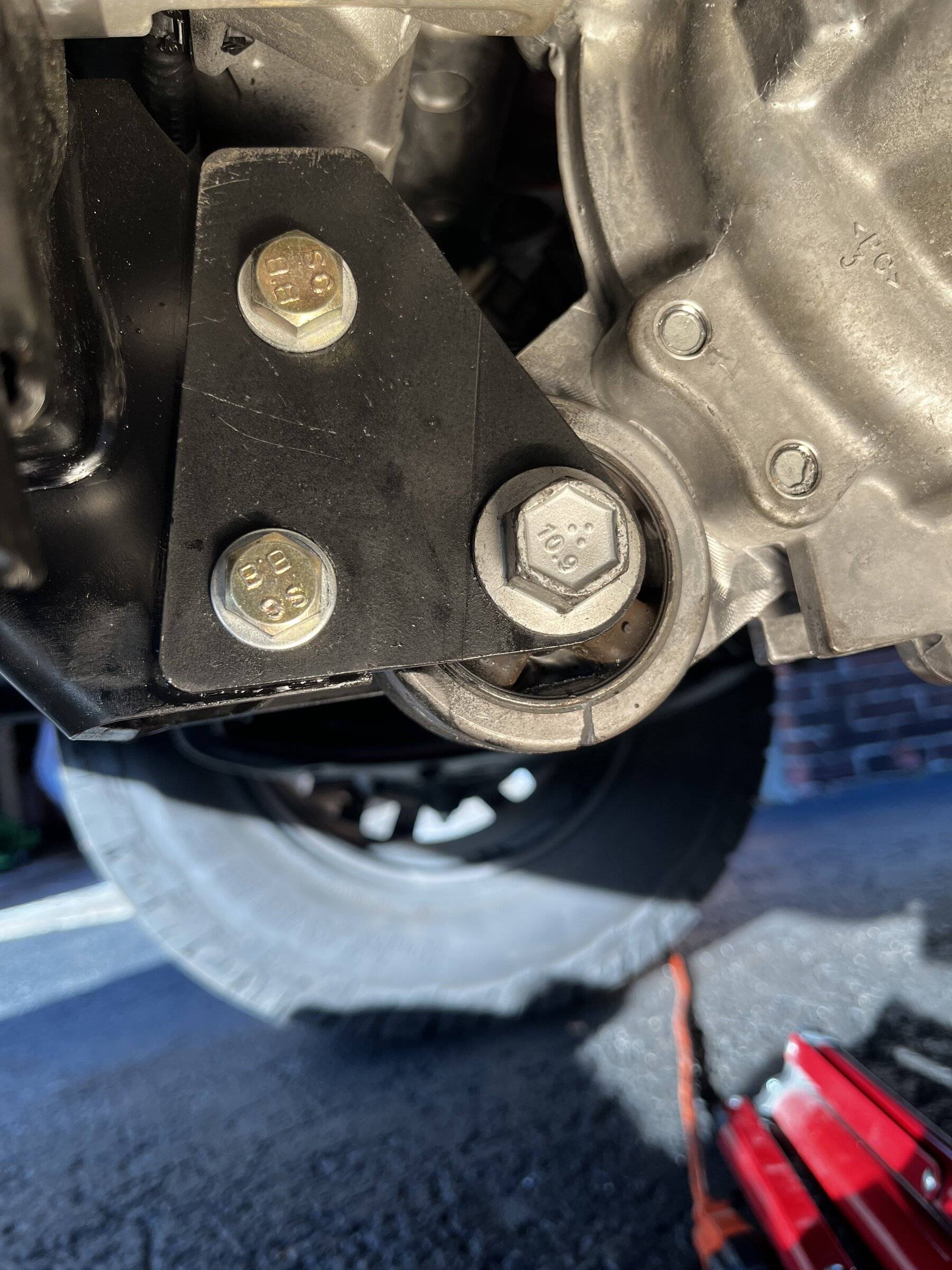

I have not seen a kit that lowers this. As far as i can tell you may be able to bolt it below the factory mount and drop it 1/2” or so.
The black mount has 2 bolts to the diff housing, you could make any length bracket between the two

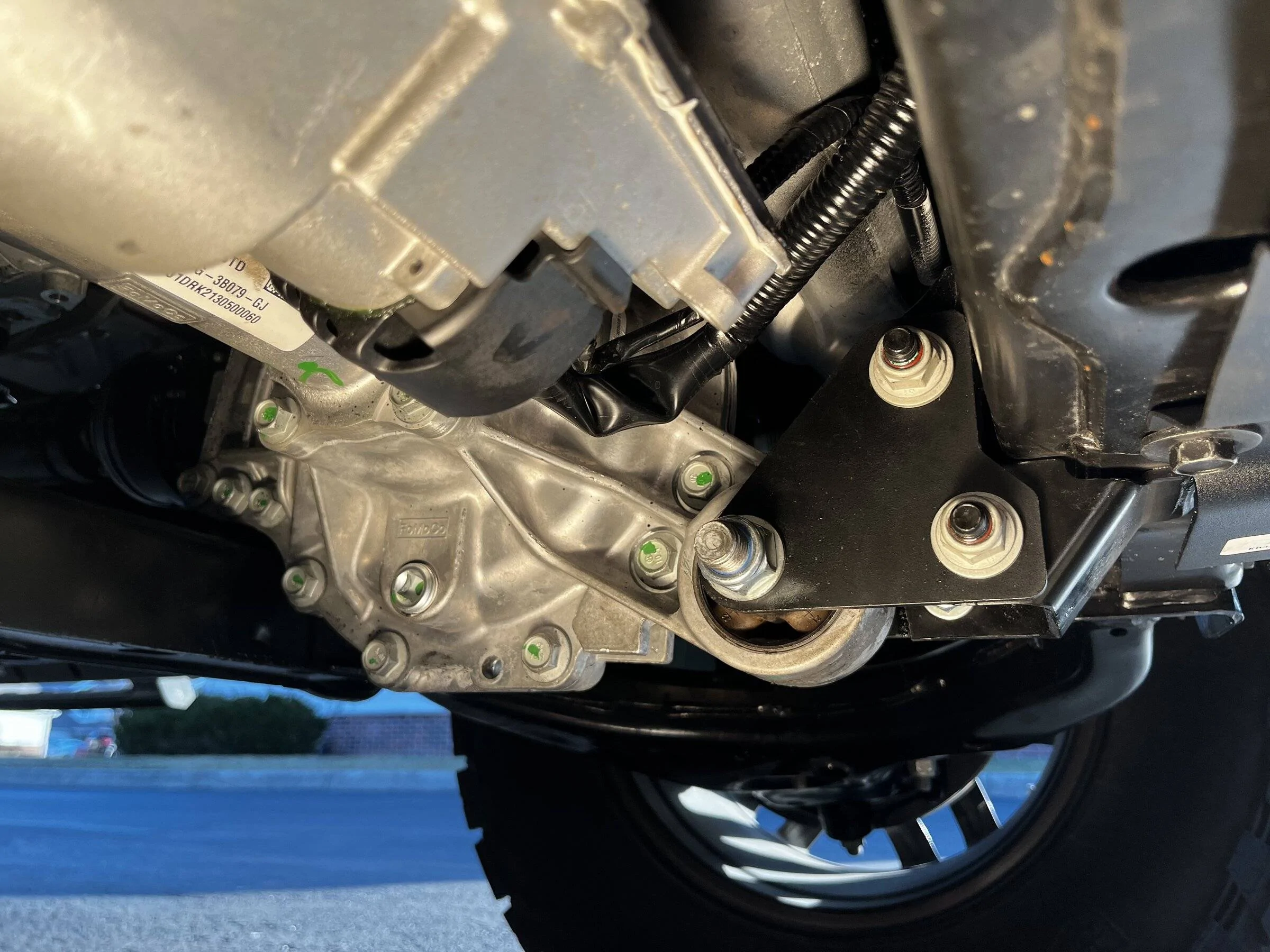

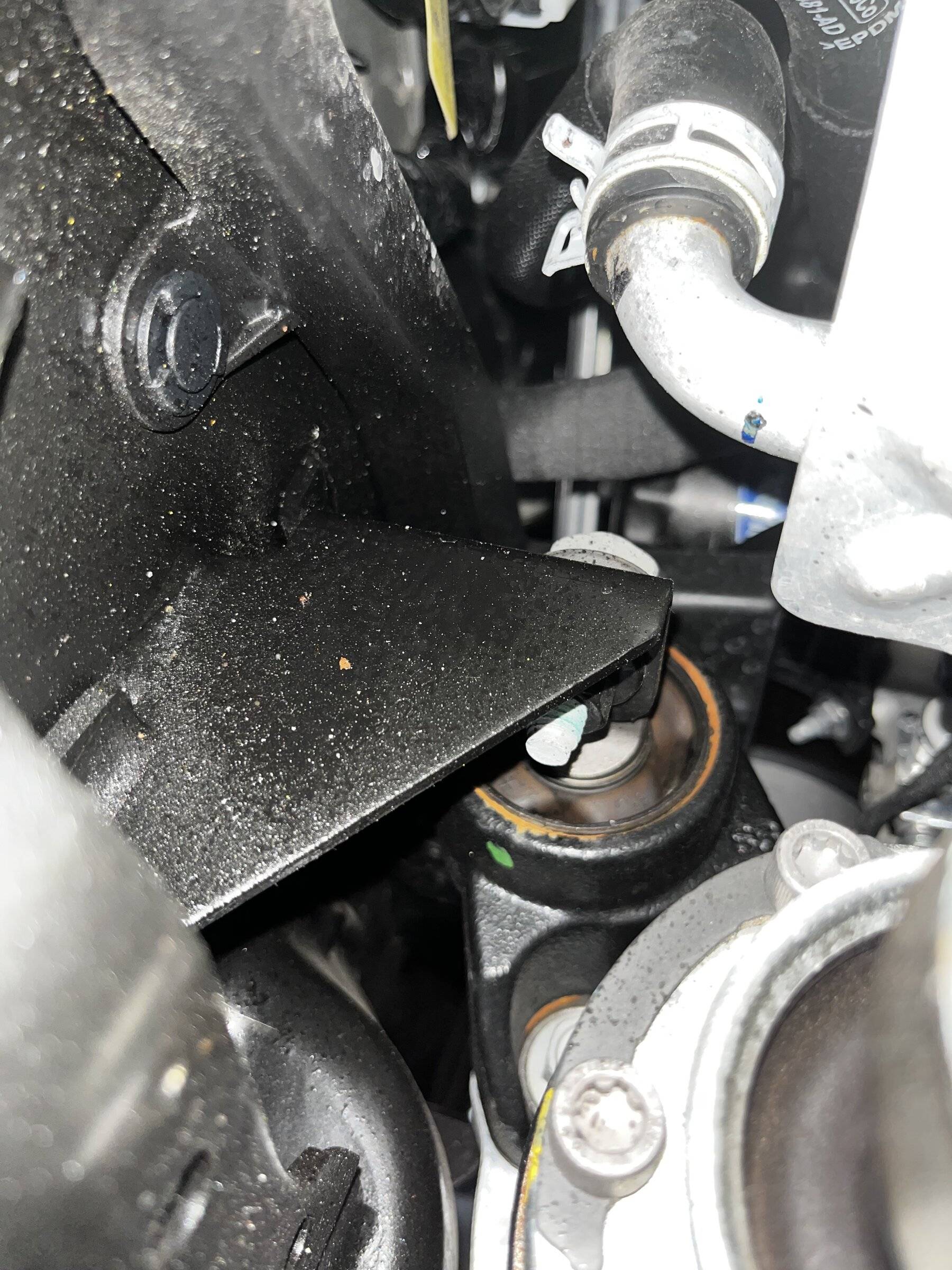

How do you like this kit? I'm at almost 4in of lift and I have a leaking Axle. Debatting getting a diff drop kit. This seemse like the most complete kit. How is the install?
install was super simple and I have had zero issues with it.
