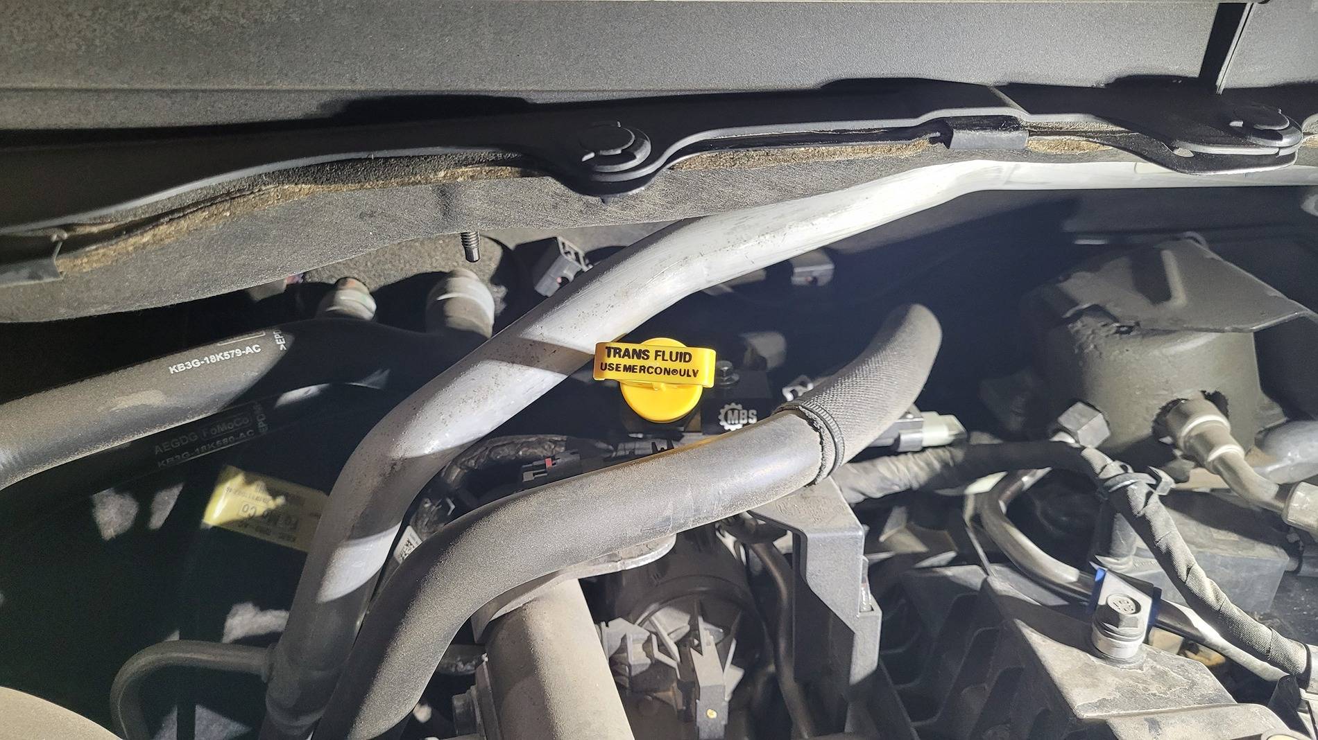

I just completed the Fitzstick install today. Took about 45 minutes. It took me about 15 minutes to figure out the best way to remove the plug. Contrary to what some assumed, it's aluminum, by the way. I used a flexible 3/8" ratchet and a 1-1/8" combo wrench as a cheater bar. Instead of bringing the handle down at a funky angle, I kept it close to the exhaust and slid the box end of the wrench over the ratchet handle. I had about 2" to work with and that was all I needed. It broke loose fairly easily.

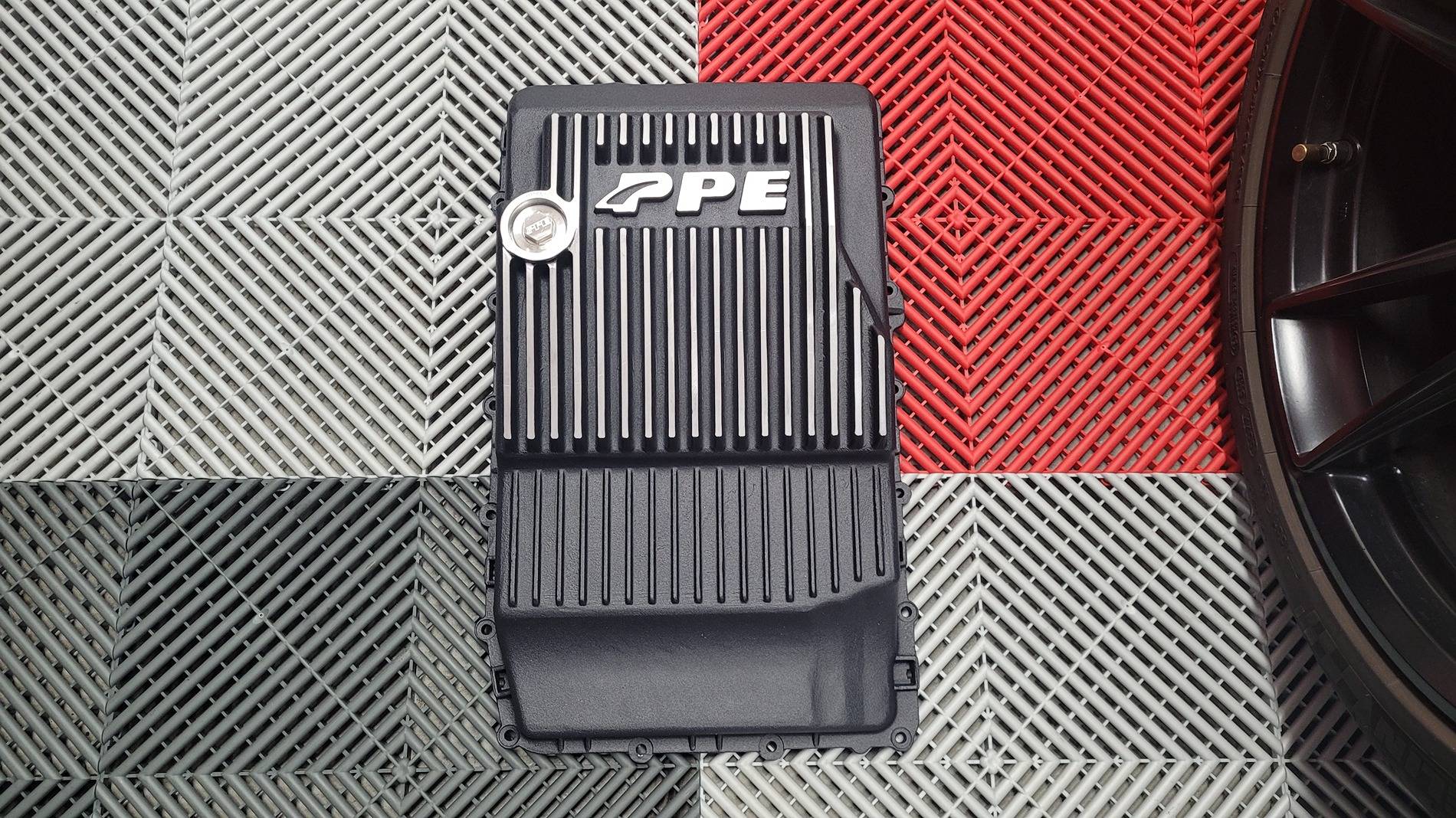

I just ordered my PPE pan and dipstick today! Felt brave after reading through some of the posts on here and am finally going to dive in. I'm at 55k miles on my 2022 Ranger and have yet to have any major transmission problems, other than the occasional (wth was that jerk) sensation. However, I keep vehicles for a LONG time and she's paid off and out of warranty, so I figured it was time to get that filter and pan changed out...and add the dipstick while I'm at it. Did you go wit the 'deep' or 'shallow' pan?

I went with the deep pan since I found it slightly cheaper than the standard depth. I have the same mileage on my 2020 and am making the upgrade for the same reasons.

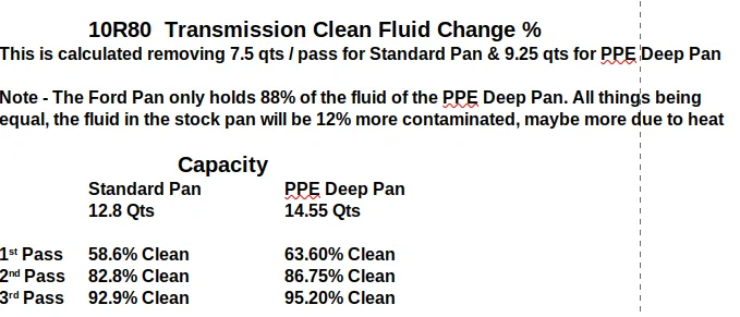

I've been busy again while offline, crunching a few numbers to assist those who change their transmission fluids using the MBS dipstick. Put the numbers in a spreadsheet for clarity's sake.
When you change your fluid yourself, there is a very good reason to change it multiple times in a short time frame, and it is all about getting to a +90% new fluid mix.
I have changed my fluid numerous times (and some of y'all think I 'm crazy :crazy: ).
Here is why I do it. Lot of folks only get 5 qts out.... not good enough.... I wait 2-3 days (3 days really, with truck parked on level ground where I'm going to do the procedure), and routinely pull 7.5 qts out.
With only one change of 7.5 qts, you are leaving ~42% of the dirty fluid in the transmission. And that is if you have a standard ford pan. A 2nd change will get you to ~83%, but I go for 3 changes to get me well over 90% new fluid. Sure it costs more, but it is a LOT less than a new transmission.
BTW, 3 changes takes about 22.5 qts for the standard pan and 27.75 qts for the PPE deep pan. I add a bottle of LubeGard Platinum at each change too. I spaced the 3 changes out at 1K mile intervals. I can change the fluid and refill the transmission in about 45 minutes. Raise the hood, insert tube and let the transfer pump do its job. Never spill a drop going in or coming out. I know exactly where the fill level is for a cold start accurate fill. I put in exactly what I take out, then check the level with my Fitzstick. Here is how I do it

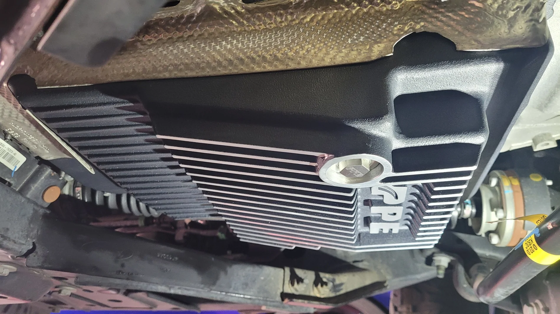

It's done! The new deep pan is installed. I'm posting this again since I was one of the lucky ones who had their posts deleted on the 24th with the server upgrade. :crazy:
I pulled 4 quarts last Tuesday night through the dipstick. The next morning, I pulled 2 more. On Thursday morning, I pulled the remainder of fluid and then dropped the OE pan along with the old filter. After draining the filter and adding up the contents, I came to a total of 8.75 quarts. I was fairly happy with that.
I had underestimated how many quarts of Mercon ULV I would need when I purchased 8 through RockAuto. This was because I hadn't thought about waiting a couple of days for more fluid to drain. As a result, I had to run to Napa to pick up 3 quarts of Valvoline ULV. I wasn't going to pay $17 a quart for Mercon ULV in my area. In total, I used 10.3 quarts of fluid plus the LubeGard Platinum.

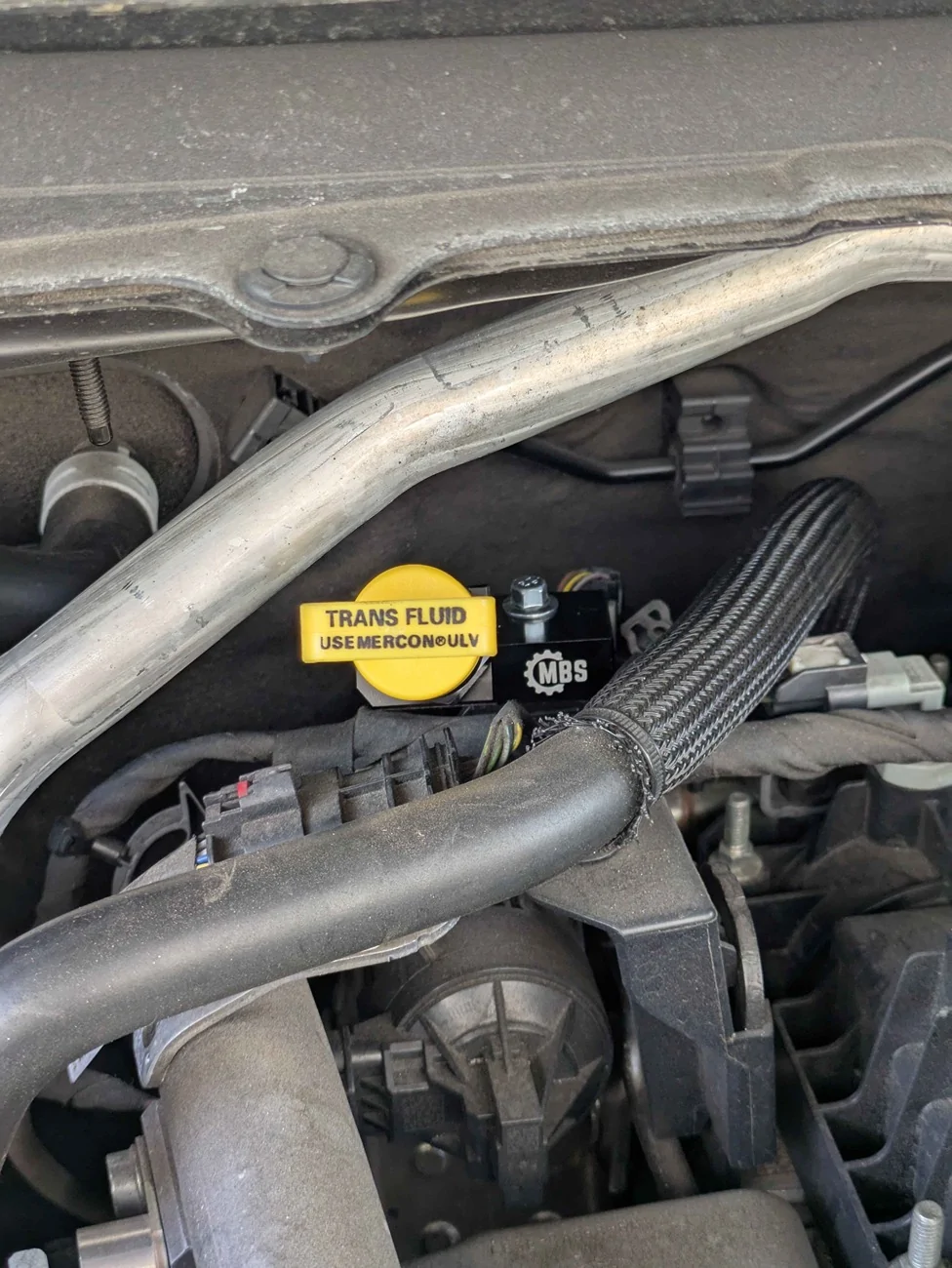

Installed the dipstick today! Went pretty well, other than the FL heat and me likely pulling a pec trying to get the bolt off of the top of transmission loose. I ended up turning the wheels to the left as far as I could and sliding into the wheel well with my back against the wheel and just going at it that way with a 19mm ratcheting wrench. Once that was done, the rest was pretty easy.
Many thanks to Mike for answering some of my questions via email while the 5g site was down for maintenance. Next step is finally installing the PPE pan that is sitting in my garage.
