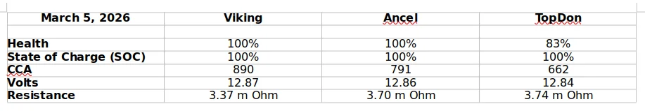

Tested my battery after resetting the BMS over a month ago. I'm still on my original battery, but for the first 20 months I let the Ford default BMS manage the battery. And it was getting very weak. So I began researching the BMS and with the help of several members of this forum, I've fine tuned the system from my unique needs. The last piece ot the puzzle is finally clear to me. I live by the 80/20 rule, achieve 80% of the objective for 20% of cost. To acheve the last 20% takes for 80% of teh effort/cost.. So i aim for that 80% threshold and believe that I achieved that goal.
I now own 3 different Battery Testers. And have used all 3 to test my battery's health. My battery is now as healthy as it can be, and it is at least 6 years old now.
The last nut to crack was the BMS SOC setting drifting lower over time. AirlineTech covered the issue very well earlier in this discussion.
The SOC level drifted lower over time without the BMS parameters being changed.
I personally observed the BMS lower the SOC threshold from 100% (the setting I changed using Forscan) to 84%. The charging system actually stopped charging the battery when it hit 84% SOC. I observed this happen in real time monitoring over several weeks.
So I reset the BMS over a month ago, then recharged / desulfated the battery. The table below shows the result. The test was performed 48 hours after the charge cycle, and 24 hours after starting and moving the truck to a different garage. The nbattery had plenty of time to settle.
The Viking and Ancel testers operated without issue. The TopDon has proven to be picky, erroring on me several time before I finally get a testing screen. I think it may be related to the corrosion coating on the battery terminal. This would also affect the Internal Resistance reading being higher. Iended up having to use the negative terminal stub before the BMS sensor. The other 2 testers measurements were taken directly on the Negative terminal.
The good news is that the SOC has stayed at 100%. If it starts to drift, I'll reset the BMS again when it breaches the 90% SOC threshold.
I believe I now have enough knowledge to keep my Ranger battery healthy enough to be comparable to that of my other autos.
