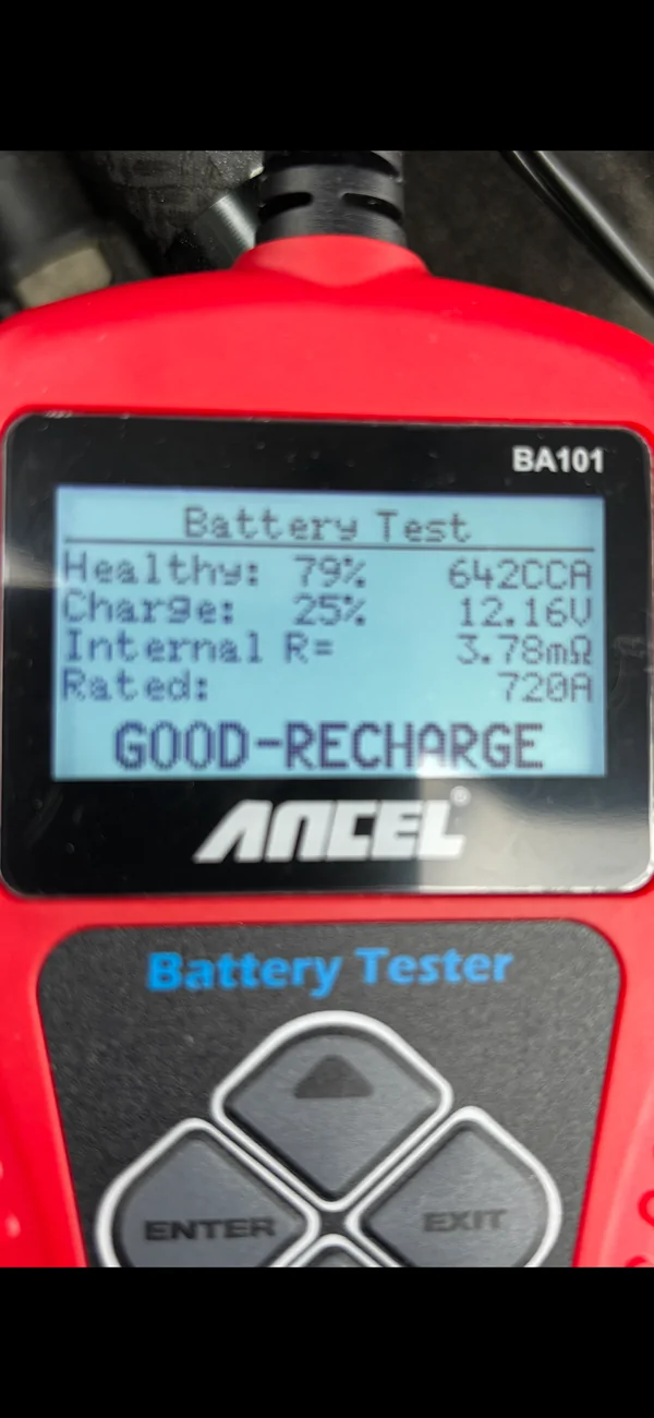

So after reading threw these 53 pages the last couple days and a few advel. I decided to get a meter and a de charger from Norco..
so my truck sat for 3 days and here’s my meter reading this morning (18* here this morning) now I upped the SOC to, can’t remember to what I did (can find my notes) so this may have something to do with its condition..what do you guys think?
It looks like you tested the battery with the vehicle drawing current like it would be after opening the door and popping the hood. Let it sit awhile and go back to close to a sleeping mode after popping the hood to get a true battery reading. I doubt it's actually sitting at a 25% charge.

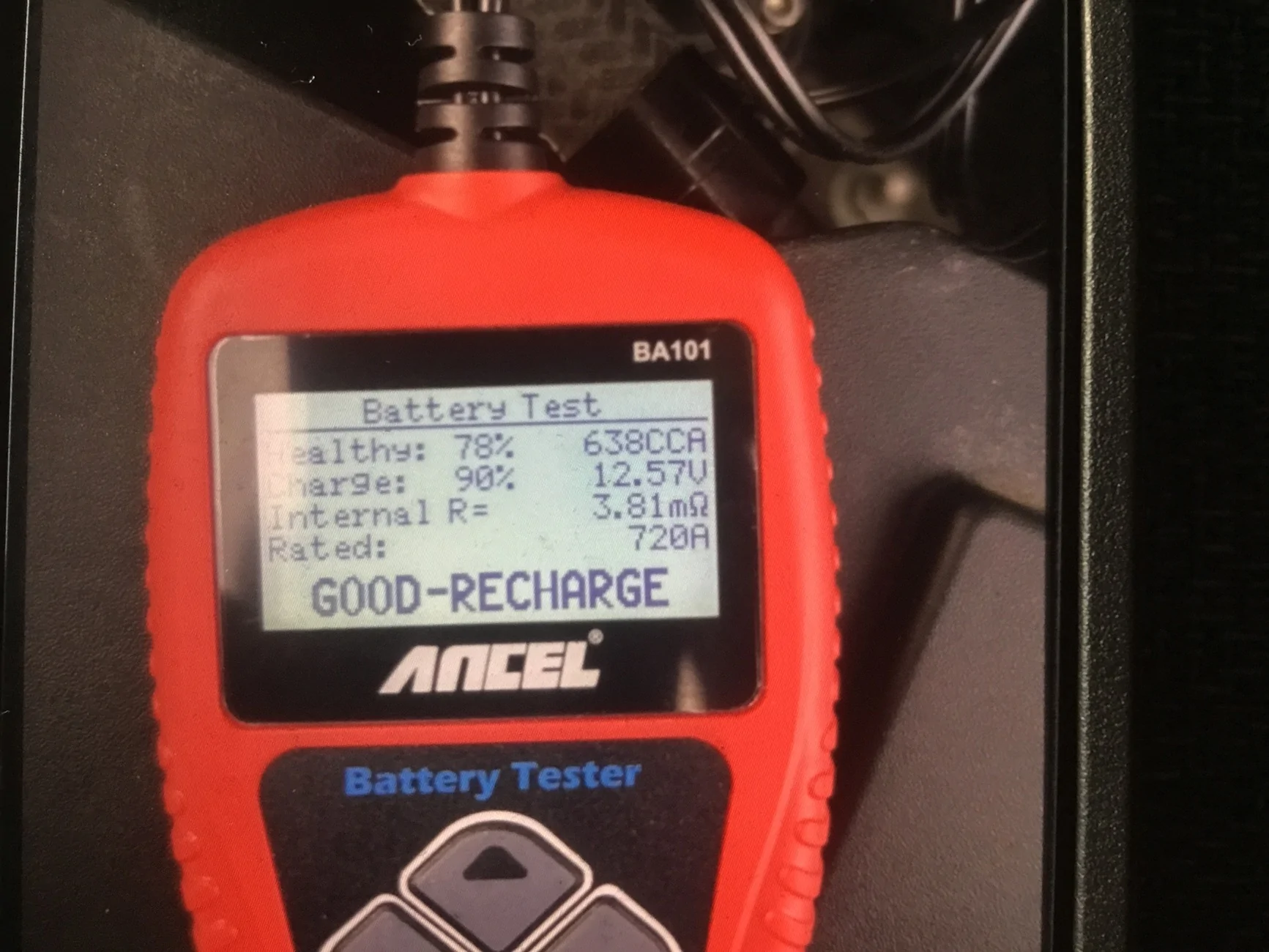

Ok so I did the test again and much different result. I opened the hood and let it sit for am hr then did the test.

Optimally you want to see >12.6v on a newly charged battery. If you truck is in extreme cold the battery will show weaker than in optimal conditions. IR is creeping up at 3.78 mOhms. Was your truck garaged or out in the 18F weather?

That's a more realistic result. Your truck will draw a lot of current and show a lower voltage when you first open the door, pull the hood latch and open the hood, letting it sit for a while so most of those systems can go back to sleep gives you a more real SOC reading. Airline Tech and TJC have done a lot of work on this subject, read most of their posts, and you'll get a better understanding of what's going on.
