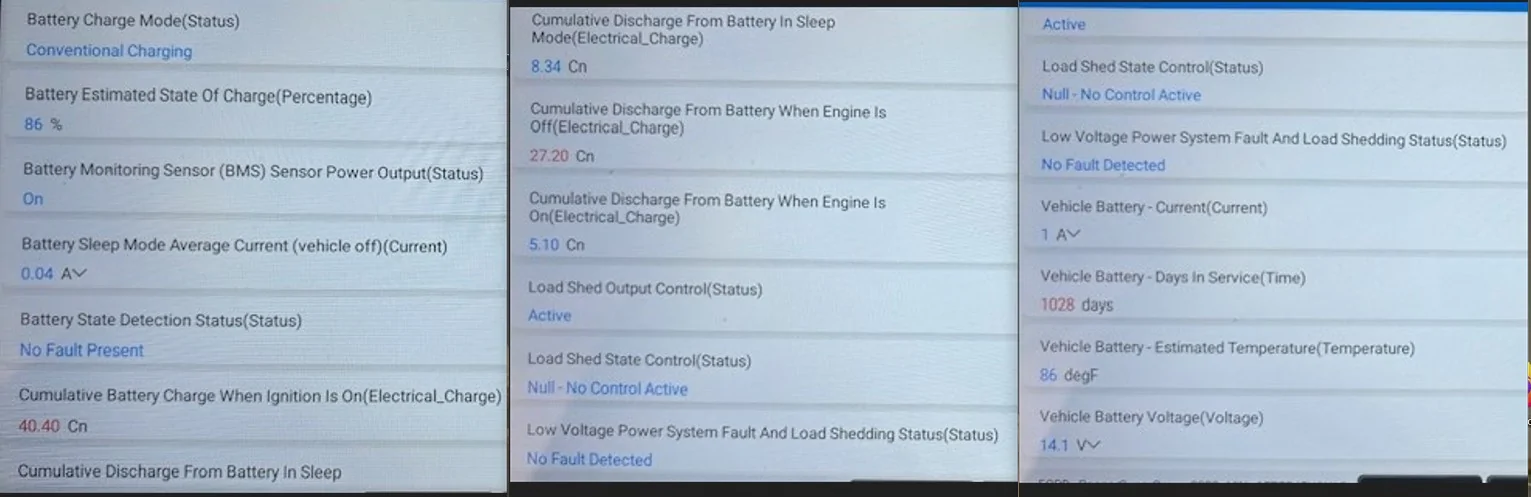

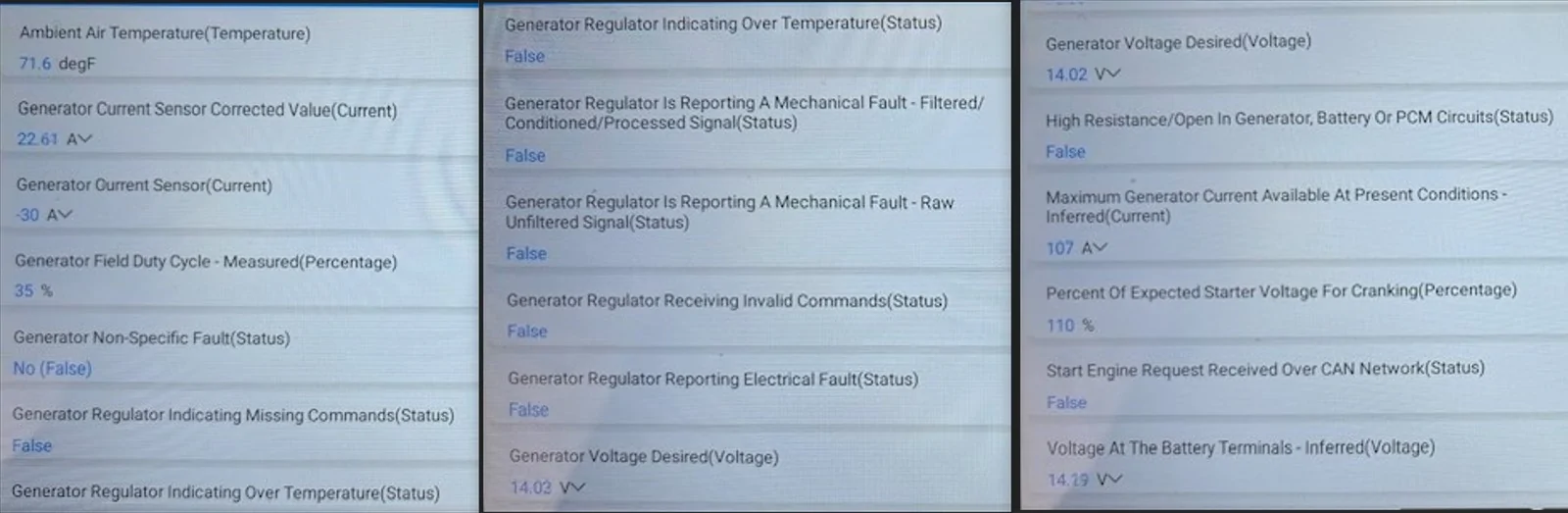

FYI - I pulled all related PIDs for Battery & Charging except the ones related to - ASS & Remoted start (disabled due to) PIDs
I included the Amb Temp for ref to the Estimated Batt Temp - (Fat Fingered the Start Eng Request)
TJC
Aug 28, 2020
47
4,097
10,417
Cool Beans! Was the engine running when you pulled the data? I'm assuming yes.
Remind me again. What is your target SOC set to? 85% IIRC.
Never try charging your truck with the key on with engine off, or immediately after shutting down the engine. You need a BIG charger to make up the amperage draw.
Yes - Engine Running - I actually just bumped the SOC from 90 to 95, no abnormalizes noted - I finally decided I needed to go through the list and pull out all that are charging related for a ref.
I cannot locate an actual SOC and only see Estimated SOC as far as PID Data.
